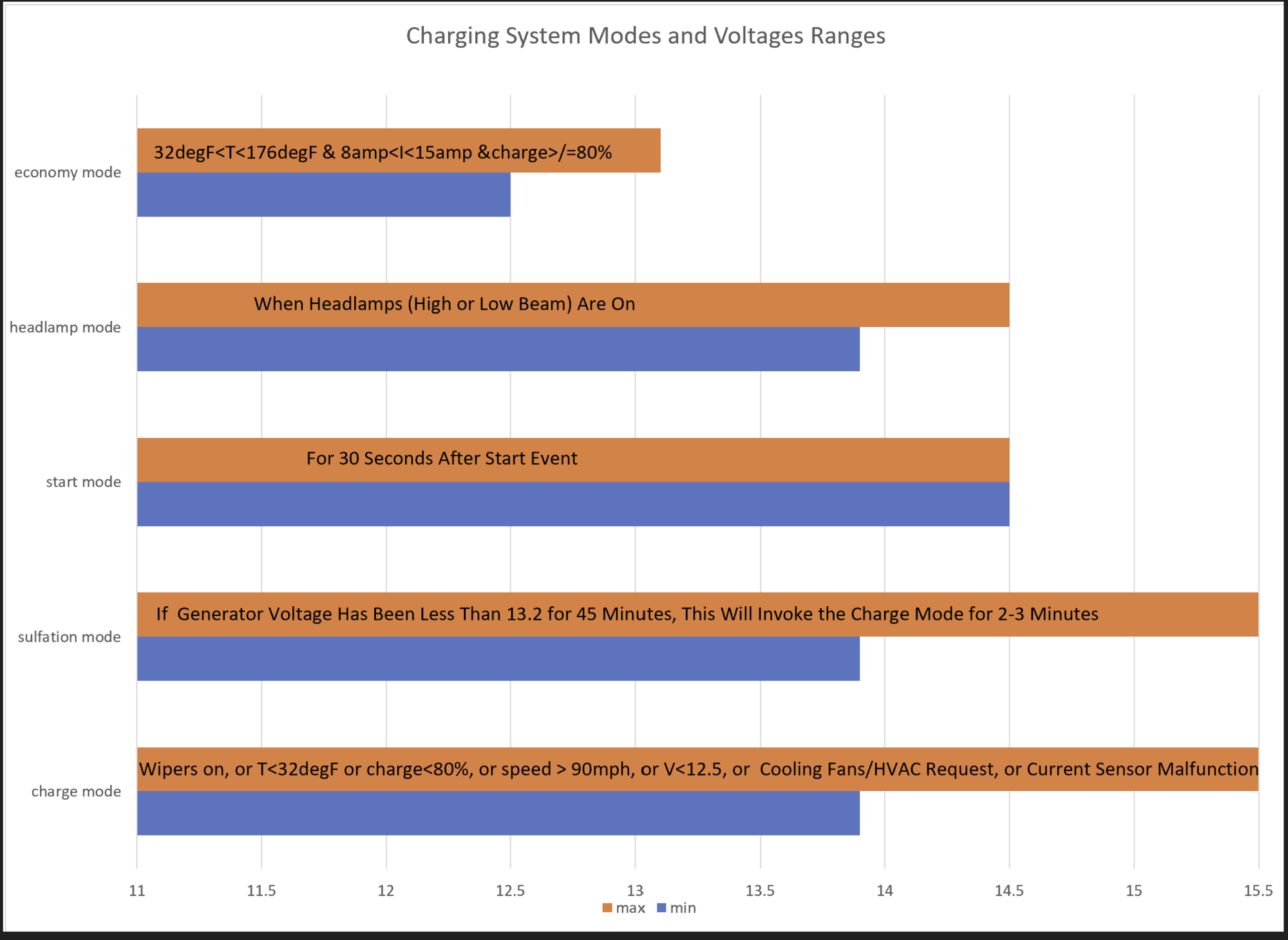

Normal on modern GM vehicles. The voltage is regulated based on battery state and electrical demand. This puts less load on your engine thereby saving gas.

Normal. A while back I reviewed the Service Manual description of the charging modes. There are 5 different charging modes depending on various conditions. Each will have a different range of generator output voltages. Those generator output voltages are what you will be reading when the car is running. I made a graphic illustrations of the voltage ranges for each mode that you may find interesting.
