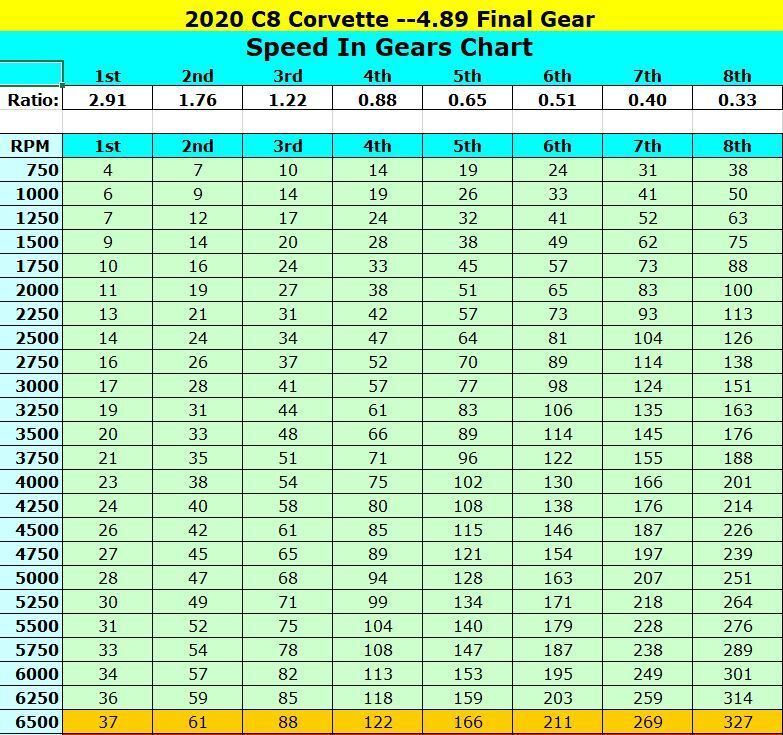

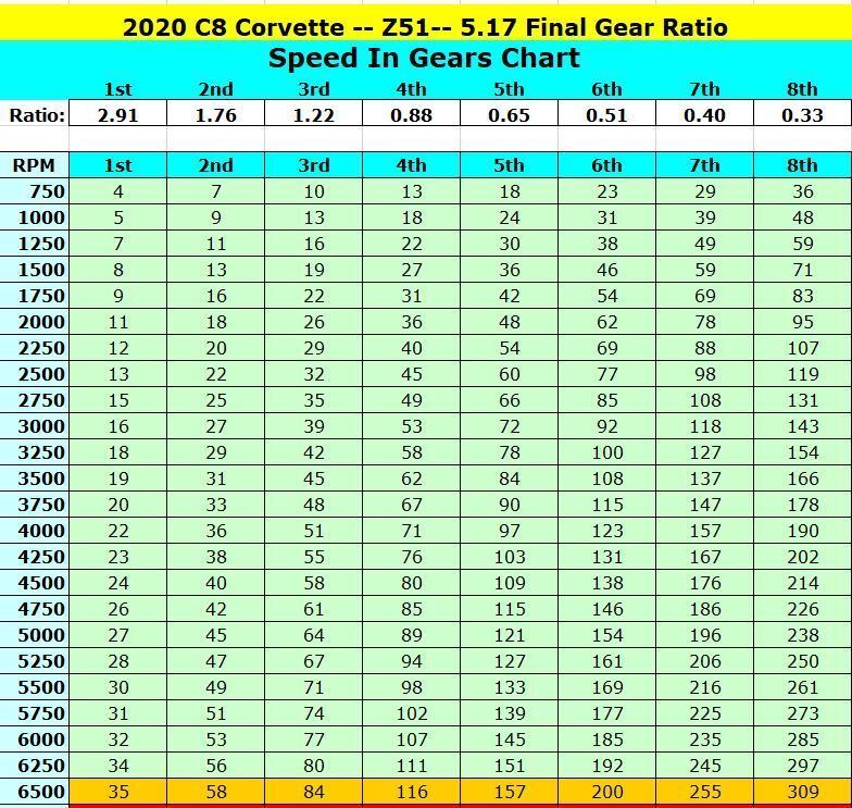

I have no comment on the ease or desirability of changing the gear ratios. However, here is some speed vs RPM for the various gear selections - and for the two different final drive ratios (Z and non-Z). You can use it to think about how a change in gear rations or final drive ratio would affect the behavior. You may find that if you don't like gears 5-8 just dont use them.

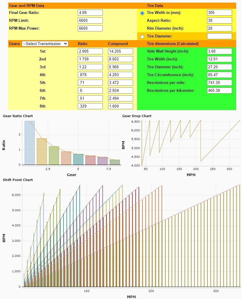

You'd need someone to make the updated gear set and you'd need to be able to tune the ECM to account for the different gearing. The ability to tune the ECM is the big issue right now as I believe Trifecta is the only one who's figured out how and they have not release this for general public tuning. If we ever get general availability for tuning (i.e. HPTuners or similar), then you might see someone make an updated gear set. Personally, I think this would be a great option, and I'd definitely be interested. Making even just 5th & 6th closer/shorter ratio would provide a noticeable difference while still giving 7th & 8th for highway cruising. For those that want it even more aggressive, do a shorter 5th, 6th & 7th, and only use 8th for cruising. It'd leave a fairly big rev drop between 7th & 8th, but this wouldn't be a big issue for highway cruising. Something like:
5th: .71
6th: .6
7th: .51
8th: .329 (stock)
would give a much closer spread and optimize 7th to be able to run out to 215MPH at 6600. Not sure that the car could pull all the way there, but for modified cars (i.e. blower/turbo), it would give them great gearing for the standing mile to try and do 200. Doing these ratios would give you this:
I think this would really wake the car up at higher speeds and would probably raise the effective top speed of the car. But again, until someone can tune the ECM to handle revised ratios, I doubt we'll see anyone interested in making such gear set.

Likes: 142
From: Thornton, Colorado
Is that a program available online or something you created?
Very nice.
Very nice.
https://www.gtsparkplugs.com/GearCalc.html
A super useful tool, lets you play with transmission ratios, final drive ratio, tire size, and rpm.
