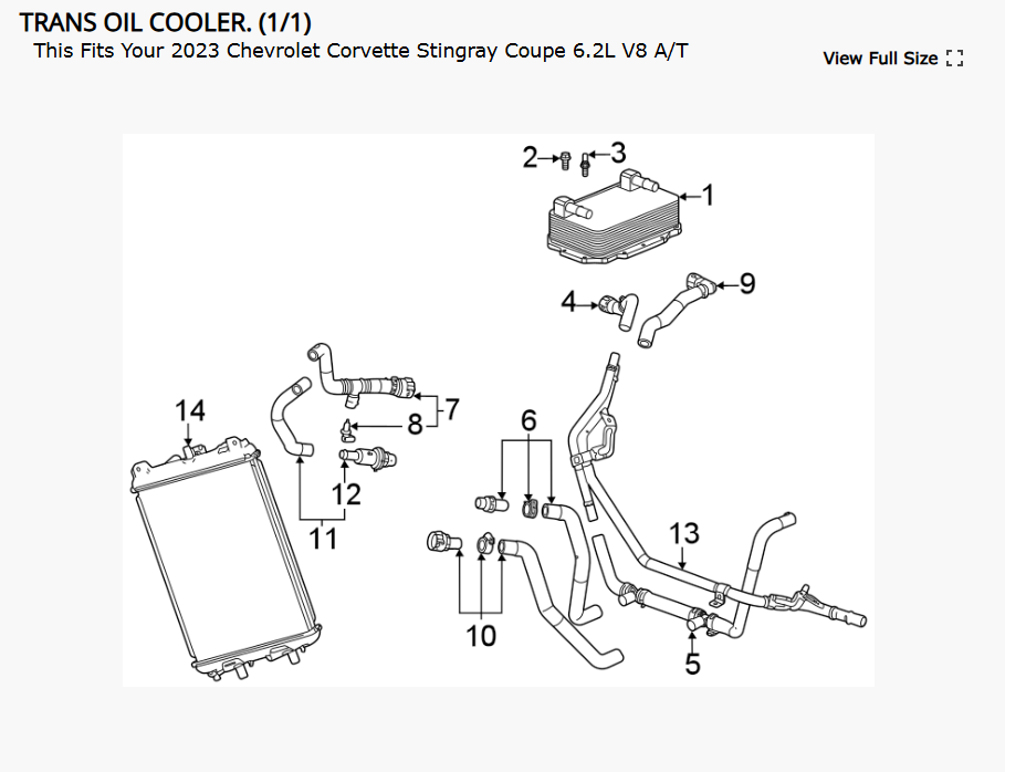

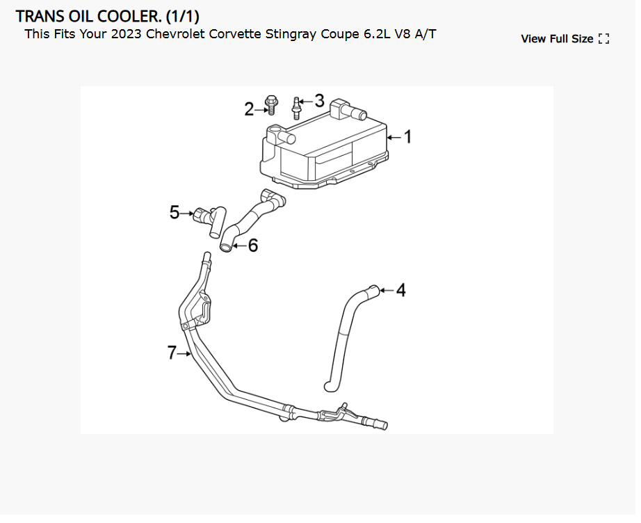

in the Base car the line from the water pump ( which is on the front part of the engine ) is not plumbed to accept the third radiator. Unfortunately, it is a hard line. In order to swap it out it would require removing the AC condenser which isn’t something I wanted to do.
So what I’ve ultimately settled on is that I’m going to plumb in the z51 aux radiator directly to the DCT cooler lines and just remove the thermostat so that it runs wide open all the time.
that being said I don’t street drive this car at all other than to the gas pump sometimes from the track.
additionally while I’m doing this I’m also going to source some more high performance radiators for the front of the car.
I overheated the trans twice today after about 20 minutes on a 80 degree day.
If there is no traffic and I have clear track it’s fine. But if I hit traffic for even a 1/4 lap the temps climb fast
I wanted to ask about this. I looked at the parts diagrams for both the base and the Z51 with the right-side transmission cooler. It looks as if the main hard line from the base car is replaced with one with a couple of T's in it that go to the radiator. @allblackeverything I'm curious about your comment that the water Pump isn't plumbed for the 3rd radiator and the condenser needs to be removed. Can you expand a bit on it?? It seems that the Z51 hard pipe would just replace the base car pipe but maybe not.
In looking at the parts diagram for the Z51 setup, once the thermostat opens, it allows coolant to flow into the radiator. Would it be fair to say that not all of the coolant flows through the radiator as the original fluid path is still open? Would it be more a 50/50 split?

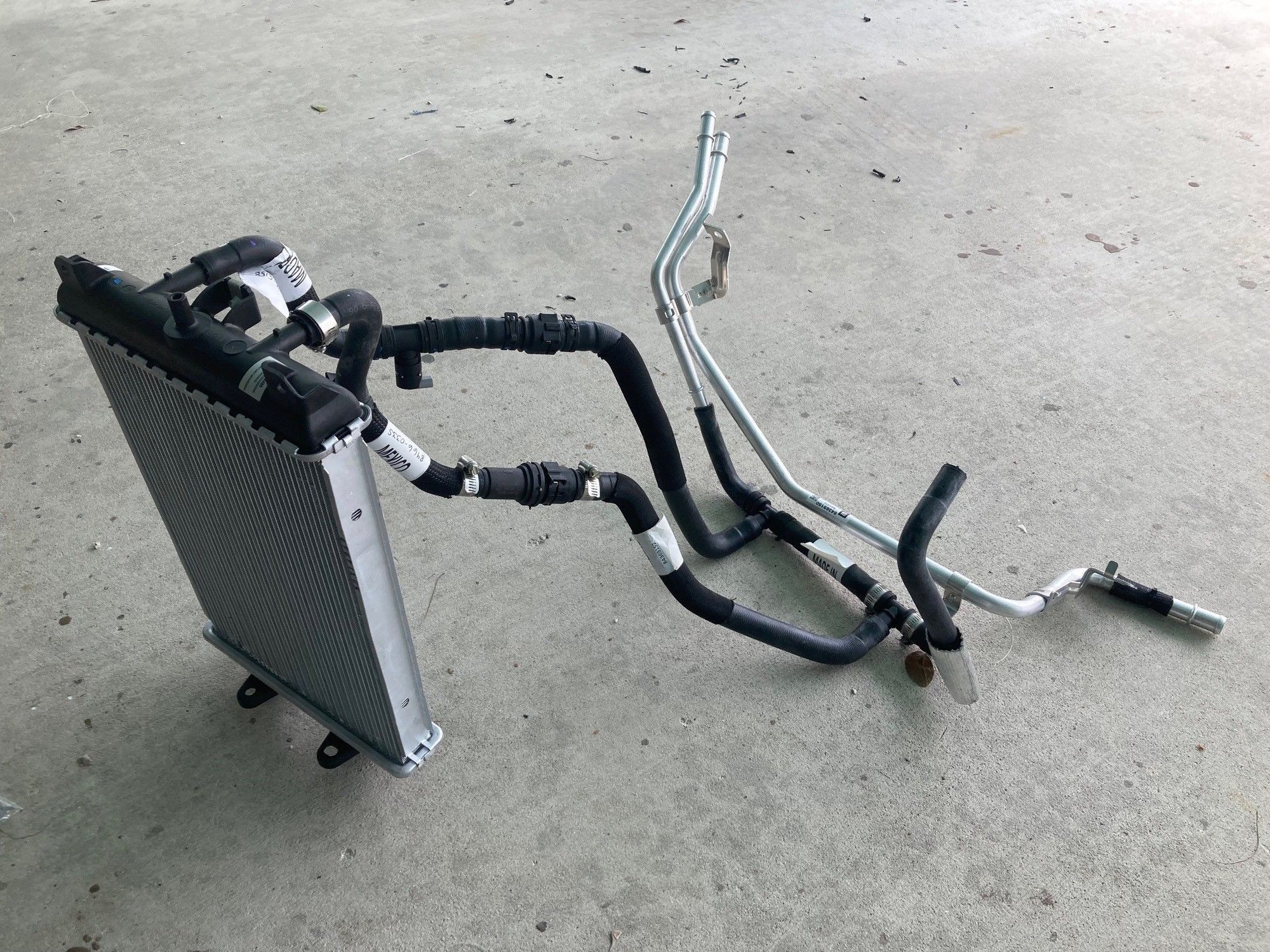

Here are the factory parts I just got in for the transmission cooler (passenger side). Thermostat and sensor included.
As a sidebar, if GM dealer installed them, would warranty still be good?
