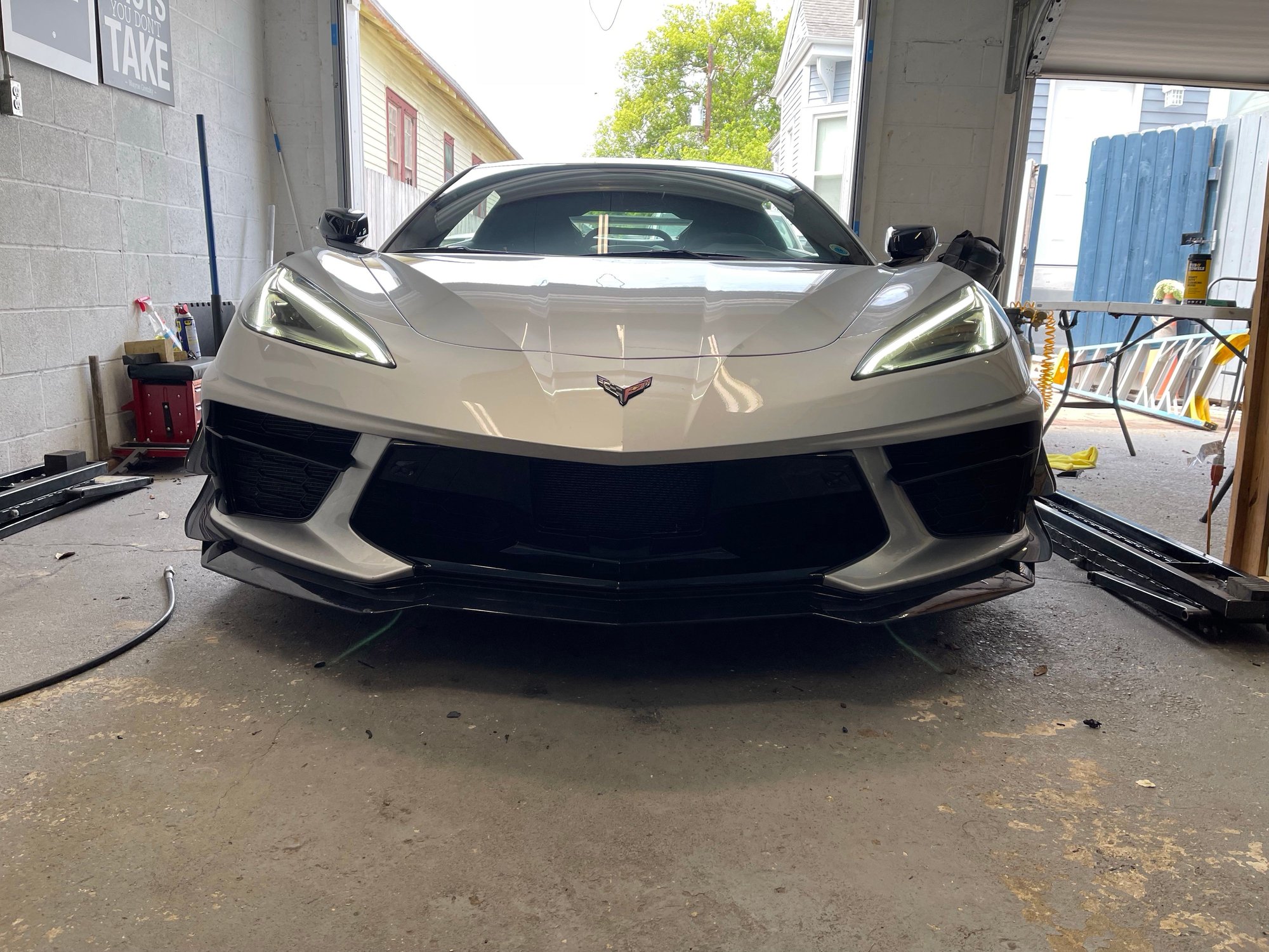

In my quest for lower temperature eng/oil/dct, I added another radiator in the center.
Removed the plastic behind the licence plate cover. For street driving I just reinstall the cover and it looks stock. The temps are about 15 degrees cooler, the temp just stays about at the thermostat opening level. I may do a 160 t-stat if i can figure out which stat it takes. It’s a 2 bolt stat housing, so it’s not a gen v style. Probably order one and do some measurements.

c5racr1 very nice install and thanks for the info.
