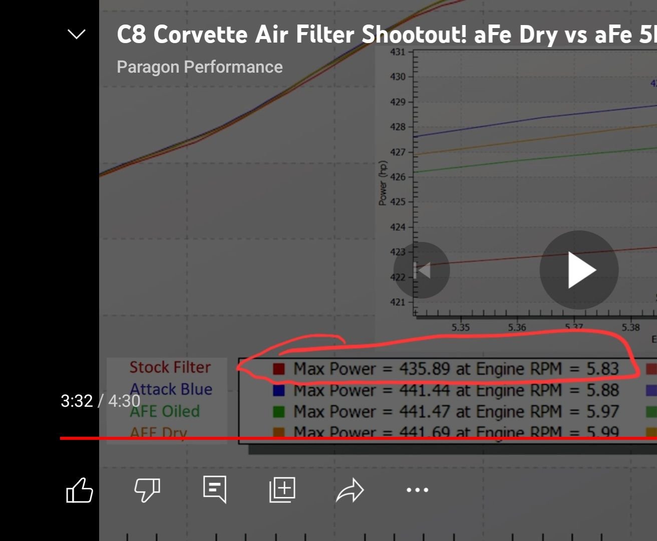

I admit though I'm torn with their videos because on one hand they say the right things that they are data logging with hpt to make sure starting iat are the same etc but then they are using the STD correction factor which inflates all numbers by about 4 percent as well as the highest level of smoothing of the results (level 5)...

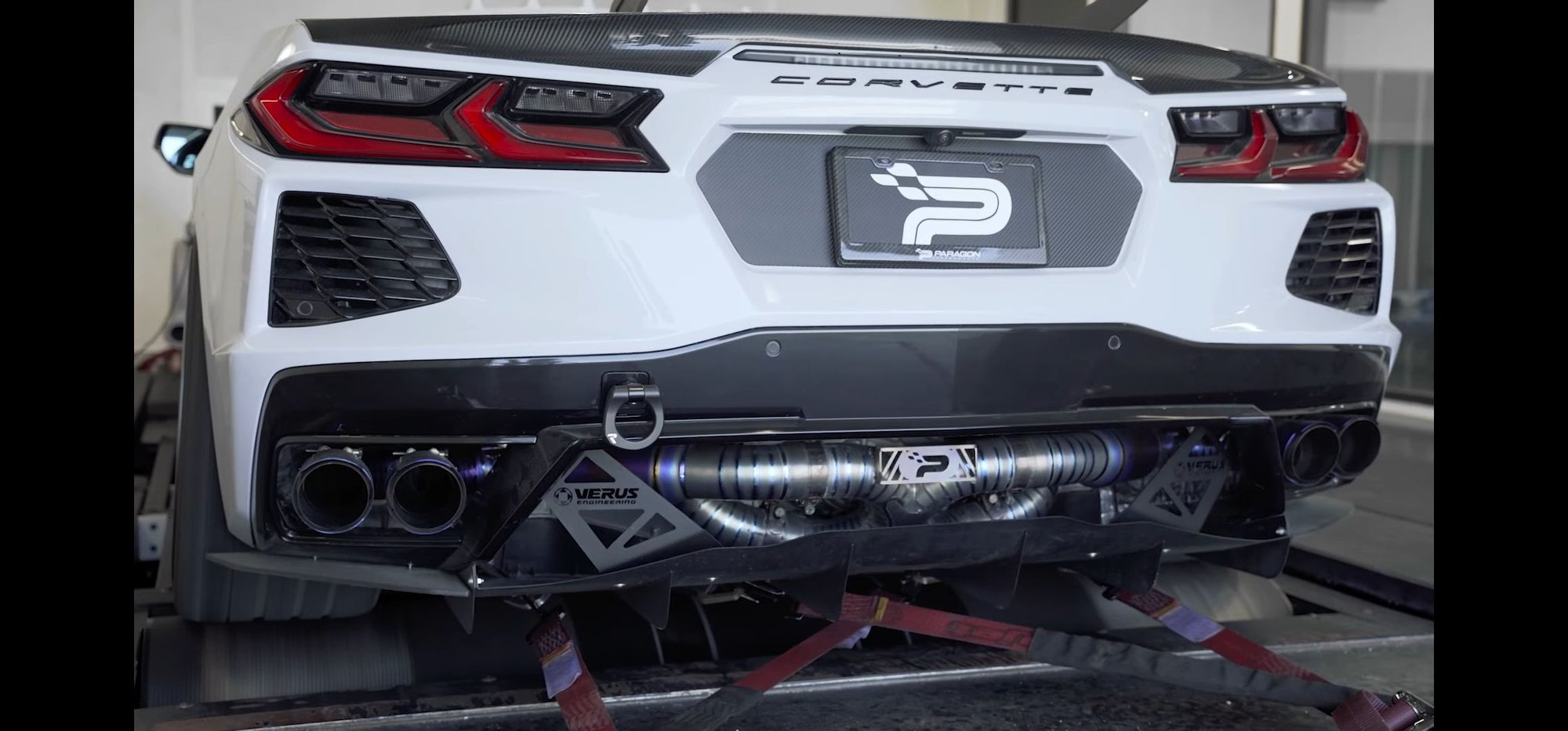

Then for some reason when they show the "all stock except headers" car on the dyno you see a titanium full flow through exhaust on it. They said that's for the video just to show off their exhaust but it wasn't on the test car. If you're trying to show and explain in each video (which they do) how they controlled for conditions why show a video of a run then with the car in a different configuration than you tested?
They've also been using the same "stock" dyno run for all of their videos since the started....
The air filter shootout...
The air intake shootout....
Now the headers....
I'm not saying they are doing anything improper. It's "fine" to use the STD factor that gives higher numbers if you apply it to all runs as they'll all be corrected the same way.
But you'd have to ask why use the same "stock" dyno run AND the STD factor and certainly one reason would be if you did 12 stock runs (which you should if you are trying to do power testing) and decided to keep the lowest "stock run" for comparison purposes instead of the average of all controlled-condition stock runs.
But the problem with taking a low stock run is people might notice it looks a bit low on the dyno jet. In this case SAE corrected that stock run might be around 423whp.
Again not saying this is at all the case. Maybe their 435whp STD run was the median valued run or mean valued run (roughly) that they did for stock runs. Maybe they messed up and just did one stock run when we know this car continues to make power through at least run number 3 on dynos without any mods done to it. Maybe anything. it's just very hard to do dyno sessions without significant error rate that goes uncontrolled.
But you'd have to ask why use the same "stock" dyno run AND the STD factor and certainly one reason would be if you did 12 stock runs (which you should if you are trying to do power testing) and decided to keep the lowest "stock run" for comparison purposes instead of the average of all controlled-condition stock runs...
I also appreciate what Paragon does, and there's nothing wrong with STD correction IF all runs are shown using STD. Yes, it inflates the numbers slightly vs SAE (the better correction factor), but again as long as they are consistent in use, it's fine. The bigger concern is as you pointed out, that they are using the same baseline for comparison for everything. Assuming they put the car back to stock for each different part tested, you're still going to get changes to the car between runs over time, especially if it's being driven as the fuel trims will adjust, the quality of gas from tank to tank will change, the spark plug wear will change, etc. And yeah, on top of that, are they cherry-picking the lowest stock run to compare to the best modified run. Ideally, they should be doing several baseline runs right before they install the part (i.e. 3 runs), then install the part, do the after runs (again doing at least 3 runs), and compare the average of the before runs to the after runs. I bet you'd find the difference is much less than advertised doing that.
