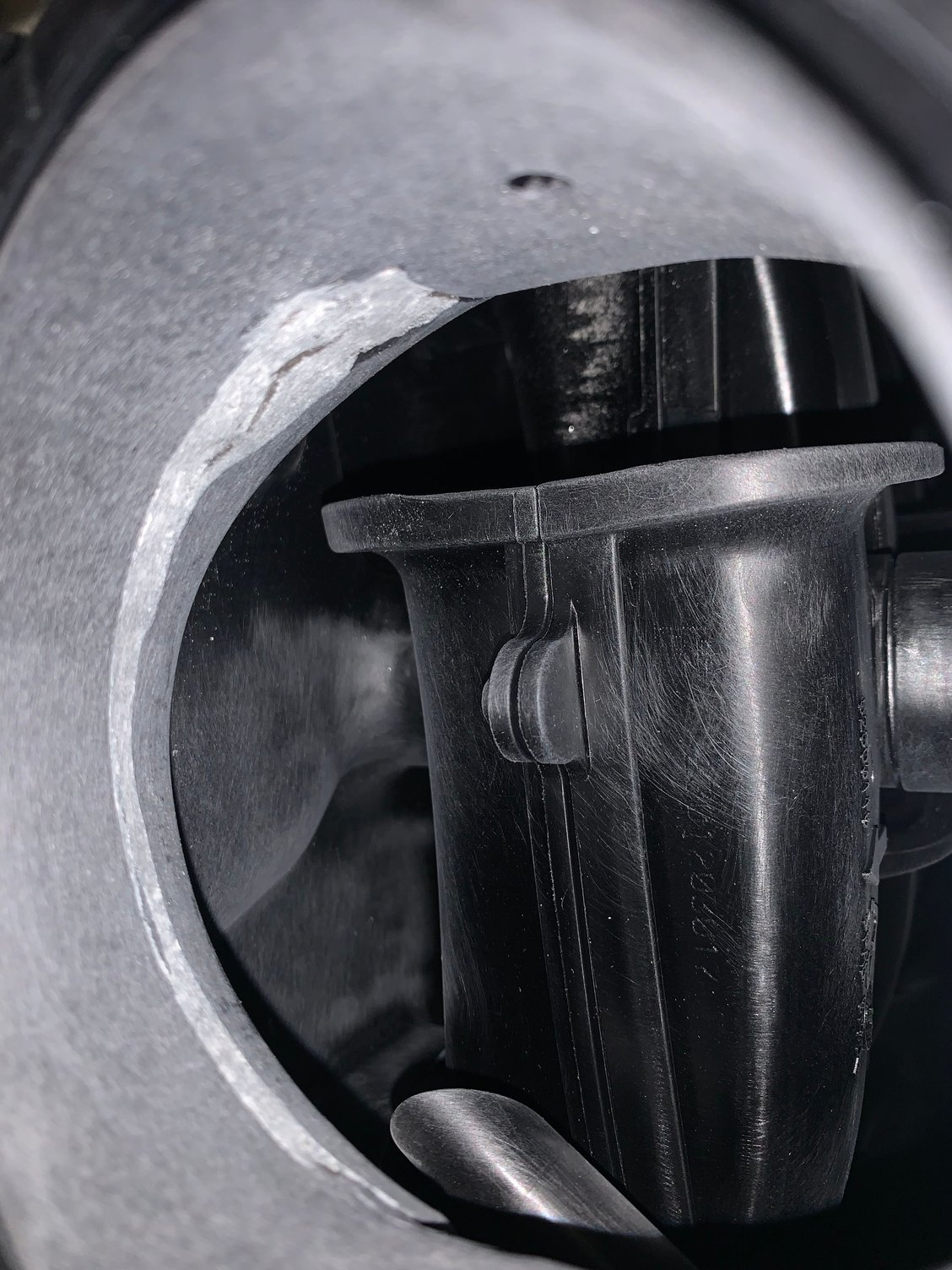

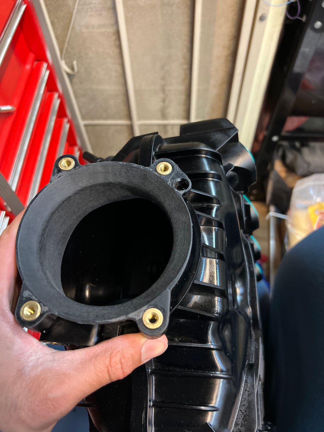

Picked up this newly ported intake. See pics and lmk your thoughts at least those of you who have experience with porting.

Bought mine from a forum member and it didn’t have any kind of repairs like that. it’s been ported out by GPI to fit the 95mm throttle body.

That looks some random 12 year-old did that.

My concern is this stuff separating and finding its way inside my engine. Mine is new btw. I will contact the seller today. Man, quality control has fallen off so much nowadays!!

Are those small cracks in the plastic? Mine looks like repairs in the plastic.

A couple of passes with a small ball hone in each port, clean up the intake opening with a cylinder hone, and charge $300 or more in less than an hour. Just clean up the edges to smooth. Helps to see a finished intake to understand what to do.

Those look like aggressive porting. I don't have any pictures but mine was slightly ported by a local shop that had experience with porting. If any of you guys need another manifold to be re-ported just PM me. I still have my OEM one in box.
They're not cracks but areas where there are already relief lines and they just failed to smooth them very well

That looks fine to me. The more you port the throat of the intake, the more the seams are gonna show. I used a digital caliper to measure the backside of my ported 95 throttle body and then grinded away to match it on the intake side. The bottom of the IM neck doesn't have as much material as the top so I used epoxy on the outside to bolster the integrity. It gets super thin.
The digital caliper also comes in handy to pseudo port match the intake runners to the heads. I found the runners needed a lot of massaging and really concentrate on the short turn too.

So I did receive a call and text from the seller. He said “The epoxy is standard when porting.” He stated the porting is aggressive and the epoxy is required in the thin areas. He assured me I would be fine running this intake with no problems. I will post results after I have a chance to track my car with the headers.
thanks to everyone for your input and hopefully my results will be positive !

I got to install the intake today, which was a breeze. Crank her up with no issues.
