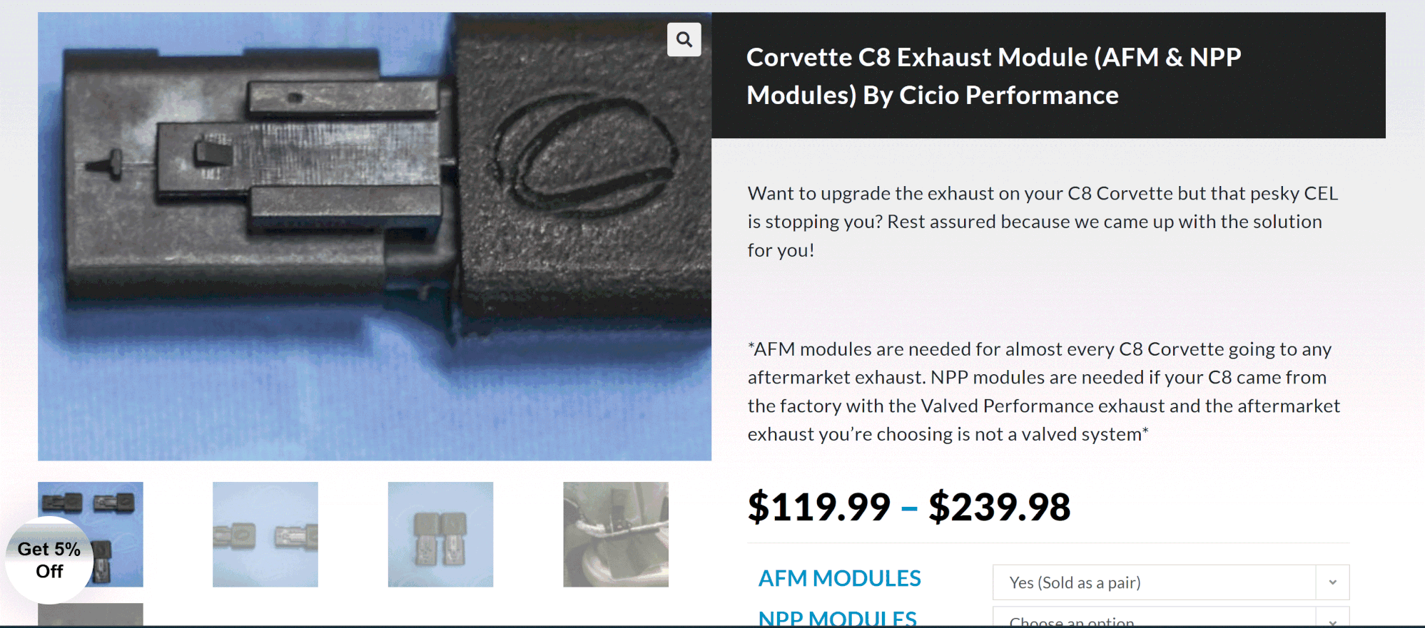

The AFM modules is almost, if not the same as the NPP module. It is recommended to use these when installing a aftermarket exhaust. So for those that have installed aftermarket exhaust and use these modules, did it prevent the V4 mode from enabling.

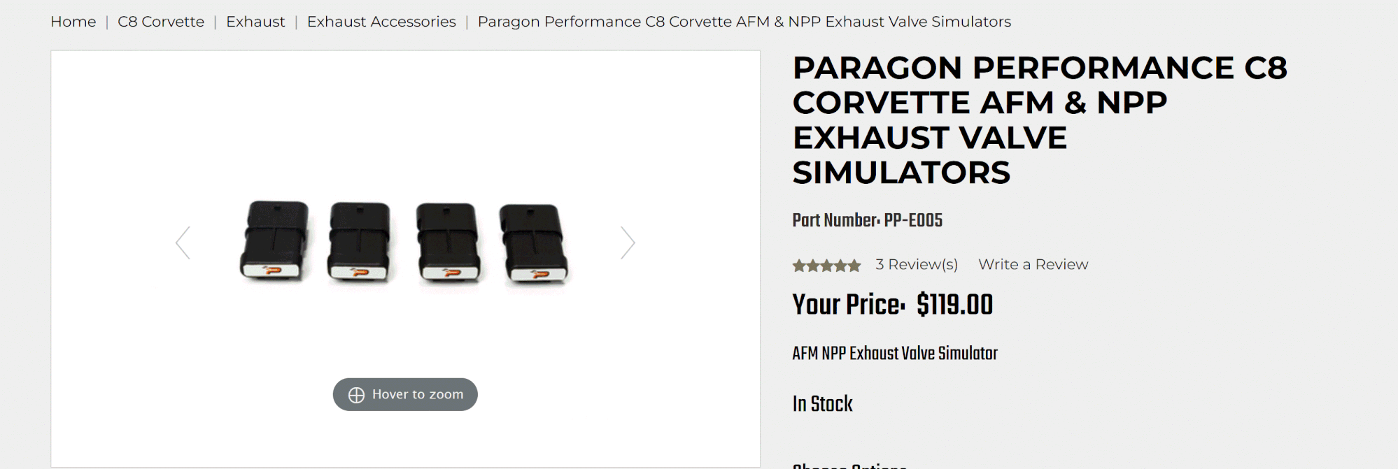

I am aware of exhaust valve simulator that are used for that purpose, as in the attached clips. The replace the "actuators" that are on the original exhaust system and simulate the signals from the actuator so that the car thinks it sees the valves in the muffler opening and closing. And no they will not keep the car out of V4 mode.

Ok, I found a version of these that are called "modules". They are functionally the same - they simulate the electrical signals the car expects to see from the actuators on the muffler. And no, they will not keep the car out of V4 mode. They just prevent CELs when the original actuators are disconnected.

That is what I wanted to make sure on. thank you
