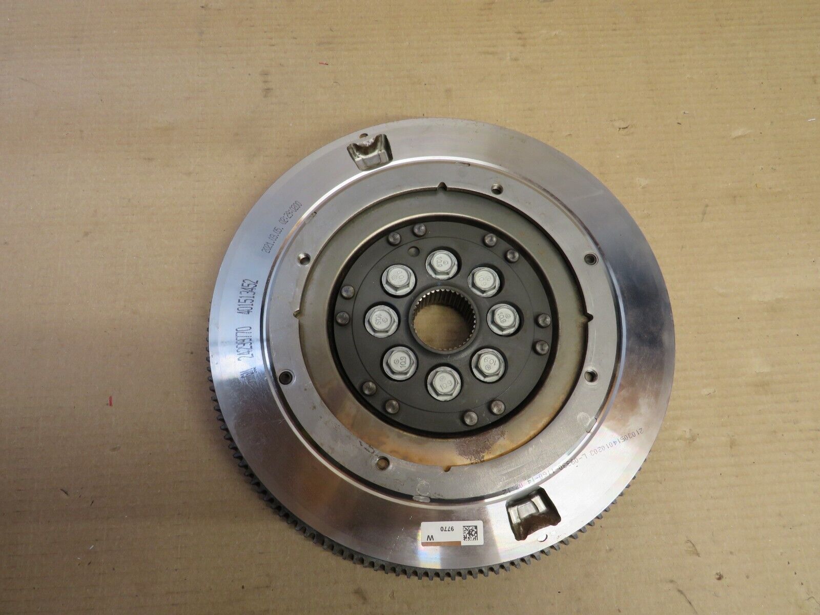

Hmm. What does a flywheel look like on a dual clutch transmission? It has two input shafts doesn't it? And aren't they concentric?

Yeah, thanks. I did look for engine and trans cutaways before asking and could not really make it out. But, you're right ...I just now typed in 2020 corvette flywheel and it popped right up. Here also is a little info on it from an SAE article:
"Connecting the LT2 engine’s crankshaft to the TR-9080’s clutch basket is the responsibility of a flywheel carrying the
starter ring gear and a centrifugal pendulum damper that’s needed to quell torsional vibrations erupting during the
engine’s migration between V4 and V8 firing modes (a fuel efficiency improver). "

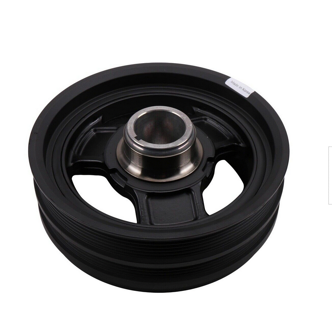

My next question was going to be "does it also still have a harmonic balancer at the other end of the crankshaft?" So, I looked that up too, and sure enough they are for sale on ebay.
