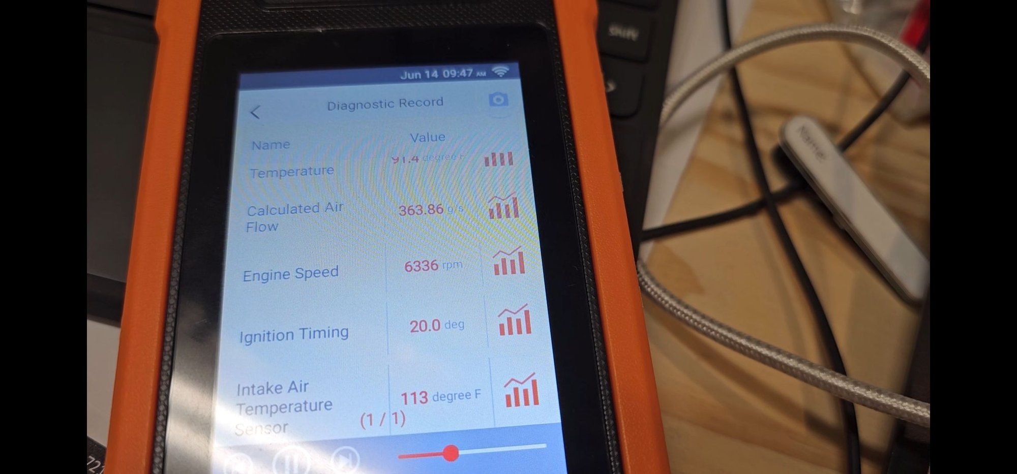

Just did a round of intake temp testing.
When I do this I try and control test conditions so for my test protocol on the "stock" runs I did...
1. Bring oil and ECT up to operating temp.
2. Do one 0-130mph run. Take iat data point.
3. Immediately stop car after run to 130mph and do 5 min timed heat soak. Take data point 2.
4. Immediately after heat soak do second 0-130mph run. Take data point 3.
5. Do second 5 min heat soak. Take data point 4.
So far on my stock system in 83f ambient I got.
96.8f - after 130mph run 1
118.4f - after 5 min idle heat soak
107.6f - after heat soak run to 130mph
127.4f - after heat soak idle #2
All in all not bad at all and all under iat offset timing tables.
Max timing on 93 octane was 22 degrees. I've heard people getting 28 degrees on e30 or race gas

How did you measure the timing?
I used my portable scan tool for convenience sake but I could have used HP tuners
