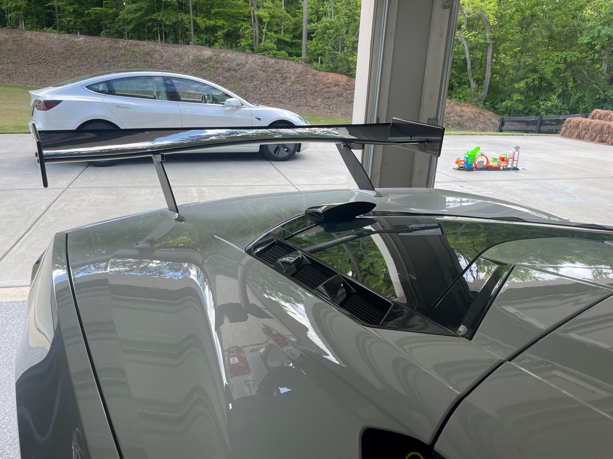

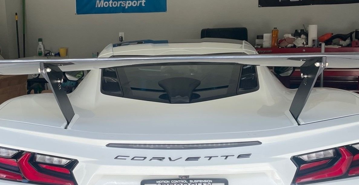

Props. I’m working on a few ideas for this next project myself. Same manner you’re planning. Haven’t rushed it for I want this well thought out. It’s a must for us. Keep us posted if you don’t mind.

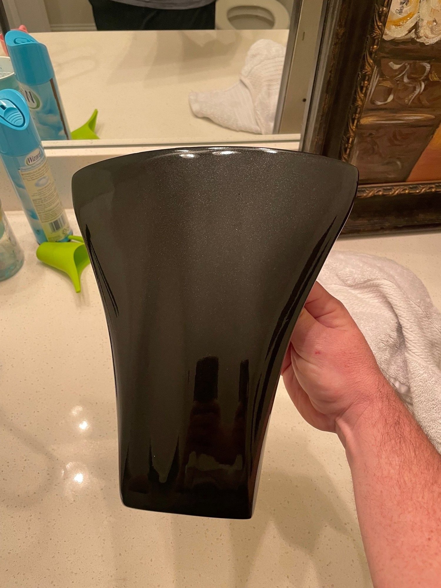

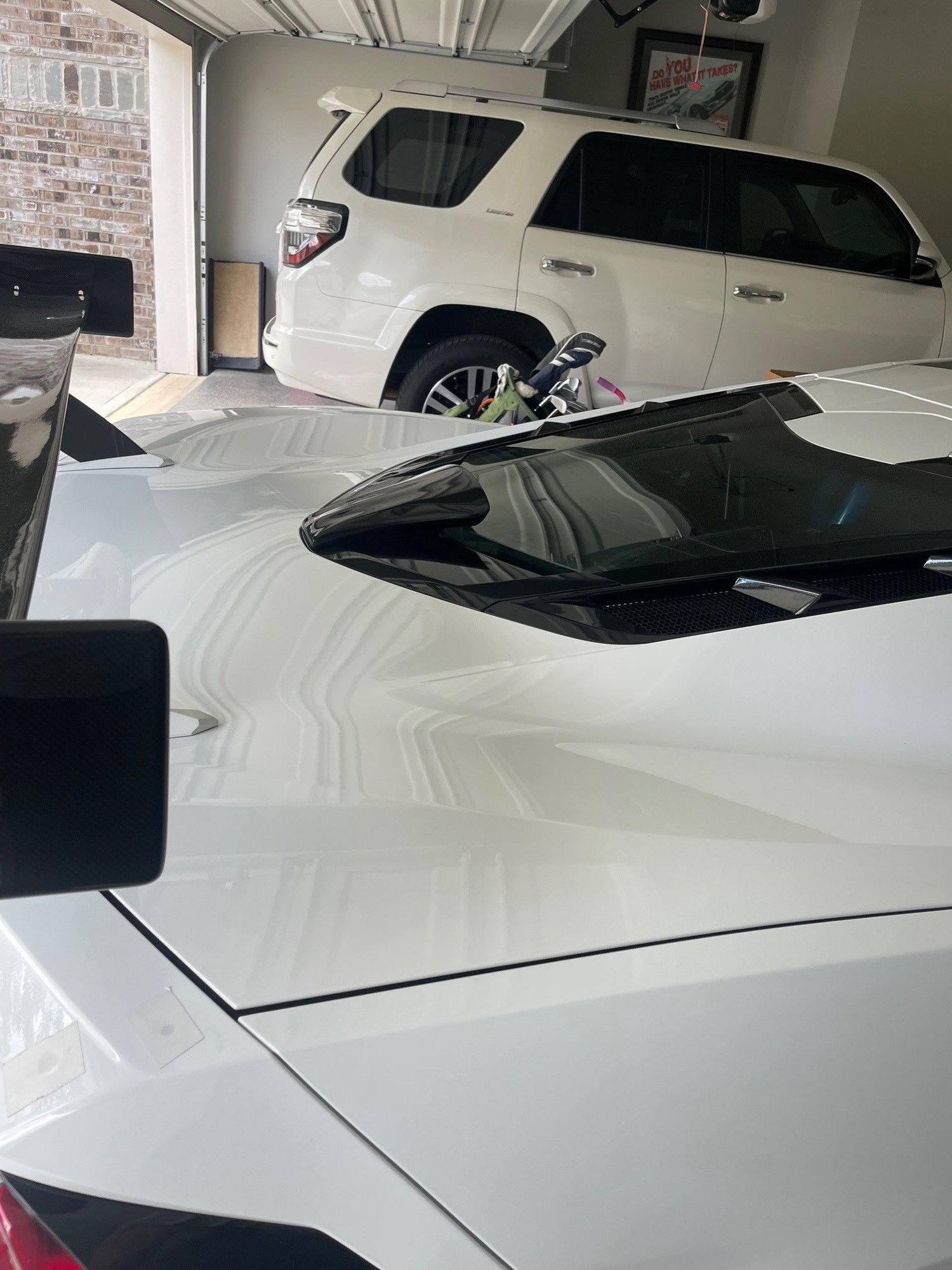

Most the track guys already know what my NA solution was.... it helped but wasnt the end all be all in terms of IAT's. The map sensor in the intake manifold is still getting temp (IAT3 for those using a scan tool), there comes a point that you can only pull so much heat out. Now i'm battling this to a greater degree with being supercharged and trying to make that survive on track. I made about 4 of these things, 2 were trashed, 1 is on my car and 1 was sent out, never heard if he installed it or not.
Everyone should just buy a Porsche GT3; until this car has a real tuning solution we are throwing crap at a wall, lol.

Tell me what this is doing. What are your results?

Right!!
But here we are still pushing the platform for every bit of time out of different Motorsports. We all here have got the Motorsports formula. Spend a lot to get a little. Lol. You want to win a million dollars. Start with two.
I have been pulling heat out of this car.
