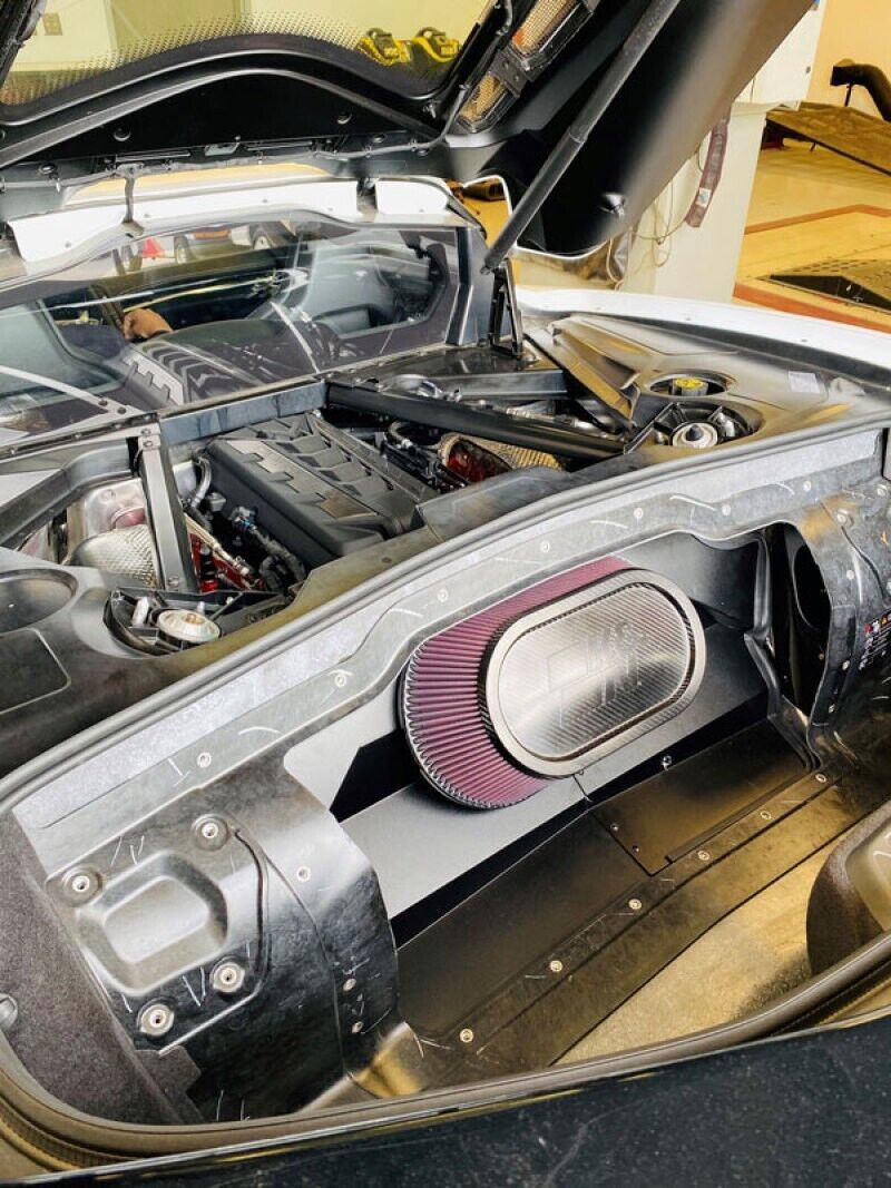

BUT still follow improvements. Thought this K&N system had promise. they say 22 hp and like aFe, who I also like, have to take hp claims with a grain of salt.
Thought this had promise. Now if air scoops directed air in an insulated trunk?

I looked at that also, several issues, 1st the fresh air intake still comes over the exhaust, and the trunk has no independent way of getting fresh air. #2, with that particular filter the air has to make a 90 degree turn, which kill’s velocity (I don’t know if it has a velocity tack built in. Bottom line is any intake that uses the factory inlets are going to get heat sunk after 10 minutes. Keep in mind the z51 cars have a radiator on the right side that is heating the air coming into the engine bay. The pod on the left has a fan, and no radiator so that helps.
