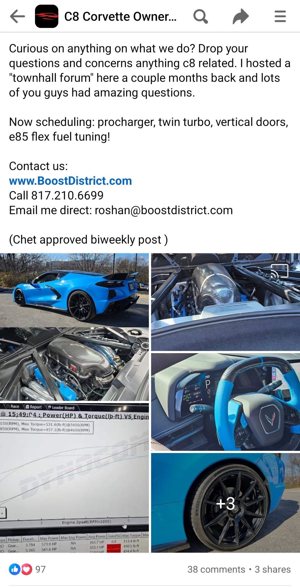

The Texas Boost District location is looking for customers for their cam set up. $8,500 installed w/Tune and stuff. Not sure if that's still available but Roshan posted on their FB
$8500 is already absurd. Even with $3k of that being the tune, $5500 for a cam and labor? Nuts. And this is a discounted price? They would have to just charge me for parts for me to leave them my car.
