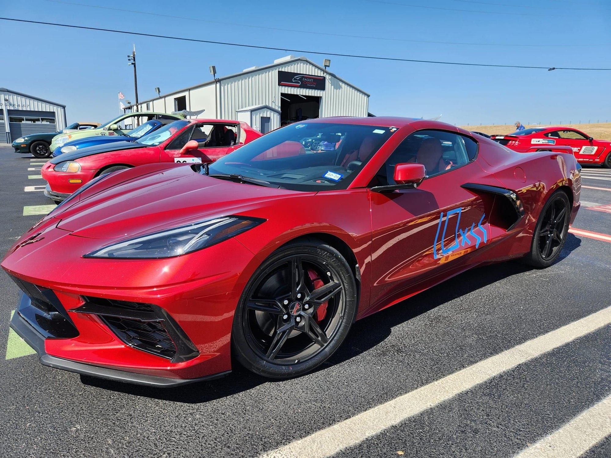

Yesterday a C8 had 275/35R19 and 325/30R20 Nankangs squeezed on stock rims and would think they’d work even better on wider wheels with the Z06.
