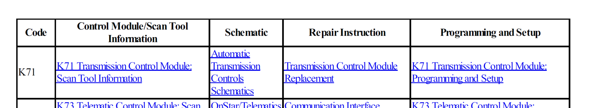

In the Service Manual, there is an Engine Control Module (ECM), a Transmission Control Module (TCM). I have never seen any offering for an aftermarket version of either of these for the C8. There are discussions that certain vendors (HPTuners) can modify the programming in the factory ECM. There was also at least one discussion about a TCM mod, but I think that may have been a mistake.
The point is, seems odd that warranty claim would be denied due to an "aftermarket" TCM - there may be no such thing. I suppose it could be denied if an owner replaced the TCM with another GM sourced C8 TCM, but not properly calibrated or programmed. Some programming procedures are requires when a TCM is replaced - perhaps they were not followed. And there were some factory provided TCM calibration updates. But those can typically be performed without replacing the module (unless the module is defective - which should be a warranty issue).
