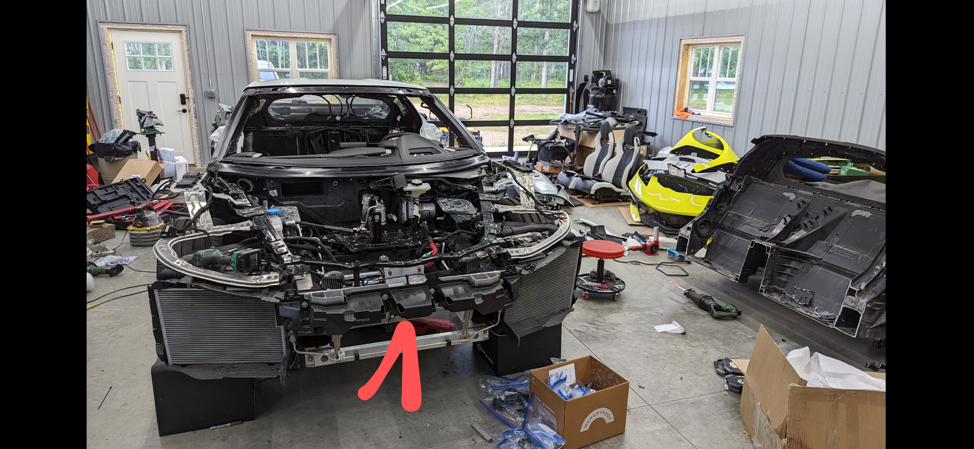

Hello Forun Members,
I am rebuilding a C8 and need your help to find the mating connection to the front trunk 2 wire connector. The other connector if for the trunk release and it is on the front side of the trunk. This 2 wire connector routes behind the trunk, but I can find no mating female connector. I would appreciate help.

Is it possibly the proximity sensor? There is one on front of the frunk on the backside of the impact bar.

Good suggestion. On the impact bar I see two crash sensors, 2 horn connectors, 2 connections for the trunk release, one connector for the trunk light, release, power plug, one connection on bottom of plastic bumper crush zone (this may be the proximity sensor). But I still see no open female plug for this 2 wire connector? Does the bumper cover have any wires? The bumper was not on this car.

I'm trying to remember it's been a few months since I rebuilt mine. Now I think the proximity sensor is below this plastic impact. It's not on the front bumper the connections are on the sides.

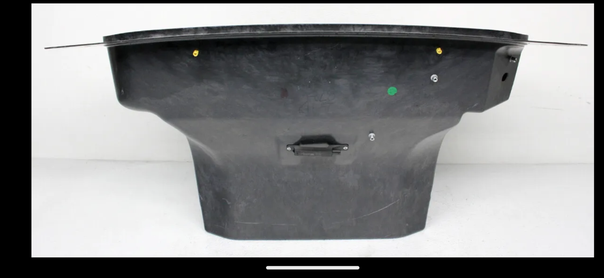

Another proximity sensor on the frunk tub.
