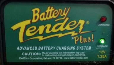

Old Sep 19, 2023 | 05:04 PM
wrecker3's Avatar
wrecker3
Joined: Nov 2003
Posts: 2,851
Likes: 1,871
From: NEW WINDSOR NY
First thing if you do not drive your C8 every day get a Deltran Battery Tender and connect it when it is parked. I have been doing this starting with my first 1987 C4,1989 C4, 2016 C7 and now my 2023 C8. I have had Batteries Last 10 Years.
