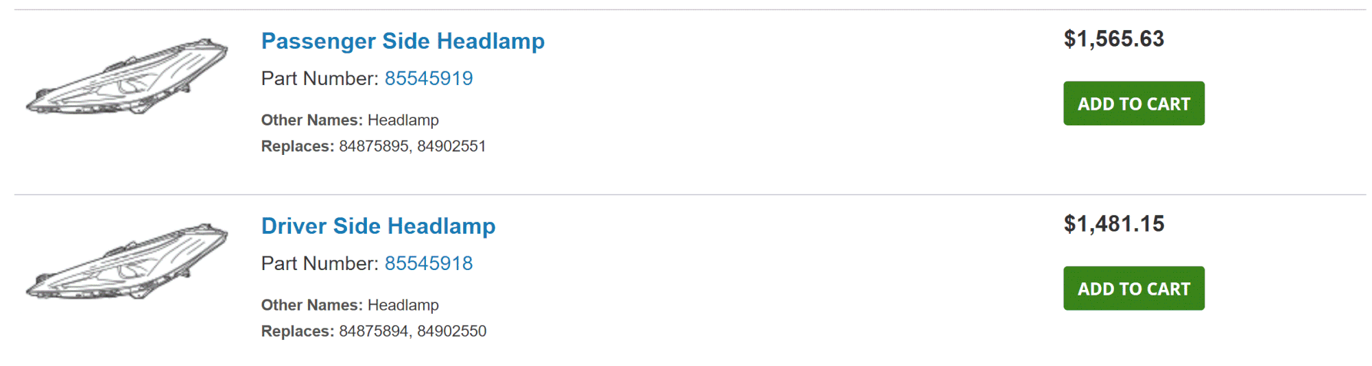

The C8 does not have replaceable headlight bulbs, they are sealed LED units. If one of yours has gone out, that is a warranty replacement item.
Old Sep 21, 2023 | 01:37 PM
Andybump's Avatar
Andybump
Joined: Mar 2007
Posts: 11,406
Likes: 8,567
The headlamp assembly is replaced as complete unit. It contains headlight leveling motors, a little cooling fan, LED lighting, LED drivers and an internal control module.

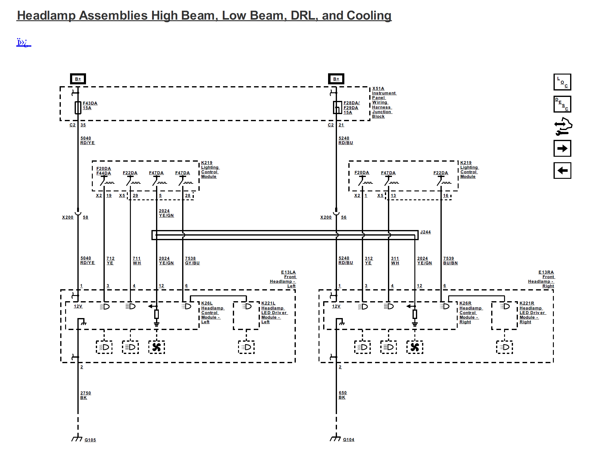

So they can be disassembled then? Some refer to them as being "sealed". But I noted that they have a cooling fan - or at least that is what shows in the schematic. Which made me think they might be vented. Are they?
Old Sep 21, 2023 | 05:14 PM
mortelec's Avatar
mortelec
Joined: Jul 2021
Posts: 694
Likes: 617
From: Crosslake, MN
It's a heat sink on the lamp driver remove 4 screws and pull it up. The driver is removable with the headlight assembly out. I'm not sure why GM doesn't offer this part separate.
