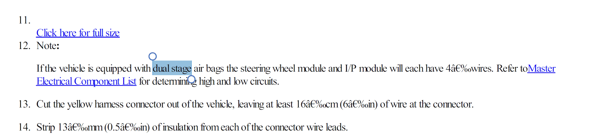

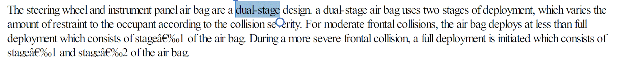

The 2020 Service Manual I have has something to say about dual stage air bags. I would take it with caution, since its 1) 2020 version, 2) its the paper ebay copy, and I have found errors in some of it (generally the description sections appear to be generic). However, generally the diagnostic sections and procedures are clearly specific to the C8. So with said, the manual appears to say, in the descriptive section that the air bag in the steering wheel is dual stage. In one of the procedure sections though, it says "Note: If the vehicle is equipped with dual stage air bags the steering wheel module and I/P module will each have 4 wires. Refer to Master Electrical Component List for determining high and low circuits." This may be a clue to a way to tell what airbag you have - but I am not sure. Obviously it would require disassembly to make the determination, so it may not be very helpful;
Can anyone who has made the swap confirm whether or not the wiring harness in the both the 2LT steering wheel and 3LT airbag have 4 wires, and that the connector in each has 4 metal contacts?
