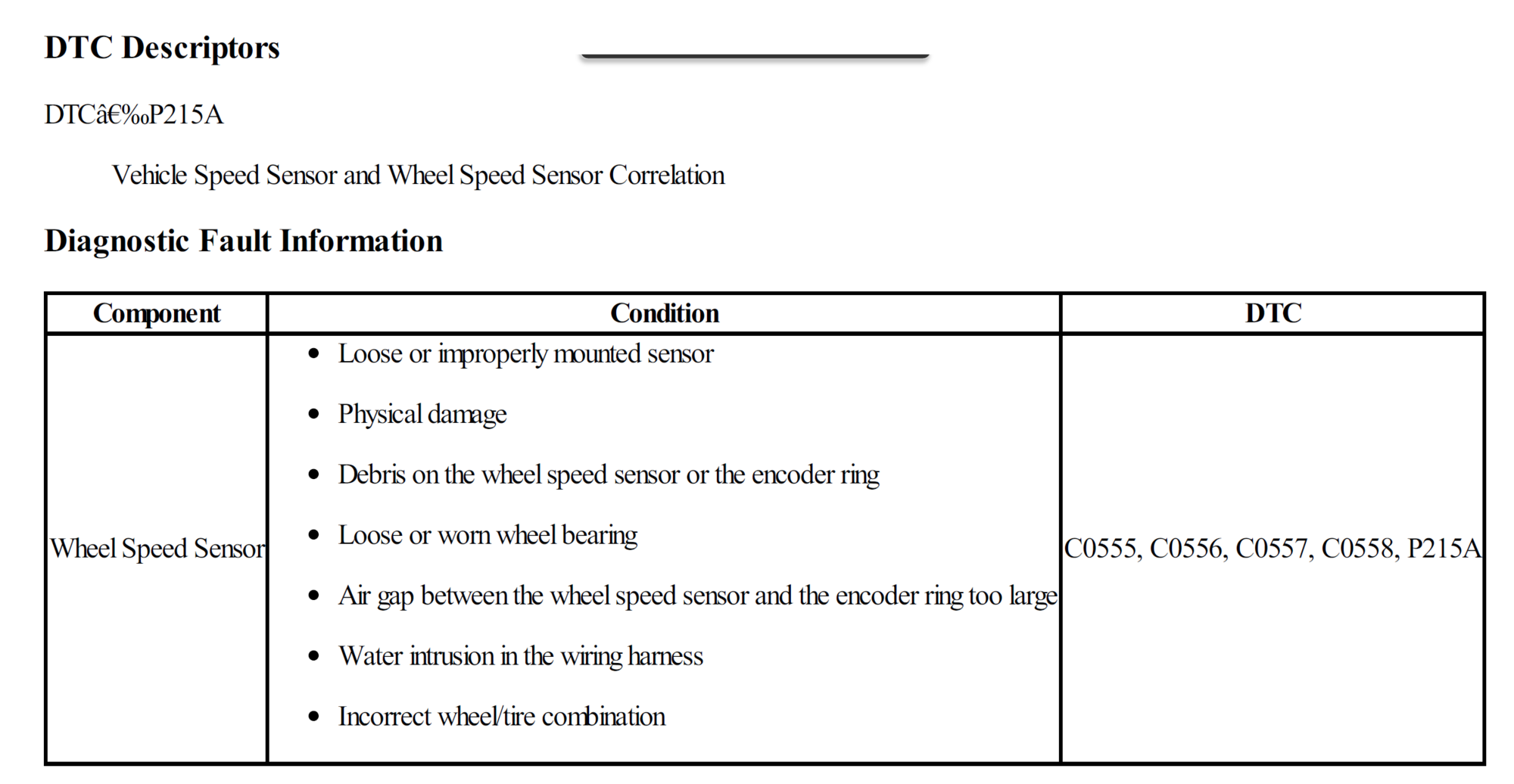

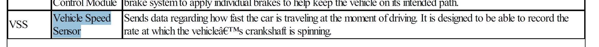

I think I understand you question. You are asking if the speedometer reading is determined by the speed of the rear tires. I found this in the Service Manual that suggest that the speed is calculated from the engine crankshaft speed, therefore, yes, it knows the selected gear ration in the transaxle and makes an assumptions about the diameter of the rear tires - so larger rear tires will cause it to read low. I did, however, note that there also individual wheel speed sensors that are used in the ABS and maybe other automated handling aids. And, I ran across a DTC that can be set if the vehicle speed sensor and a wheel speed sensor do not match. One of the conditions that causes it is incorrect tire/wheel combination. I have never seen anyone report an issue like that with different sized tires - so there must be some level of tolerance on setting of that code.

If it's using crankshaft revolutions to determine vehicle speed, it has to calculate it differently for each gear. That somehow seems a complicated way to do it when they could calculate it directly from either the transmission output or the ABS wheel speed sensors.
