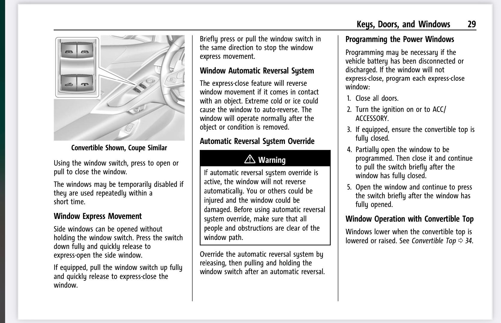

First I would cycle the top down and then back up and hold the button until you get the message that it is complete. If that doesn’t do it follow the programming procedure.
Thanks. Gave it a try and no joy. Issue persists.

Under the tonneau, just below the rear window, there is a black plastic cover. I have read (but haven't verified) that there is an adjustment that can be made under that cover.
Ii think the window indexing procedure only affects the side windows, and not the back.

Youre right that indexing didn’t fix anything. The back window doesn’t even index really. I was looking inside the tonneau earlier but didn’t see an obvious solution. I’ll check again tomorrow.
