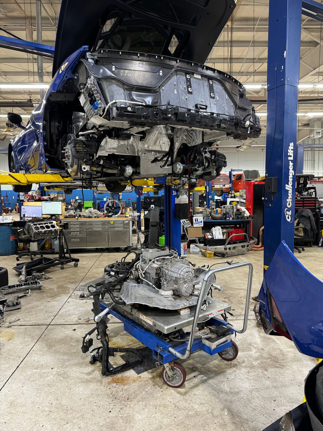

I think I may have posted in the wrong thread. I assumed C8Z was referring to Z51 and not Z06. I have the LT2.
Maybe similar issues with both engines?
Checked on mine yesterday. Apparently their “corvette guy” still has it apart.

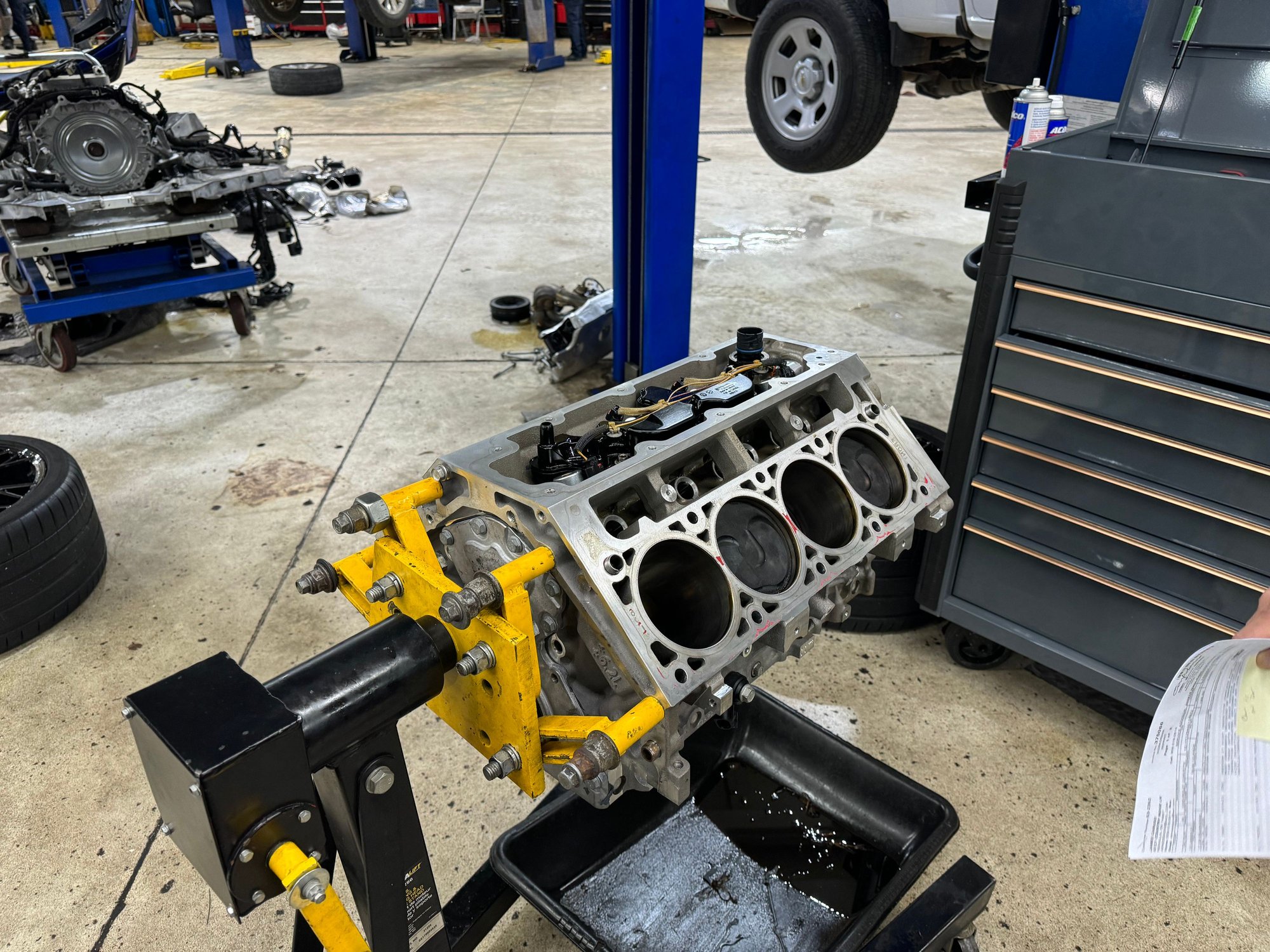

I finaly got mine back from the dealer. They were unable to figure out what was causing the tick. The technician who tore down the engine was unable to find the cause. After they had a engineer look it over they just decided to replace the motor.
Runs great now.
