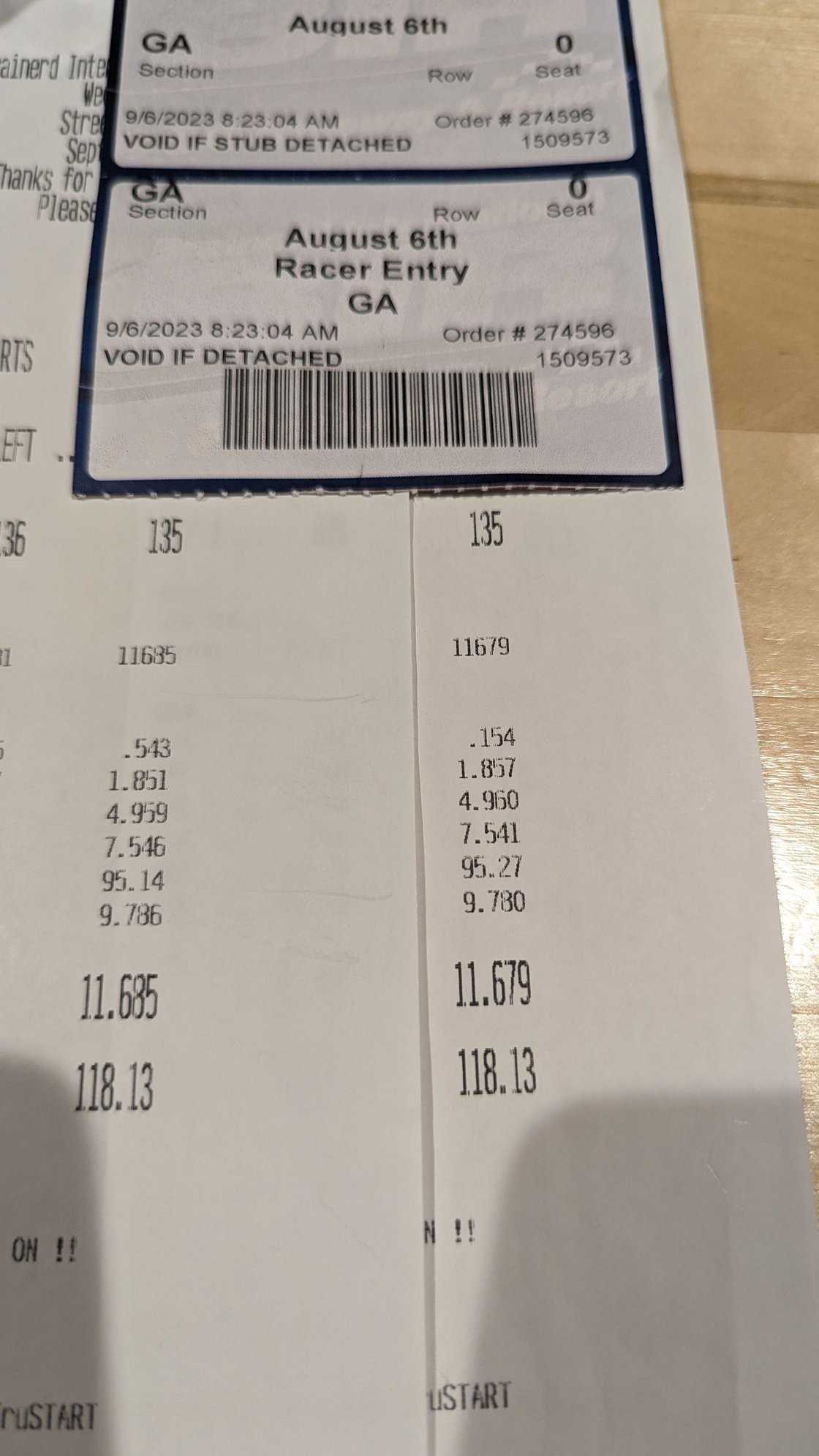

I don't bracket race buy do street legal drags at our local track. My C8 is very consistent and predictable. Time slip from my last two runs this fall. I use launch control in sport mode and let it shift.

Thanks for posting. I noted your reaction time varied by .3 seconds between your two runs. Did anything influence the difference in the reaction times? Thanks for your information and help

Other lane staged too deep and had to back up. This caused me to start launch control too early and learnt that it times out. Restarted launch control and left the line before it hit 3500 rpms.
