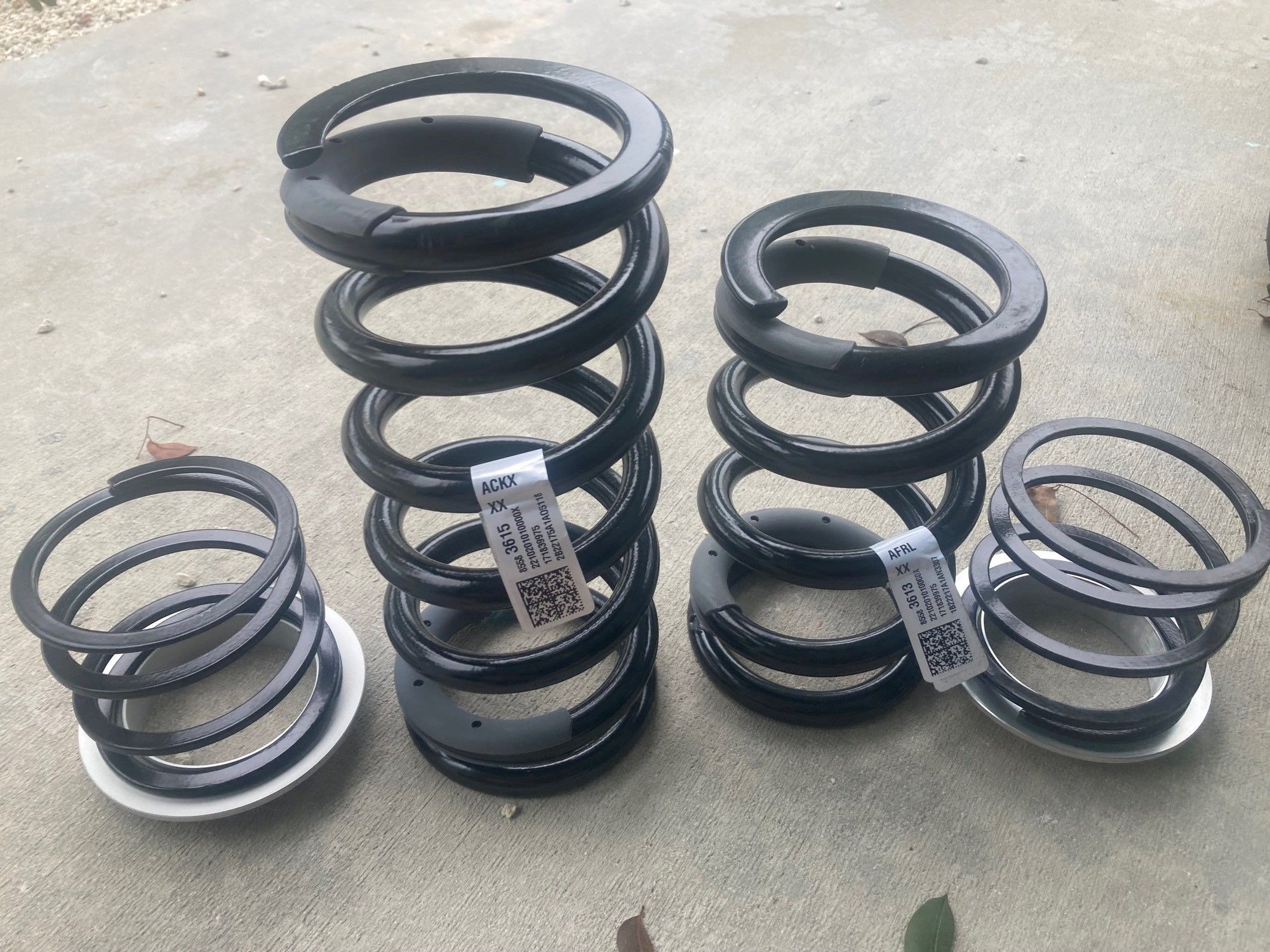

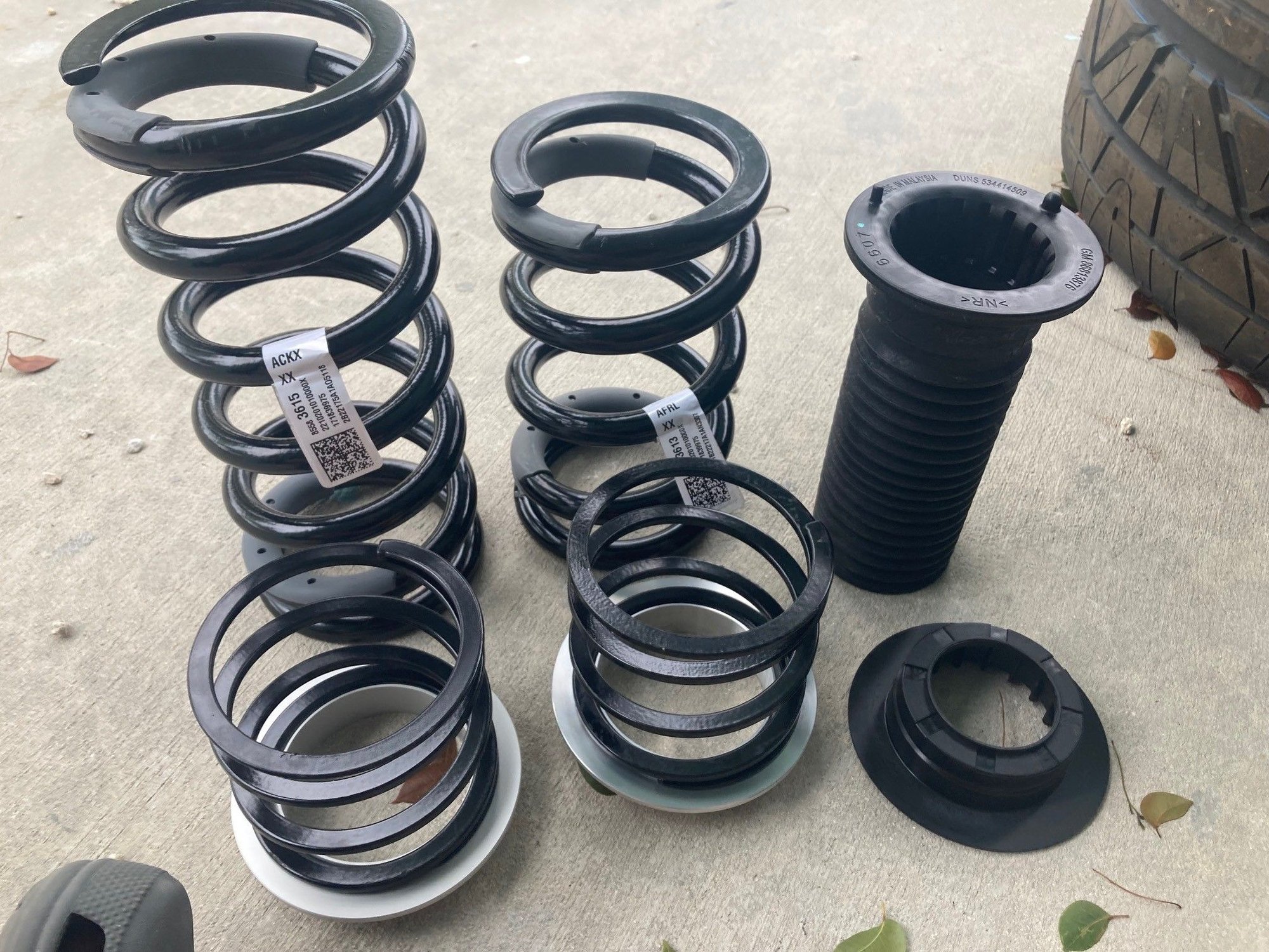

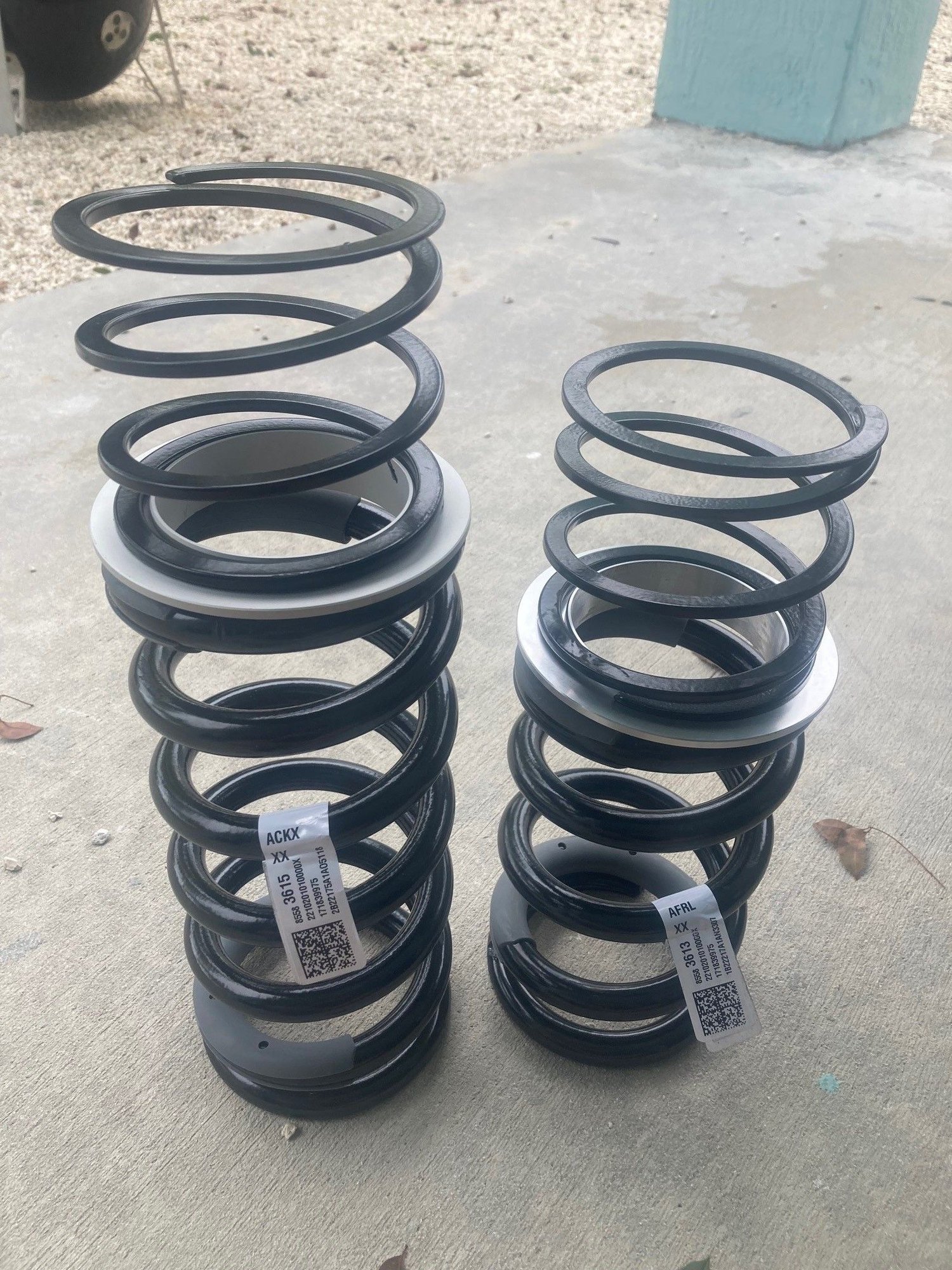

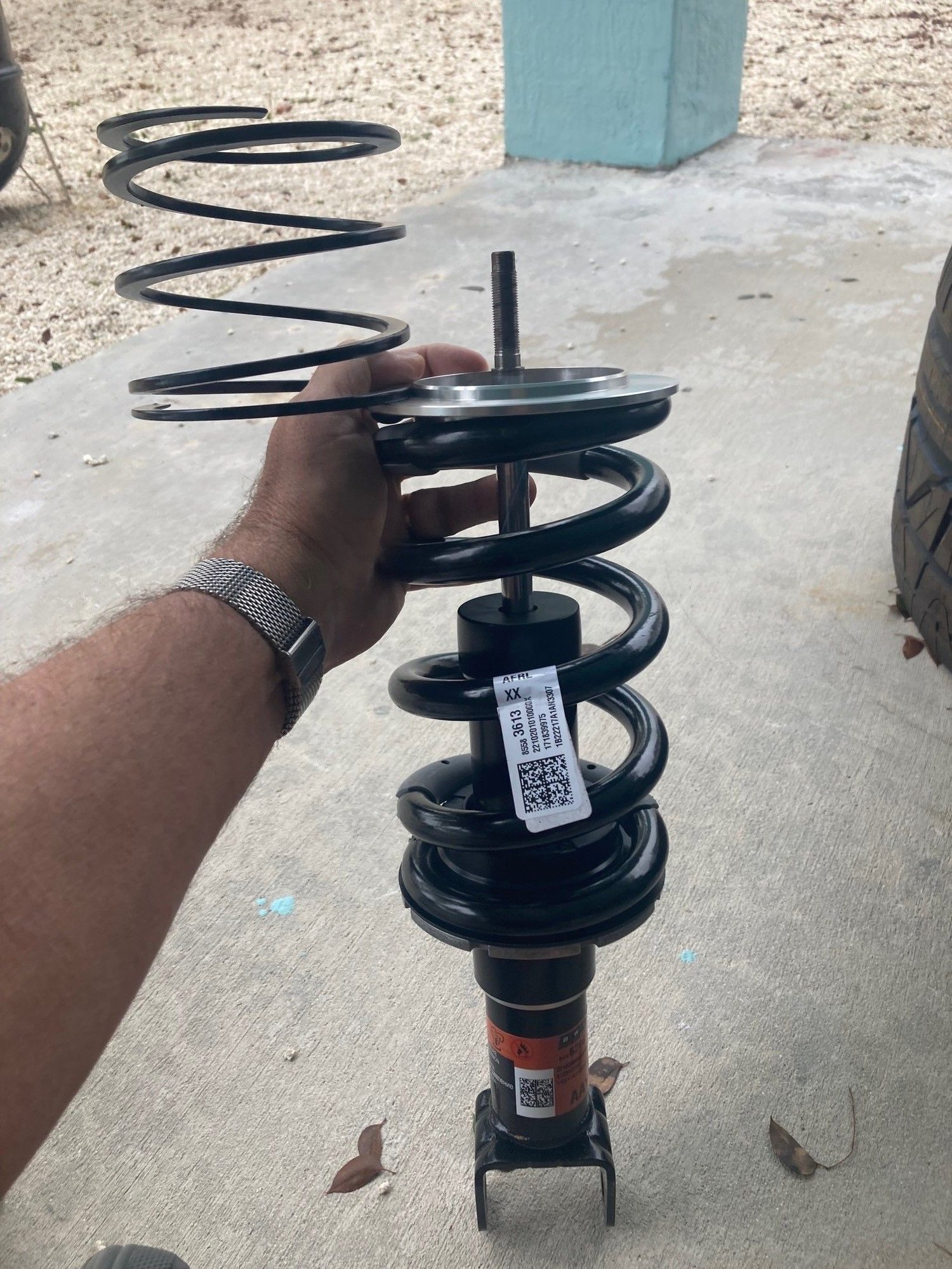

OK, so my single front and rear Z06 springs and isolators have come in. First, both come with helper springs and a flange to locate the springs. That is a question I asked in another thread.
Trial fitting on the Z51 shocks, they appear to fit just fine and look to have similar compression on the helper spring to Z06 MSRC shocks seen on YouTube. Note, I can’t really know for sure as I don’t have top-hats and plan to re-use the ones on the car. Compressing the helper by hand when mounted to shock it seems very close.
I still need to measure shock compression length and length to bind on spring to make sure there are no issues.
The lower Z06 isolator seems to fit fairly snugly on the Z51 shocks. I was concerned about this as the Z06 comes with MSRC shocks. Upper Z06 isolator looks OK. There are a couple of nipples on the top of the top isolator that should line up to holes in the top-hat. At this point I’m not sure how this will line up. I may order top hats but hate the thought of wasting money. We’ll see.
The Z06 springs are flat on all ends so I don’t think there is any requirement to line up to the isolators in any fashion.
Although I’m still not 100% this will work, confidence level is high. I will order another front and rear spring, 3 sets of isolators and Z06 bump stops. I may get the Z51 bump stops as well, just to compare.

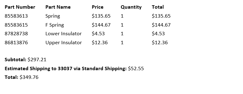

OK, so I ordered the remaining parts. Another front and rears Z06 spring, 2 front Z06 bump stops, 2 rear Z06 bump stops, 3 upper Z06 insulators, 3 lower Z06 insulators.
Here's the totals for everything:
Front and rear Z51 shocks from Rock Auto + tax + shipping $569
One front and rear spring, one upper and lower insulator from GMPartsOutlet.net + shipping $349
One front and rear spring, three Upper and lower Insulators, 4 bump stops Parts.GMParts.com + tax $389 (10%, 15%, 20% discount going on now)
Total $1307
