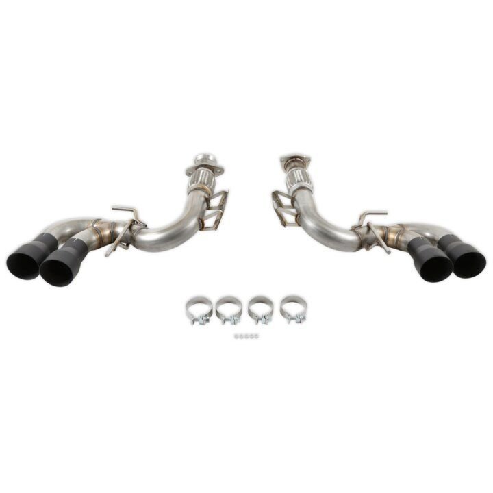

I would like to install an aftermarket exhaust on my 2023 stingray , i really like the sound of the hooker exhaust . I would like your opinion please. And if you know who can install these in or near SW Florida?

I’m looking for the same info. Specifically for the muffler delete cat back. I really like it’s simplicity and presumably low weight. Thanks!

Do you think the cat backs with the crossovers like MBRP and Paragon knock out the drone whereas these wouldn’t? The Hooker I listed looks simple enough that I’m kicking around ordering up some exhaust pipe, flex joints and bends from Summit to try and make one myself.

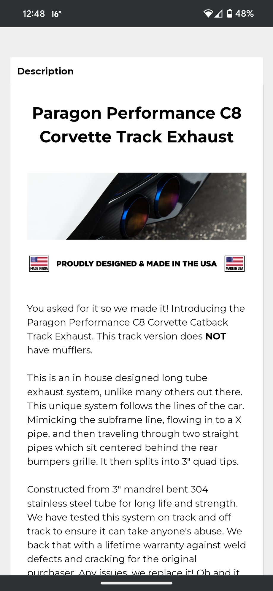

Happy to go over options and availability together I own Corvetteexhaustsystems.com call or text for the fastest replies 201-575-0861.
I always see you stating Paragon exhaust is made in China. Their website says their exhaust is made in the USA. Let's not spread misinformation about a great product.

just installed the hooker blackheart over the weekend. LOVE the sound!!!BUT mine threw codes.
i ordered sims from paragon
im gonna remove NPP altogether as well

We ran a prototype exhaust with an x that sounded great with no drone issues. We later switched to something like this to make room for a diffuser and it sounded great WOT on the straights but had a nasty drone cruising.

The hooker blackheart system has no afm valves so expect a weird noise/resonance in 4 cylinder mode.
Any time you delete the afm valves you're going to get a weird sound/drone when the car goes into 4 cylinder mode.
