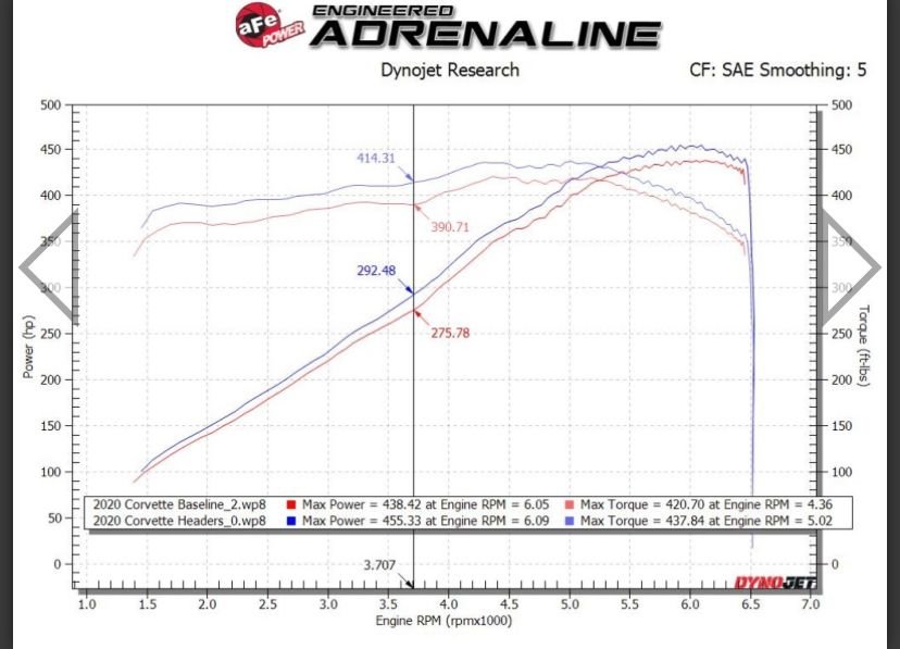

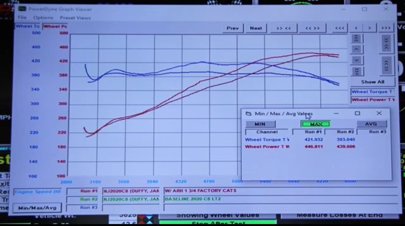

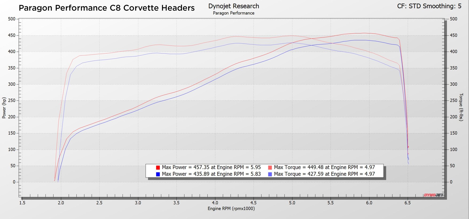

What about Paragons equal length headers? Looks like they give the most increases of about 25rwhp across the entire rev range. ARH’s is mostly just midrange.
The quickest bolt-ons cars have ARH. However, no one has reported any track numbers with Paragon headers.
Paragon advertises a 2.5" ID outlet flange, while the stock cats have a 2.75" ID inlet flange. Just something to keep in mine... Zero clue why Paragon/Kooks/Corsa are doing this when its proven to restrict flow.
For comparison, aFe matches the stock cats perfectly at 2.75" ID while ARH is slightly enlarged at 2.875" ID.

While that may be true, does it really matter?? The dyno results speak for themselves compared to the other ones mentioned. Isn’t strong, smooth/even power delivery what everyone wants instead of just peaks of power? Middle graph is ARH.
