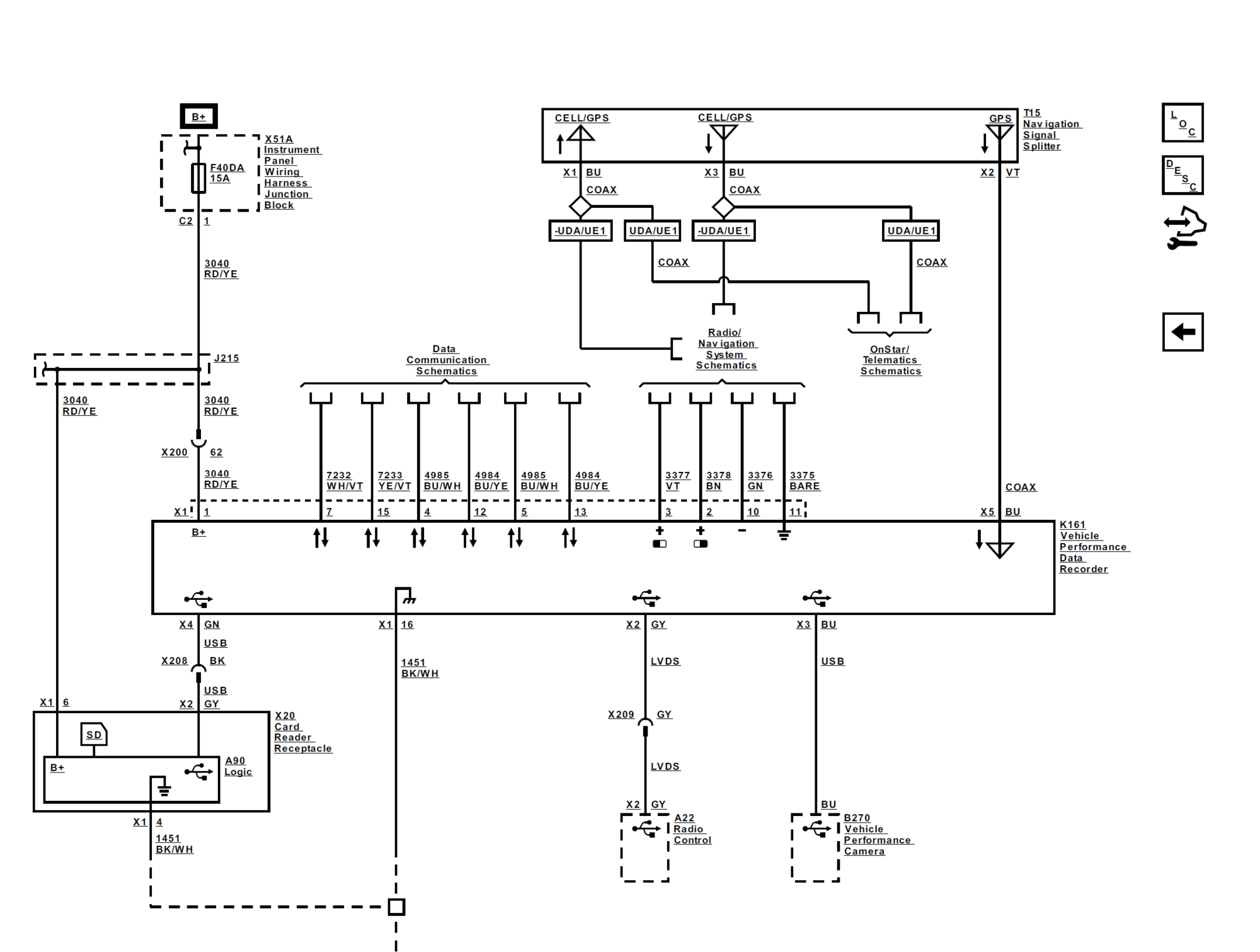

Yup. That is confirmed by the description and the schematics in the Service Manual. Those antennas - there are two - under the left and right front fenders, are called HIgh Frequency Antenna - Left, Right. And they are multipurpose proving the GPS signals for navigation and to the PDR, and also the 4G connection, and I think also XM radio. GPS also supports the front lift memory function. The coax cables from the antenna through splitters and connect to the telematics module, the radio, the PDR and maybe other places. I think it might be possible to pull the cable where it connects to the telematics module. It appears also that the telematics module also hosts the WiFi and Blutooth connections as well. It may be necessary to disconnect that, or the antenna, to full prevent connections to the outside world.
And, as noted, it is well integrated with all of the cars system. So if it is disabled by modifications (not to be confused with just terminating services), it may very well cause other issues.
