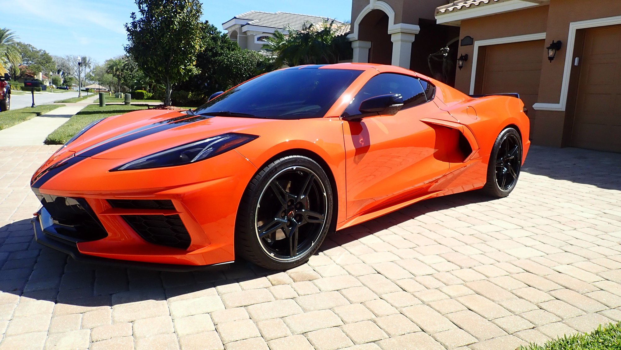

Thanks for the summary Sledge Hammer. Since I posted the poll I’ve lowered the car using the Paragon collars with no ill effect to the lift system thus far (3 weeks in). I was careful to line everything up the way it was with witness marks and also replaced the banjo bolt crush washers with new ones and tightened using a torque wrench. I also topped off the hydraulic (Dot 4 brake fluid) fluid with a couple of tablespoons to bring to the max fill line. Mine does not have MRC so didn’t have to mess with the wires. Lowering and widening with wheel spacers makes the car look like it should have from the factory.

bmjones, your car looks great. That is the look I want for mine. Please keep us posted of results bad or good.

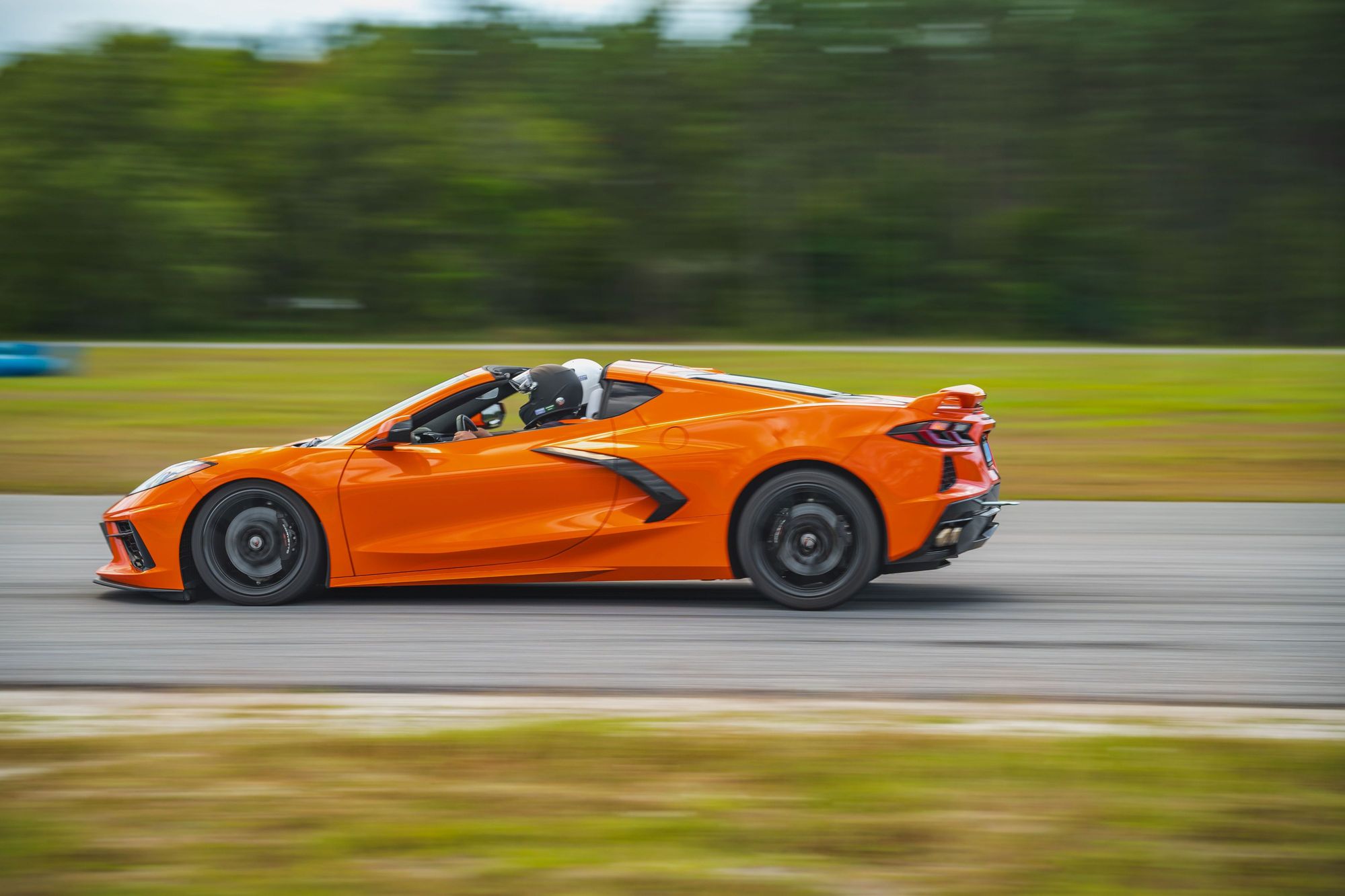

My lowered C8 with front-end lift is working great, and I probably put a lot more stress on mine than the typical user since I believe I heard more than 80% of the C8's never see the track.
It was lowered around July 2021. I have only had maybe 2 or 3 times where it said service lift system, and these occured when I didn't wait for the car to fully lift before bumping the left tire going up my driveway.
Look at how close the front gets to the road surface when heavy braking before getting into balance! Maybe 1" clearance there.
