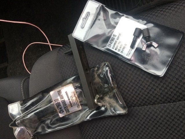

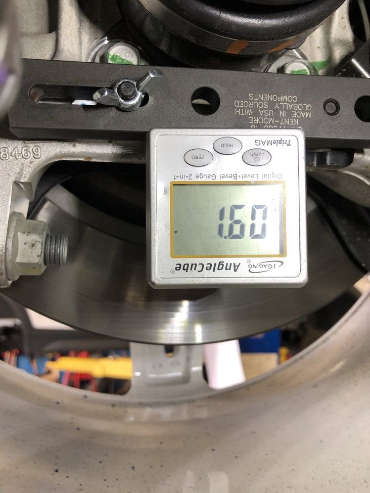

When a car is Lowered you will Get Negative Camber and will need a Wheel Alignment ! A C8 like C7 Corvettes have a Rear Caster Adjustment and have to be Adjusted Together. Alignment Machines Do Not Measure or Display Rear Caster. You will need to find a shop that has a Rear Caster Tool.
