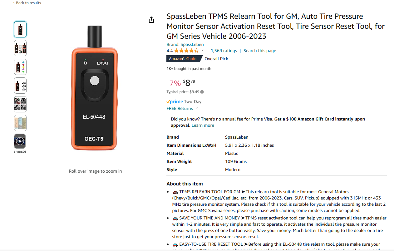

You have any specific one that has worked well? I am going to pick one up for the exact reason you state. Going to track I dont always have time to drive around to get the TPMS in my track wheels to acquire. Would be great to do it on the spot if needed.
This is what I see online
That’s the one. It was $5 two years ago. Never had an issue. Once you activate the relearn. Get out of the car and put the antenna portion right at the valve stem pretty much touching the tires sidewall seems to be the sweet spot. Then press the button. You can even hit the button sooner and just place it up there by the valve stem. The car will honk the horn and flash the lights to verify. Move on to the next. Takes about 15 seconds if that for all 4. The pressure will instantly display.
Yeah at the track it’s very helpful. I’ve helped a few people trouble shoot with this. This is why I have a couple spare TPMS. If you run them they all have to be working. This way if you had to replace one, you don’t have to worry about a shop having one or not while tracking. Reduce time and possible issues.

that is a neat tool for 8.79. I didn't think you could get anything that would work on a c8 for less than 10.
