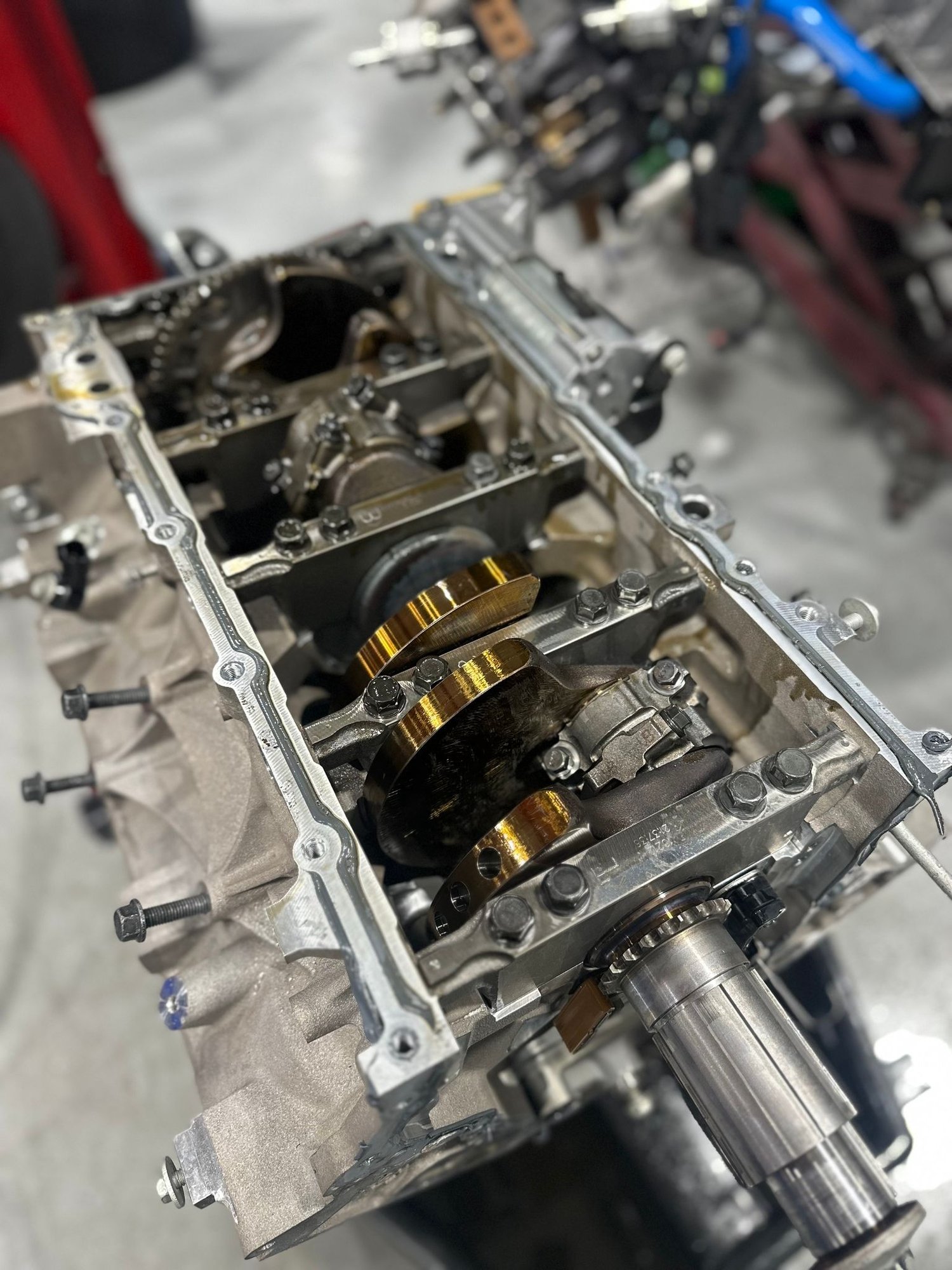

After a month of getting back and feeling out my car. Here it is. Vengeance Racing build. Last Oct. I lost my rear main seal at the track and immediately contacted my friend Andrew at VR to dive into this issue and why not take the time to just drop the motor and address a few factors and weak links. With the current developments it was good timing.

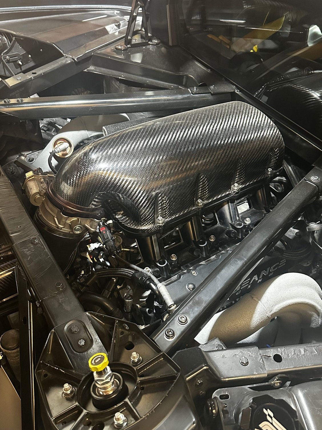

Here are the basic mods for this build. I have more details in my signature and other details is just to much to list but important also. You have to understand that heads, cam, and others is just basics. There’s many factors that were addressed and buttoned up that most don’t see beyond. Plus a few extra I added for a peace of mind.
-Vengeance Racing LT Valve Cover Package
-Vengeance Racing CNC Ported LT2 Cylinder Heads
-Vengeance Racing Cam Kit Plus With Stage 2 Cam
-LT2 Billet Camshaft Gear
-VR Spec Vibrant Catch Can
-DSX E85 Flex Fuel Sensor Kit
-HP Tuners ECU Software
-ECU Calibration via Elite Tuned
In my own words from the knowledge I gained from a few sources that shouldn’t be questioned. My rear seal failure was pretty much the cause from not running catch can for so long while tracking and GM’s design within the motor doesn’t allow it to breath efficiently upon constant acceleration and deceleration. We addressed this issue in a few ways and parts. If you have a short block built there’s another fix within that area also. Gone is the AFM garbage.
Yes having more power is always great. The tune in itself really makes this car so complete. I can’t say enough. So much more across the board. The acceleration across the whole range just pulls and never falls off. It’s as it almost had a different gear. I want others to drive just to feel. Forget about numbers, cost, and so on. It’s an absolute thrill to drive. No matter what traffic you’re in, it just performs. Just eliminating the low timing tables that were set in place. Car itself is officially at 3354 lbs with 3/4 tank.
Love that catch can. Well needed for track use and E85.
The rear bay will still be worked on for simplicity, appearance, and function. For it has absolutely no heat issues on any level with 40 minutes session. Wild as it may seem there was a lot that was thought out over time to get it where it’s at just to see what the next plan going to be. Will be adding a more direct cooler air intake made from 3D printer sourcing air other than the sides. For now the intake temps are great and consistent no matter what the heat soak is. Then will be summed up with a true tube frame in the rear with quick removal of all panels. You know, because race car.

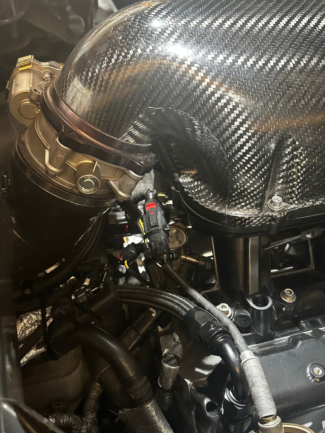

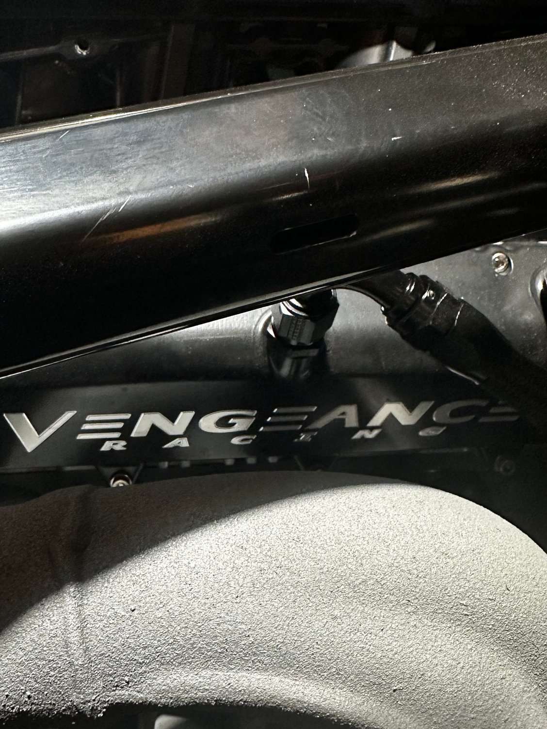

More Madness

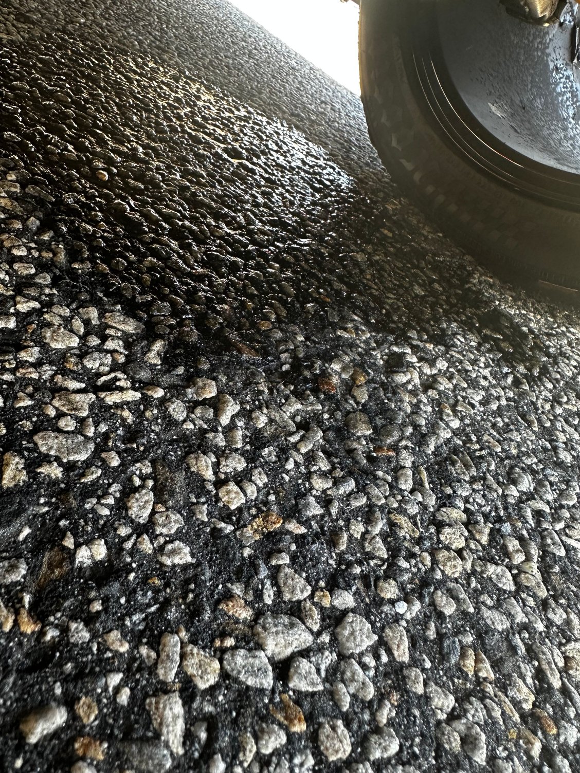

Leak. Glad it didn’t get on the tires that day.
Catch can drain. Top left of the pic is filter form EVAP delete.
