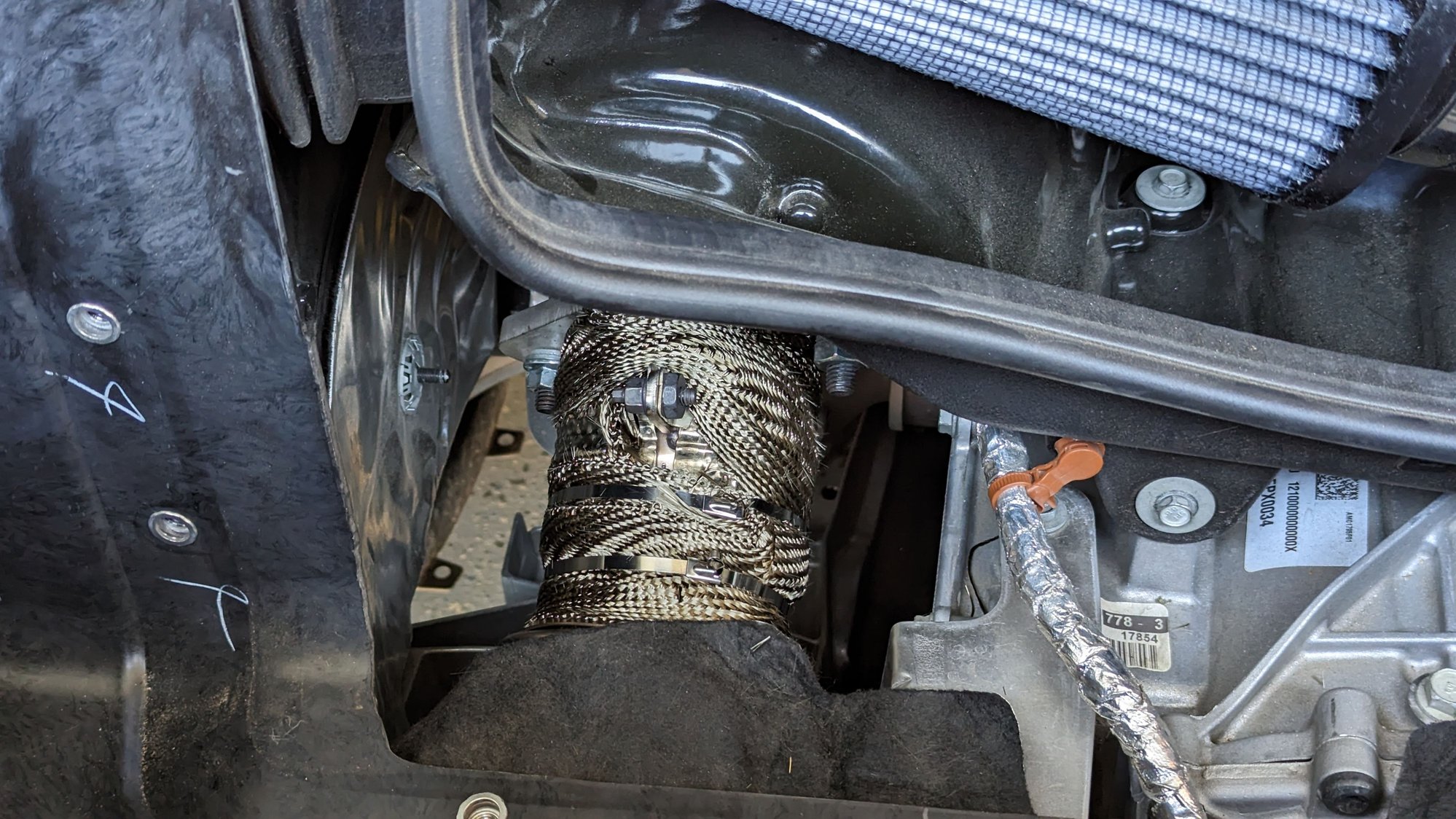

Wrap your exhaust pipes with header wrap.

I have not, but I did that just for the extra protection since I also have my headers and cats ceramic coated.

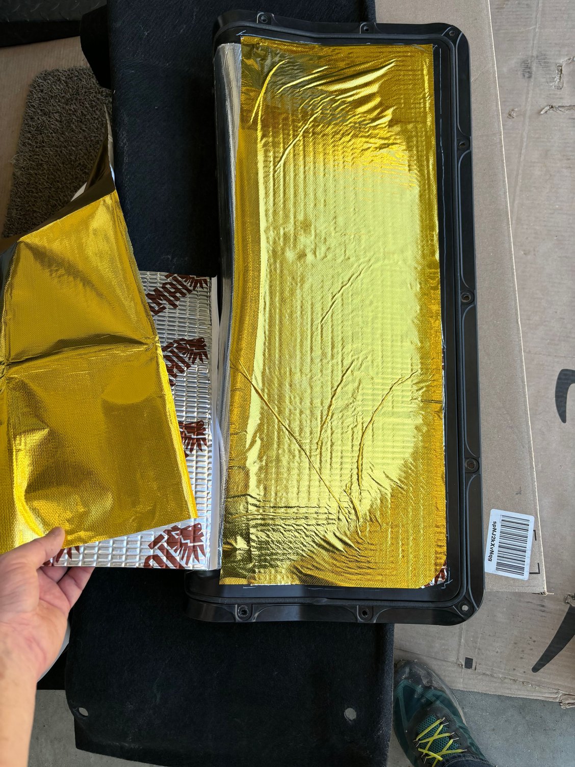

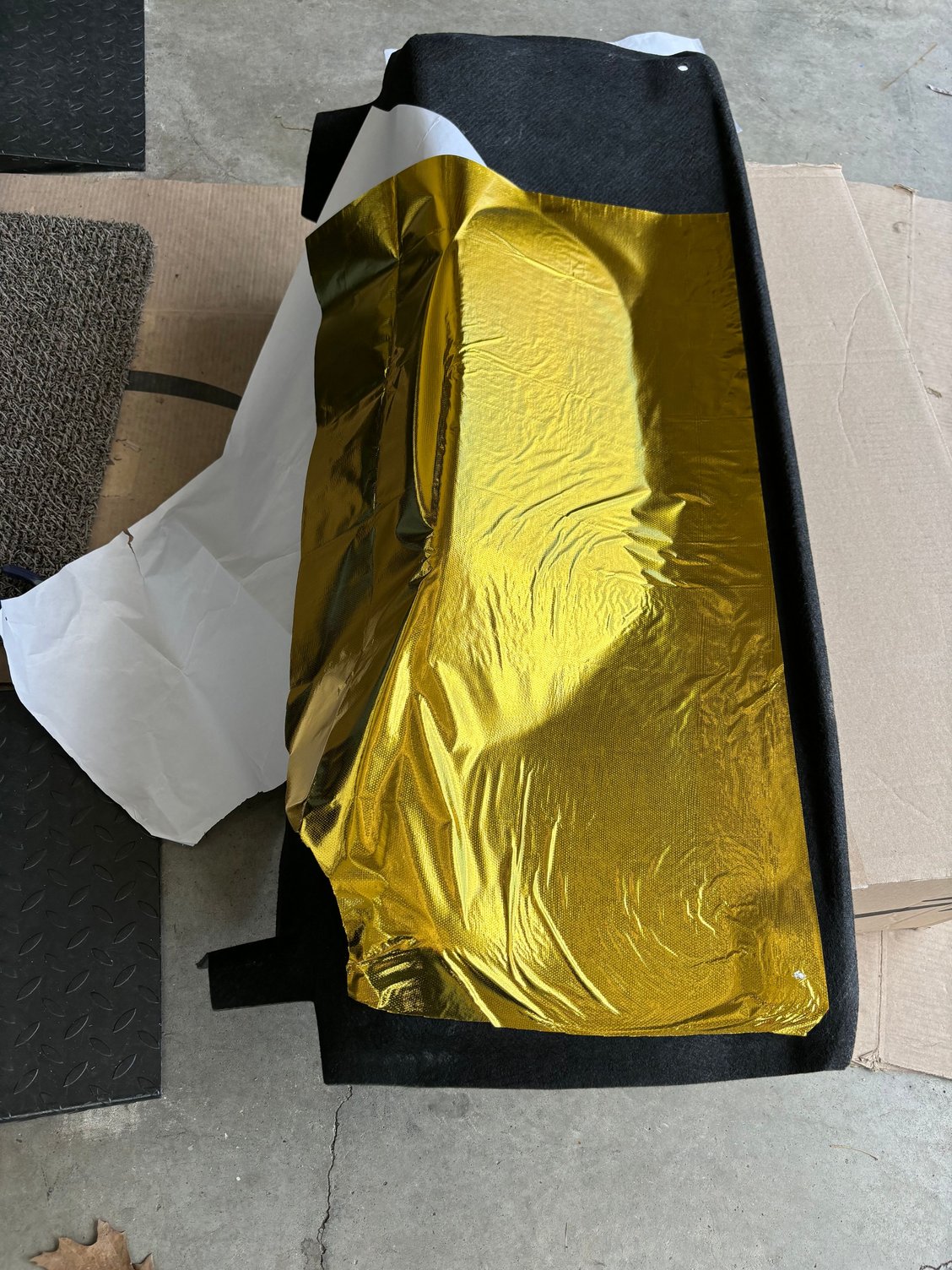

I used these two items.
(1). I put the KilMat on the back of the airbox panel,
(2). then the reflective gold sheeting on top of KilMat.. I covered ALL the KilMat with the reflective sheeting due to the KilMat only being rated to +212 degrees (321 degrees short term).
(3). After the air box panel I wrapped the back of the carpet with the reflective sheeting. WORKED GREAT, I drove it before and after and the trunk was slightly warmer than the outside temp.
$51 from Amazon.
BBTO Heat Reflective Sheet Adhesive
KilMat Car Sound Deadening Mat

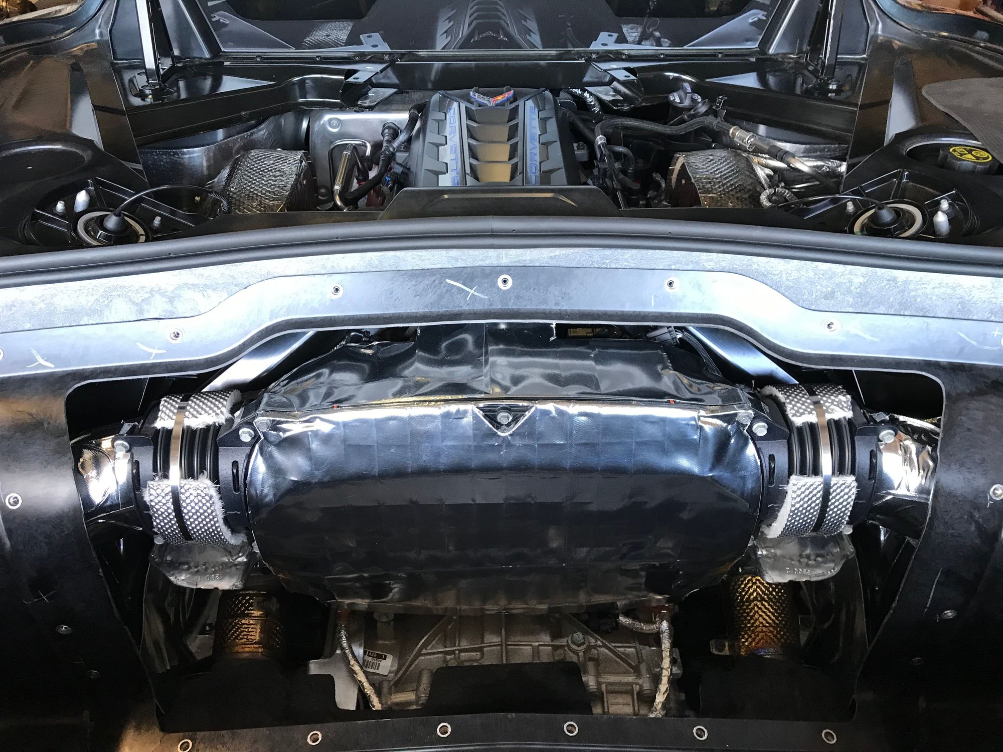

I put reflective film on the cover to the trunk and had a lot left over, so I covered the air box as well.

Nicely done! You went all out!

excellent Job! that's what I was looking for! You should have lower IAT's!

I figured it should help some!
