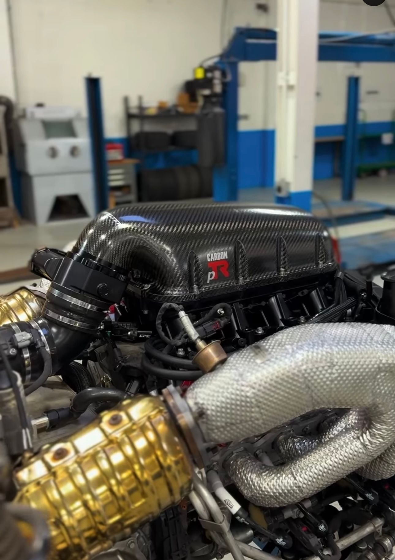

I have a Lingenfelter 95mm w/ PTE intake. I've had the TPS light many times. Only at the track. I'm sure its related to the multiple inputs over a span and the design. It was every other session oddly. LF told me they had ran into this with several cars they tracked also. They told me to flip the throttle body 180. I did and that solved that for a year.. Not sure the reasoning. But it started back after a heads cam build. But under the knife again and will be looking into a lot. Also not sure if the angle of the PTR intake neck is a possible consideration.

I haven't installed my pTR and TB yet (just the Eventuri intake), but I'll be watching intently for a CEL. Flipping the TB 180 alters the airflow (as would the angle of the silicone coupler, but the TB would tend to alter it more before it hit the manifold). Add in the shape of the manifold, the angle of the velocity stacks, etc., and you have a real bitch of an airflow simulation with increasing variables. Good to know flipping the TB is a solution, but it also seems like you're losing out on some of the benefit of the laminar airflow... you're counting on the velocity stacks to make up what you've lost at the TB.

We’re going to be looking into it a little during tuning. The video I saw of Lingenfelter’s new 427 looked to have a Nick Williams TB. It was solid black and billet. It was also turned 180° from OEM. What you’re saying seems just right. Who knows what other variables there may be.
