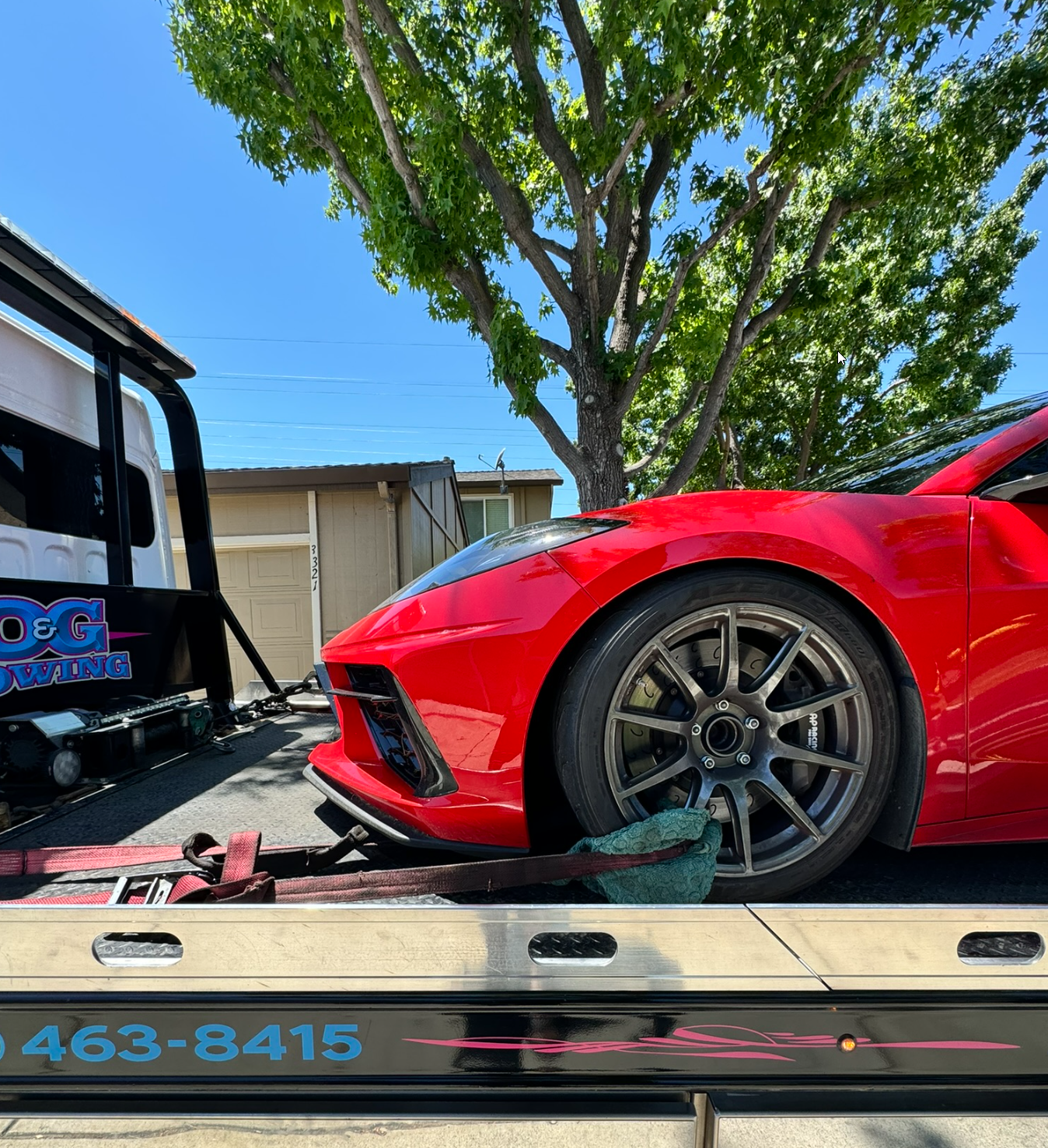

Update: Here we are, it's been 5 years since i needed a flatbed, well guess these things happen. On the other hand, it took 3 tow truck drivers (2 denied me as they won't tow because the c8 is a tantrum princess that needs special white glove service),
me disassembling the rear hatch, using a tool while the tow truck driver and i pushed the car onto the bed. Then doing the same thing in reverse at the dealer. Fun times. If you ever need a tow, you're &%$#@! Or you just gotta let them flatspot your tires.
Oh a little treat, was the 2nd tow truck driver left when i finally found a tool to put it in neutral, started moving the car then the parking brake automatically came on.
