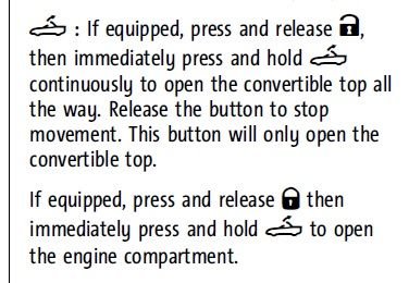

...everything said so far. Emphasize that the top button needs to be pressed and held continuously throughout the entire cycle. Also, the response is not immediate when you press the top button...a few seconds delay.
From '22 owner's manual
