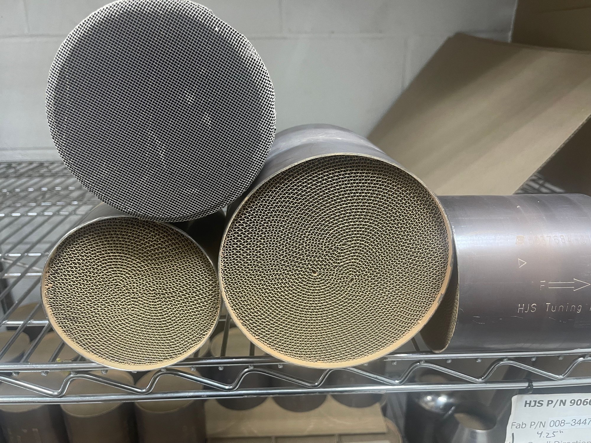

2. Cell count- 200 cell per inch , 200 CPSI, is the optimal cell count per inch for maximum power , durability and sports car sound. HJS trimetallic cats are heavily precious metal loaded with platinum,palladium and Rhodium and are anutobahn and racetrack endurance tested . HJS typically flows 90 to 92% of a straight pipe when sized correctly. OEM cats are typically 600 to 700+ cells per inch. WHY? Because the higher denser cell count per inch allows OEMs to develop a significantly cheaper catalytic converter and given the dense cell count and therefore much higher surface contact area for “catalytic action or scrubbing” significantly less precious metals is required for the wash coating. Rhodium ranges in price from $14,000 to $20K per Troy ounce. Gold is like copper versus Rhodium. Trimetallic noble heavy metal wash coating - Platinum , Palladium and Rhodium in heavy amounts bonded to the spiral metal foils of Emitec HJS cats.
3) Matrix or brick- ceramic cordite material and or stainless steel foil Inconel 625 foil brazed and crimped. Typically triwound spiral HJS foil HD catalytic converters are state of the art durable proven construction and flow a lot more than a ceramic core given the same size.

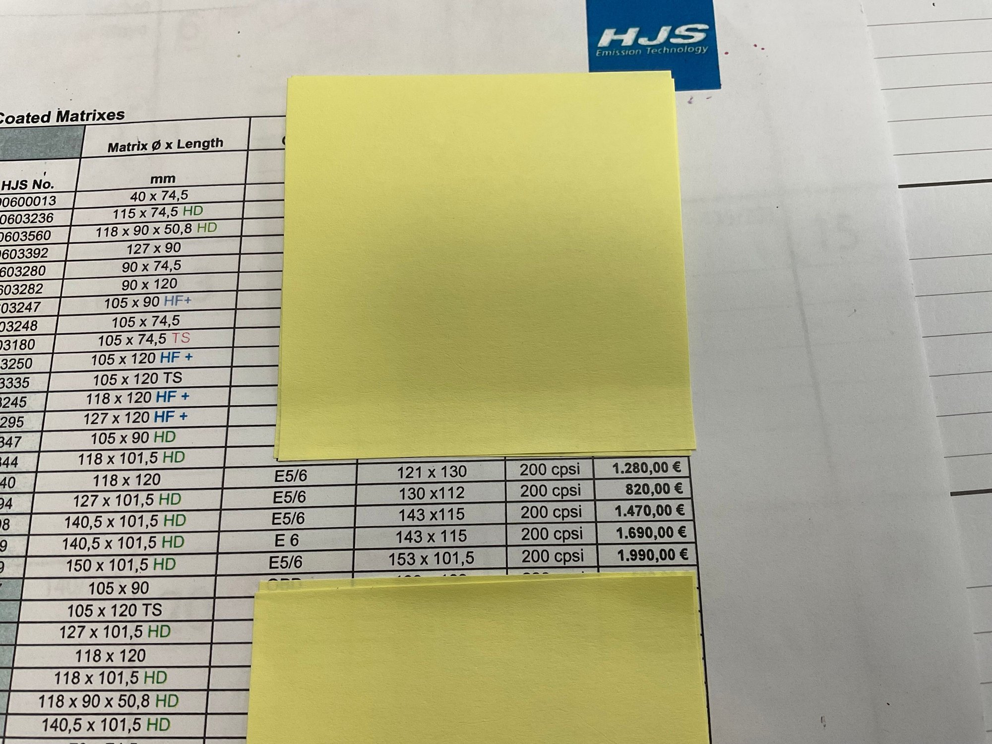

HJS Emitec prices Euros FOB Germany then add air shipping and US customs duty
Ceramic matrix top left versus Emitec HJS trimetallic genuine product

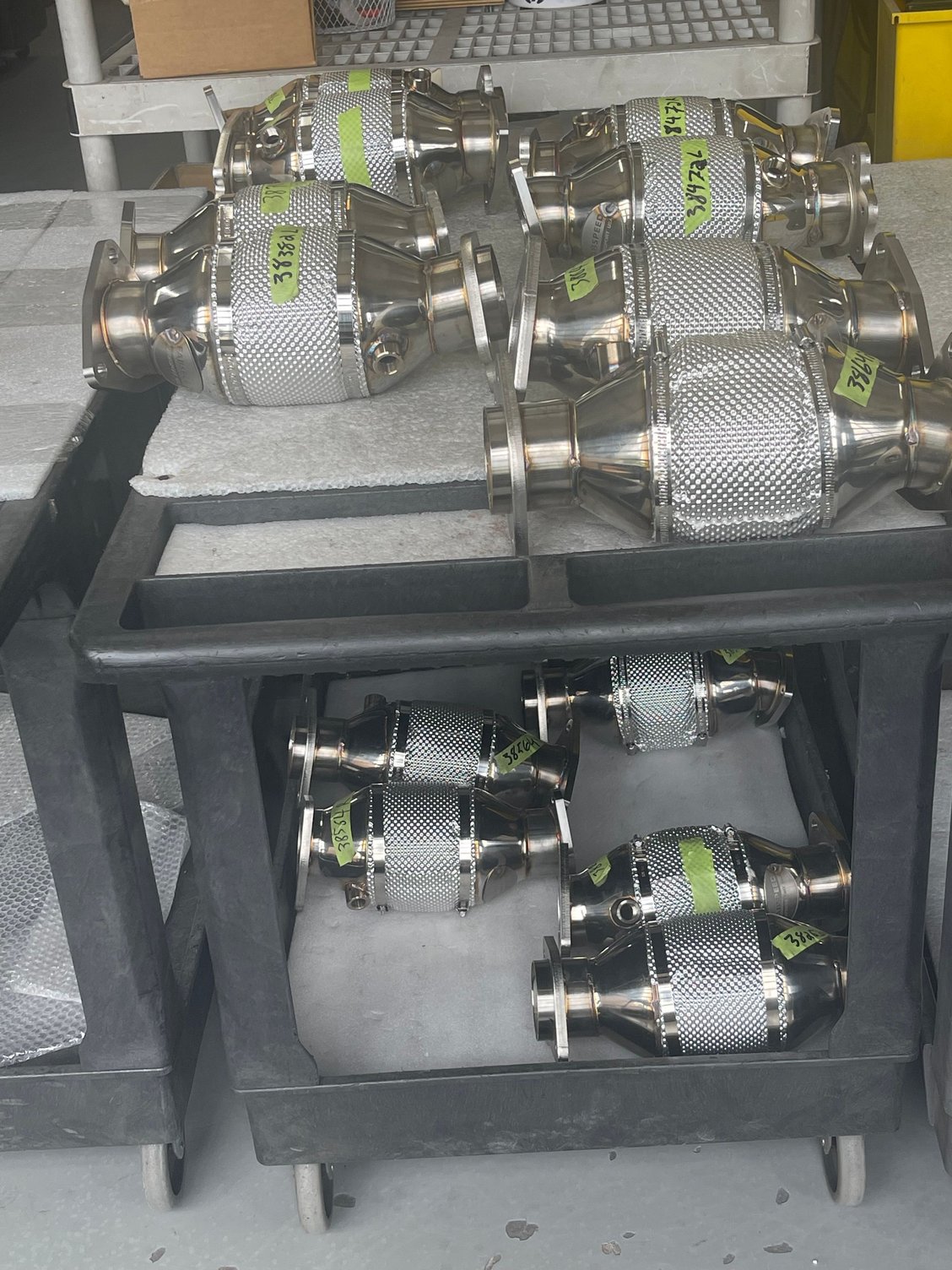

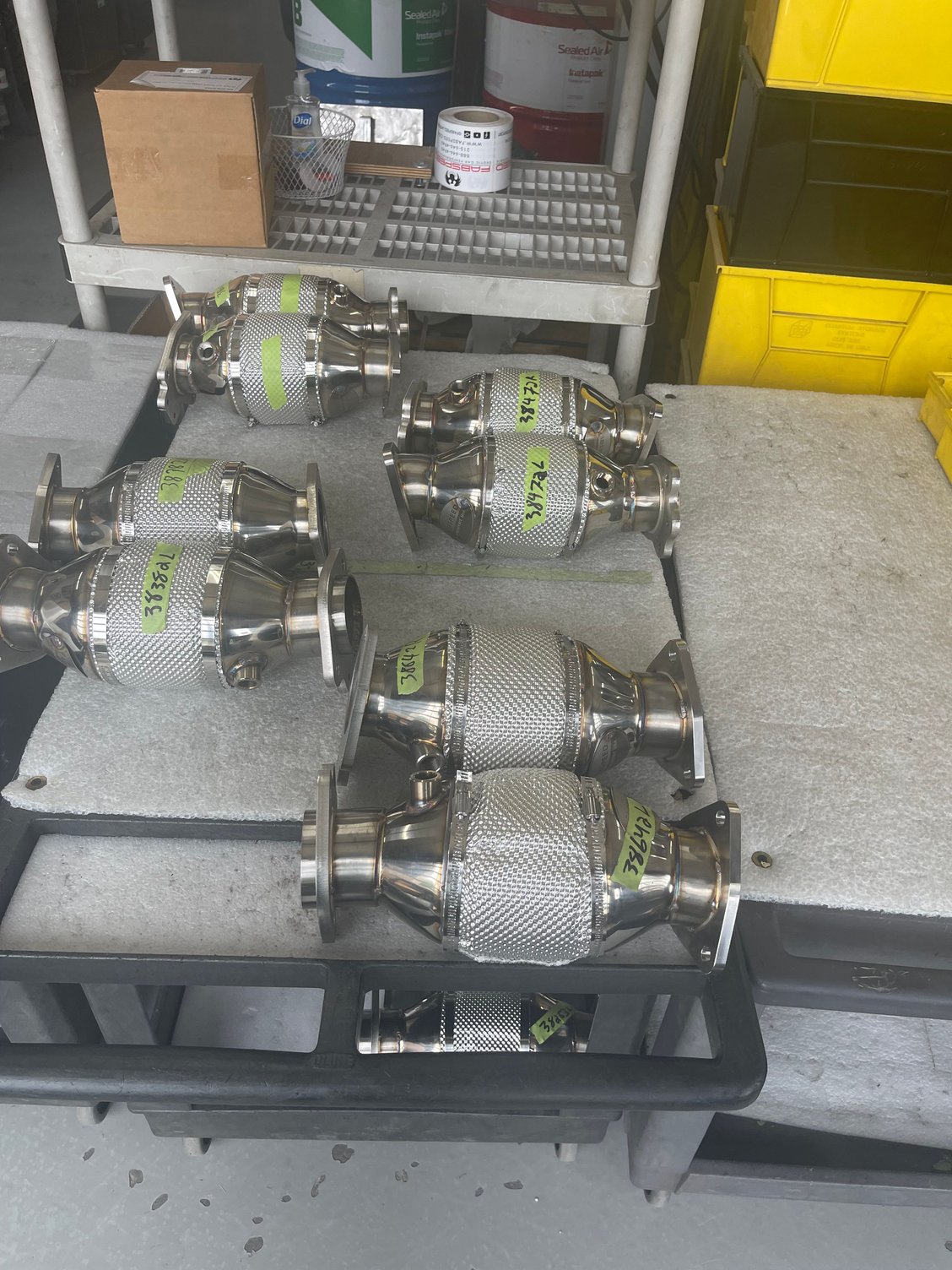

C8 and C8 Z06 Fabspeed production
HJS cats for C8 enthusiasts . 100% designed and manufactured atFabspeed. FLOW Waterjet cut and HAAS CNC machined flanges , HJS larger Euro 6 cores and laser welded .

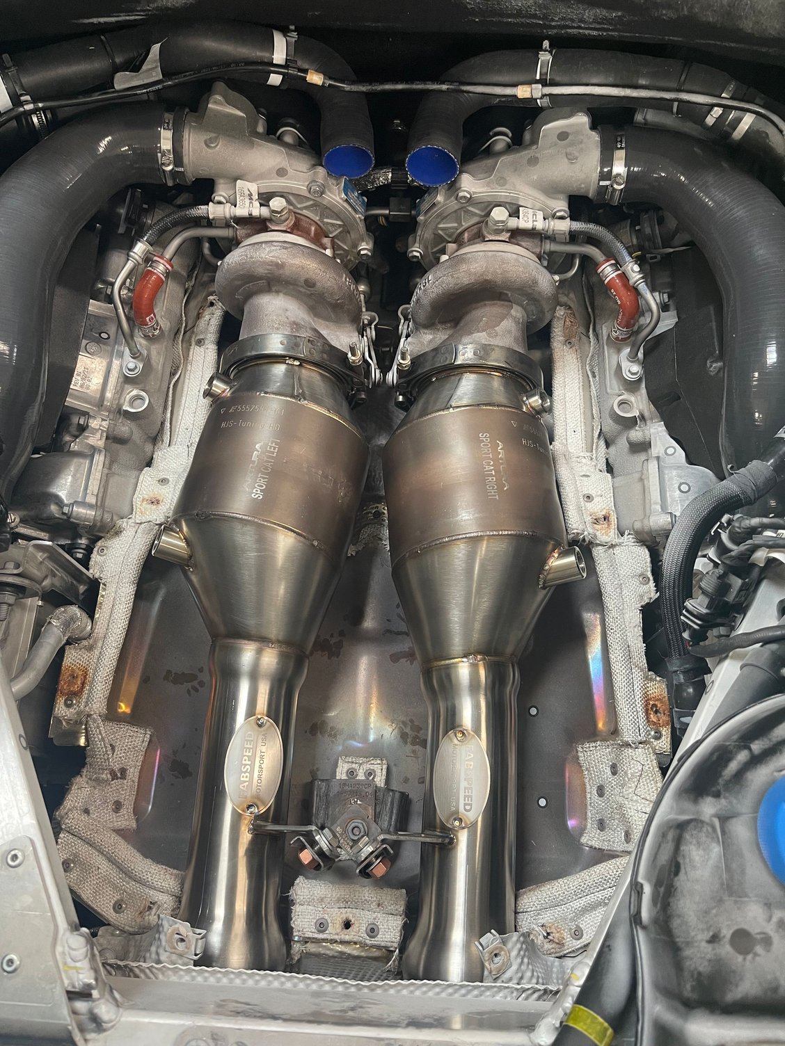

McLaren Artura V6 hybrid Twin Turbo- Worlds 1st HJS German cats equipped by Fabspeed Motorsport USA>
Genuine Emitec Tier 1 engineered German certified homolgated 200 CPSI racing high flow NO BULL performance components

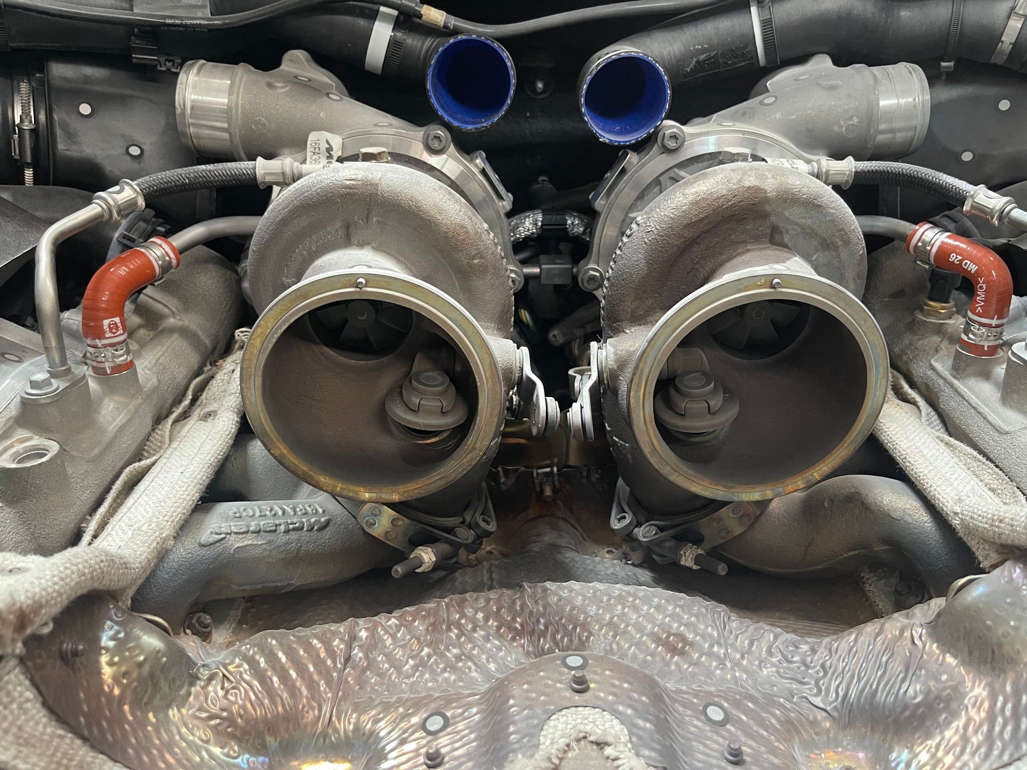

Artura Hot V twin turbos…….notice investment cast primary headers 3 pipes from cylinder head to V band on each turbo bottom inlet .

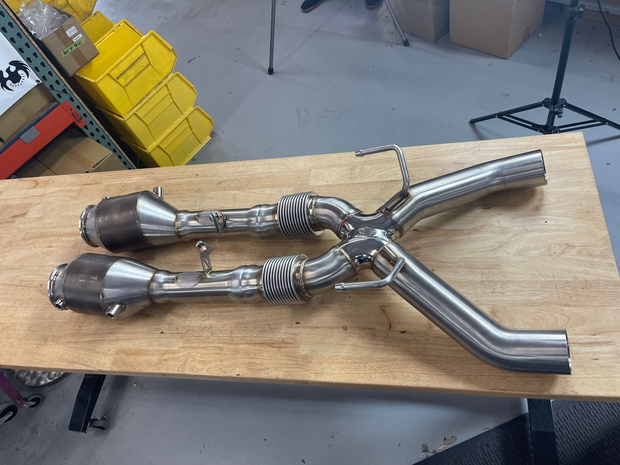

Worlds Very Finest and 1st Mclaren Artura Twin Turbo high flow cats and rear X pipe

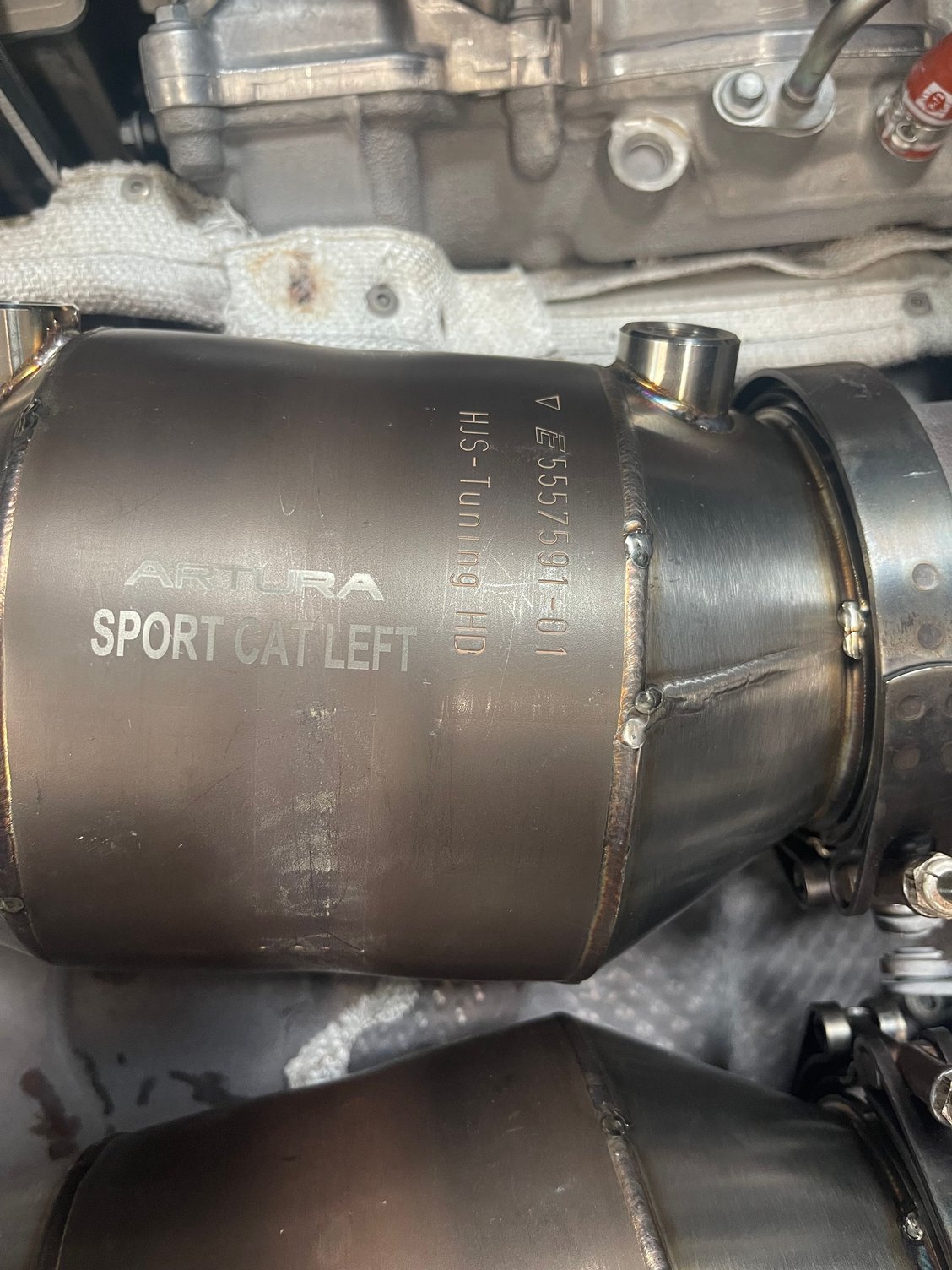

This 710HP stock tuned to 900+HP with HJS German racing cats and ECU bench flash. Exact HJS cats we use on C8 and C8 Z06- expensive IMSA, LeMans , WEC endurance racing German katalysators.
