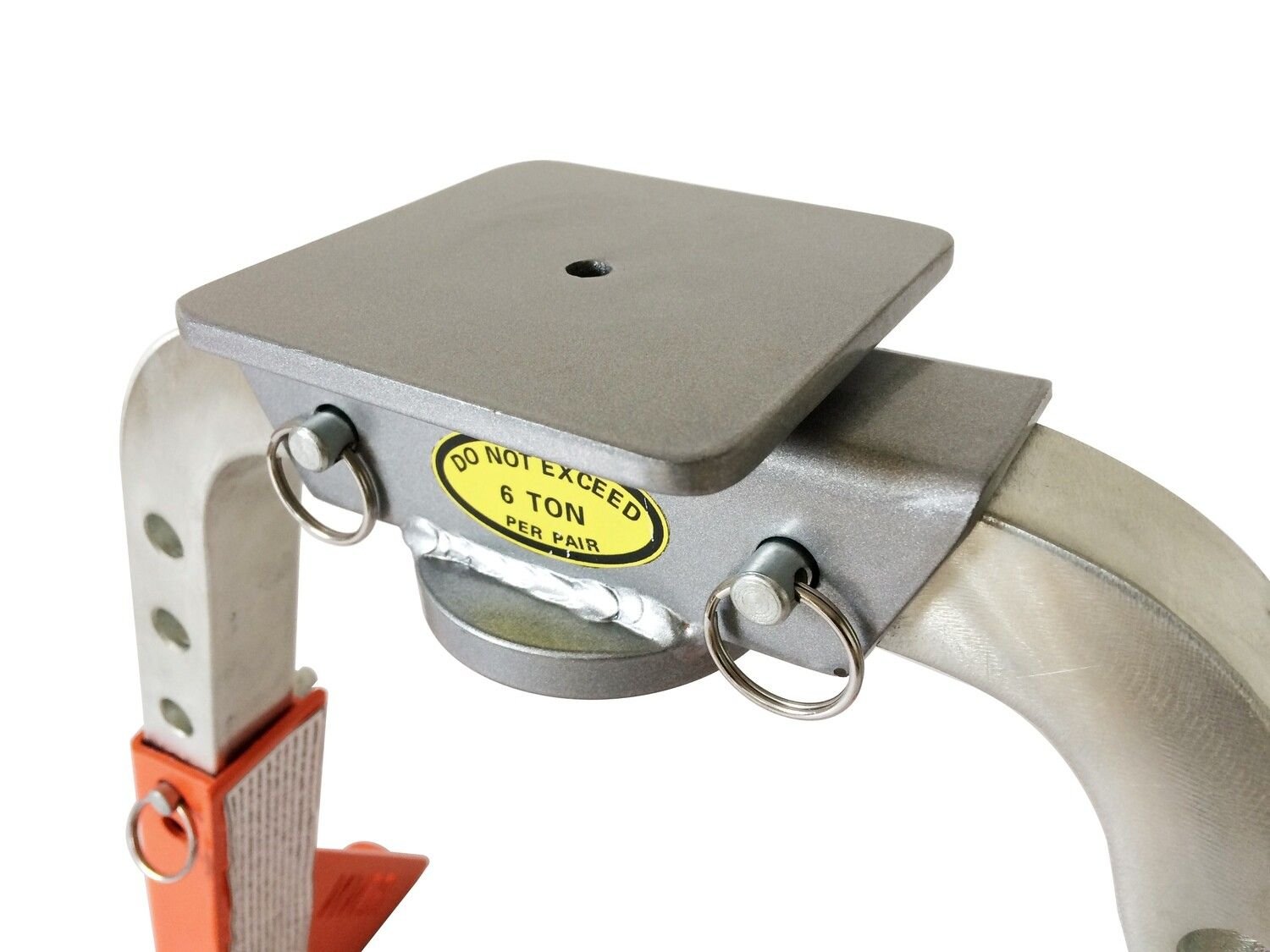

I got a set of Rennstands to take to the track with me to safely jack up the car with my race jack for changing wheels, checking brakes etc:
https://www.etamfg.com/shop.html?sto...ece-p252276669
I have jack pads installed on the car in the correct jack pad locations and the only Rennstand adapter that will work with those is just the flat plate:
https://www.etamfg.com/shop.html?sto...ces-p251403820
So I have four of those with the idea that I can jack up either the front or rear, or the entire car if necessary. However these are smooth and flat and powder coated, so I am wondering what is the best way to make sure they are stable on the stands since theoretically without any rubber pads on there like on the race jack, the car could slide sideways on the pads? For my M5 I have jack pads that go into the jack pad adapters and once jacked up there is no way the car can move at all as the pads are captured.
So what do folks do to hold the C8 in place on a set of Rennstands? Is there enough grip between my aluminum jacking pads installed on the frame of the car and the powder coated Rennstand plate, or should I consider getting some kind of rubber padding to put in between and provide some grip?

Perhaps a set of rubber pads like this on top of the jack stands?
Amazon Amazon
Or maybe I remove the jacking pucks and use rubber ones when using the Rennstands?
Amazon Amazon

The correct Rennstand to piece for "Corvette" has a peg in the middle to go into lifting puck hole.
Many interchangeable top pieces for different cars

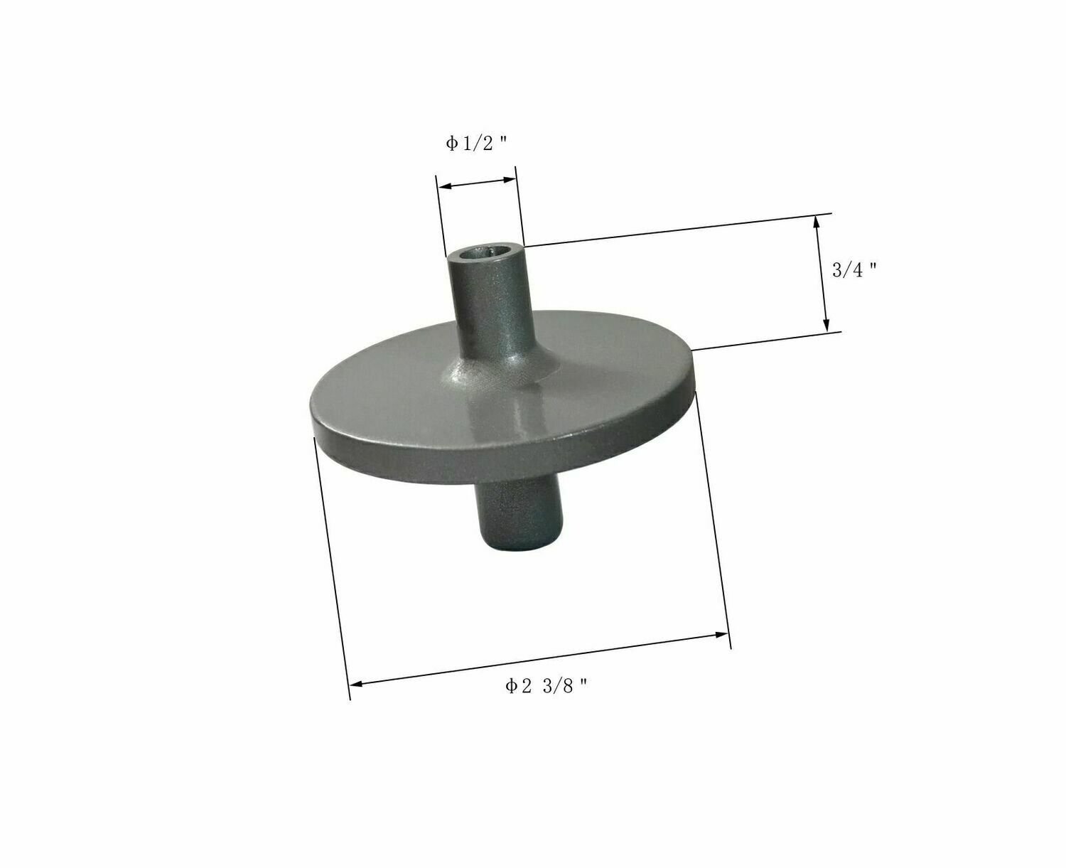

Doh, I totally missed that particular adapter when originally shopping on the site, but I see it now . I was looking for a square peg like the ones you get on the Paragon pucks, not the long pin that comes on these.
Now I need to decide if I keep the pucks installed or remove those and just get some basic slip in ones when I get my lift installed in the garage.
https://www.etamfg.com/shop.html?sto...ces-p255070124

The other option with the pucks installed on the vehicle would be these:
https://www.etamfg.com/shop.html?sto...ces-p251403769
The pucks are < 3" in diameter so that would also work to leave the puck there, and then nothing can slip. Hmm.
