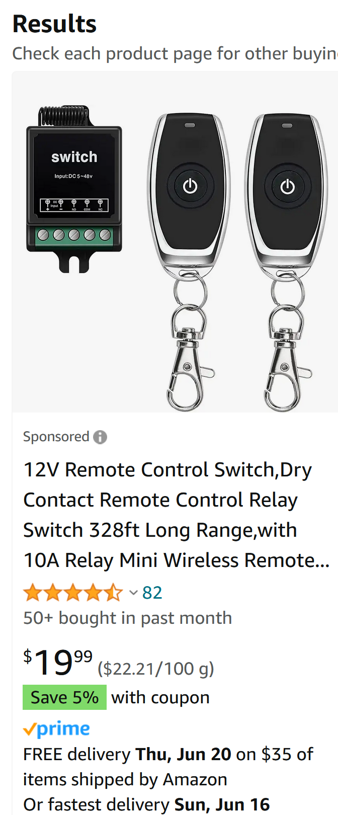

Originally Posted by Z06-1
Hello vette brothers I want to change the horn on my c8 to a fiaam trumpet horn . Anyone have the schematics or where can I find the schematics to change the horn out .TYIA
You have the option of installing them wherever you want, then use a remote control device. Little remote relays are pretty cheap. I doubt the trumpet will fit under the bumper.
That way you avoid any possible issue with DTC, or any potential warranty issue.

Thank you for the replies guys I'm gonna hook up a relay switch with a separate horn . That's the safest and easiest way
