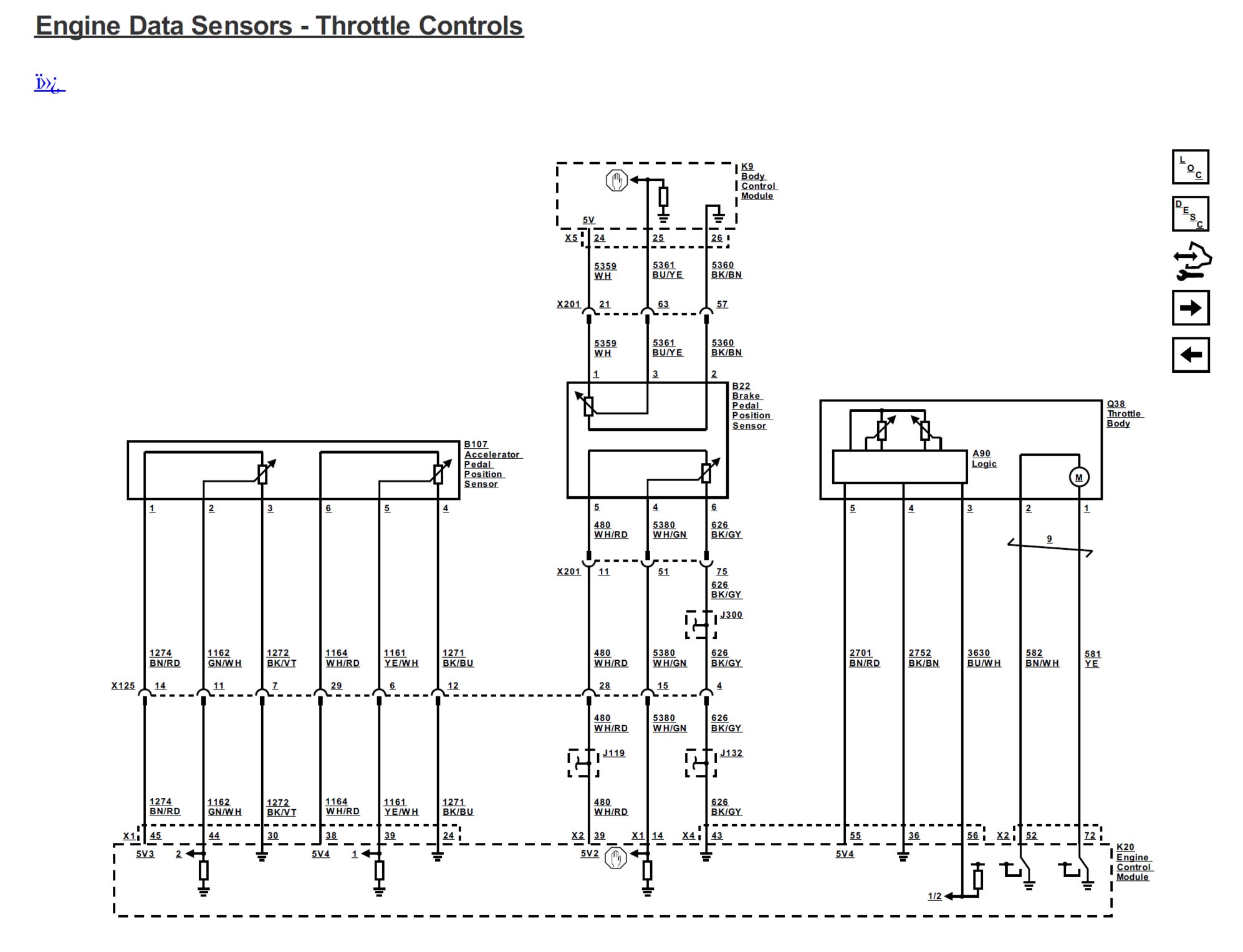

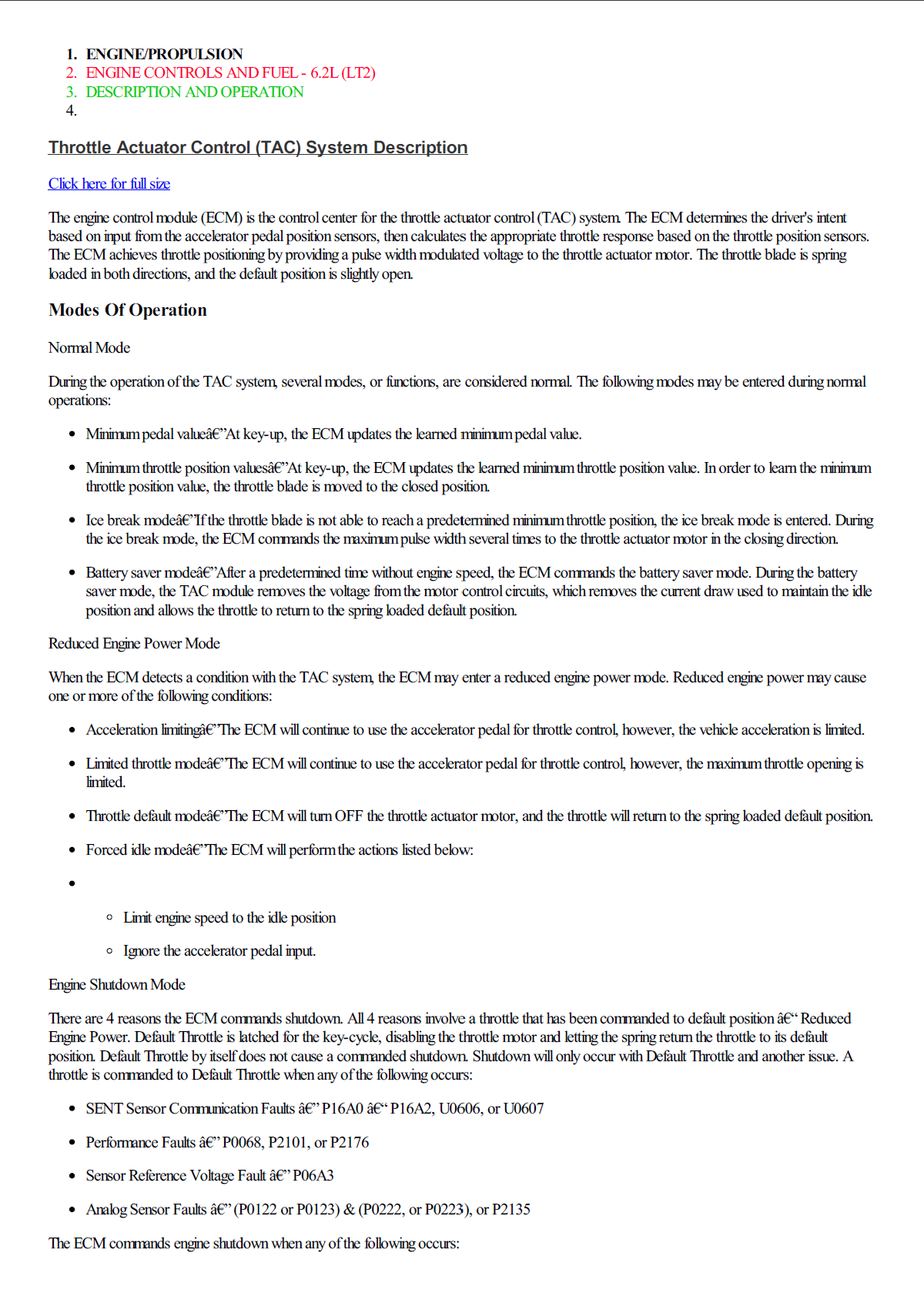

Here's some info on how the throttle control works. It's not going to help though. There should be a DTC set when the accelerator pedal angle or the requested power is not delivered. Looks like the pedal has redundant sensors too.
