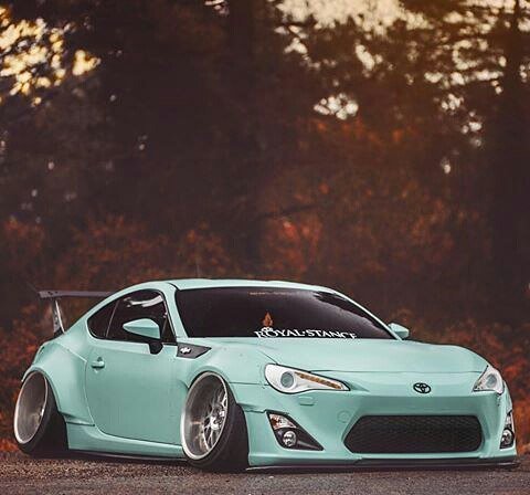

Negative camber absolutely wears the inside of tires more quickly than if there is no camber. Ever see one of those rice rocket Subaru BRZs, Hyundai Genesis Coupe, Nissan 370Z that has so much negative camber it looks broken? Next time you do, look at the inside of its tires, guaranteed they're knackered. That is obviously an extreme example but the principal holds.
🇹🇳 مُحَمد on X:

What's that sticker on the windscreen? "Royal Stank" ?
