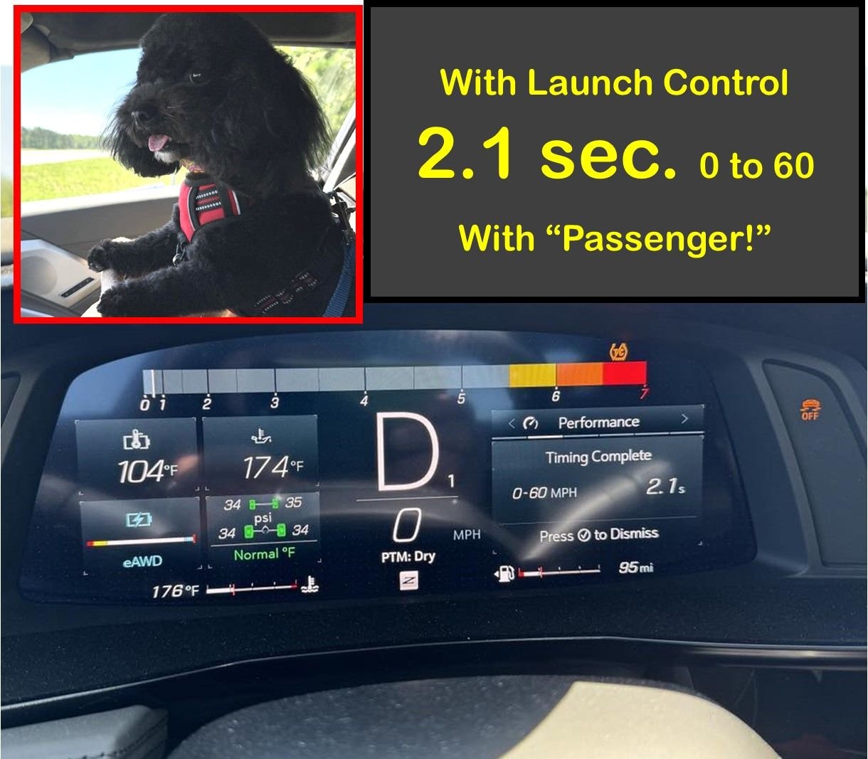

Originally Posted by BJ67
My simple method, start the car, leave it in park, dial in with the round dial to sport mode, reach up and click the traction control 2 times, you will get 2 yellow info icons, traction control off and ESC off. Put the car in drive, stand on the brake pedal and floor it.
This is what I do in my E-Ray. Z-Mode set to Track, PMT: Dry.
Can see my Z-Mode PMT: Dry setting and the Traction Control OFF Symbols. Press Z-Mode Button Twice and with left foot very firmly on Brake and WOT it goes to ~3500 rpm. Then lift left foot and "Hold On!"
Note to get that low # on GM Dash Test (GM subtracts dragstrip roll out like car mags, my guess ~0.2 seconds) I had:
  1. Battery at 100% charge NOT normal 80% by driving for >10 minutes in Z-Mode Power set to Track,
  2. Tire tread (all 4) heated, I do that when I turn onto my safe test street, farm fields both sides, no traffic start accelerating from ~10 mph @ WOT to 95+, applied brakes at ~0.8 "g,"
  3. Then Launch Control. Note perfect weather, low humidity and <1/4 tank. My passenger Remi' only weights 11 lbs - Loves Speed.
