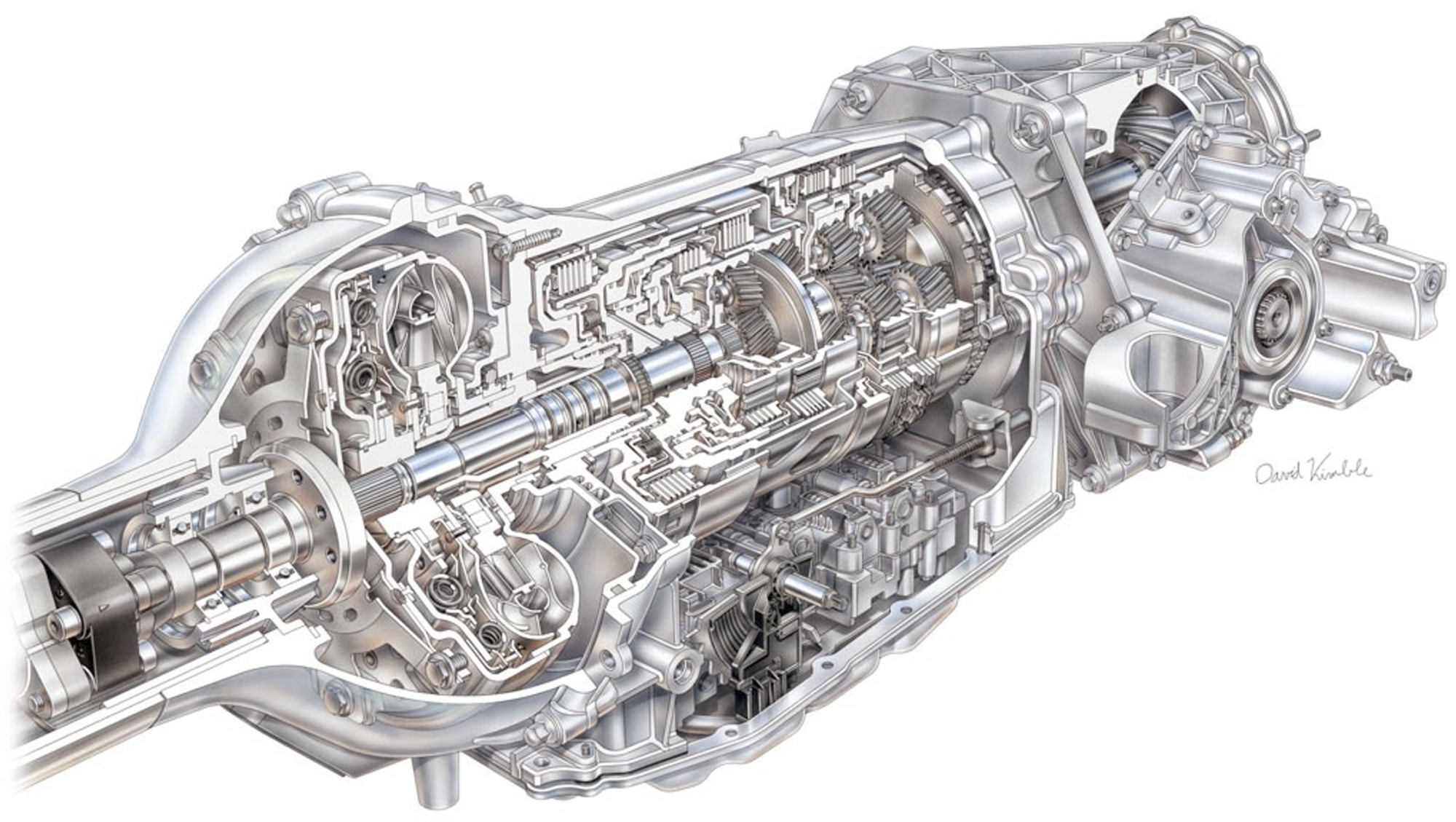

Here is a C7automatic cut away.

Just to further illustrate what I think is the complexity of the automatic transmission, I circled in green the torque converter, and what appear to be separate clutch packs, and in blue what think is a bunch of solenoid and hydraulic control valves in the bottom of the unit.

Yep, typical of many gear automatic transmissions. For some, each gear has a clutch pack that locks a carrier with Sun and Planetary gears. Valve body is complex with many small passages and ball bearing check valves etc. The 3 speed HD TH400 that was used in muscle cars is what I have in my street rod. With HD parts they can handle ~1000 hp. I modified the valve body with a kit to make it 100% manual, no automatic shifting. Key was removing some of those ball bearing check valves! Later put it back as tough on the 3rd gear clutch pack if you take off in 3rd!
