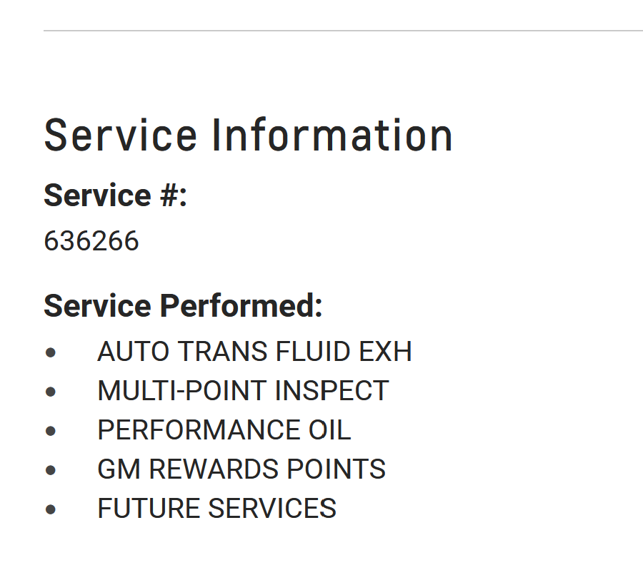

Attached is how my first service visit was recorded at 1 year and about 2500 miles. I opted to use the free service and the filter was change, along with the engine oil and filter. The invoice may show more detail, and the dealer may have access to that - I do not know. I have not yet acquired 7500 miles so I have not yet had the filter changed again. But at two years I did have the oil changed, and at three years I had the transmission fluid changed. I attached how that shows up in the record as well.
