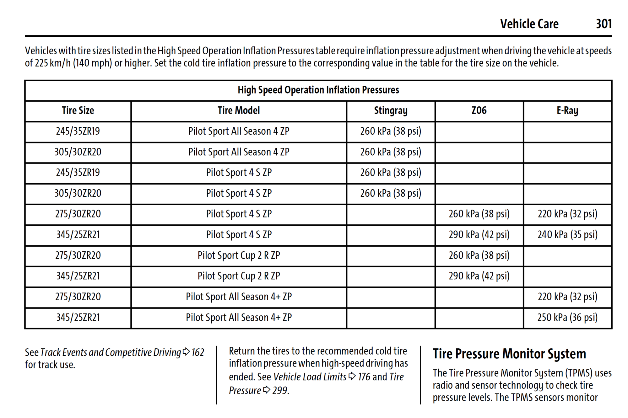

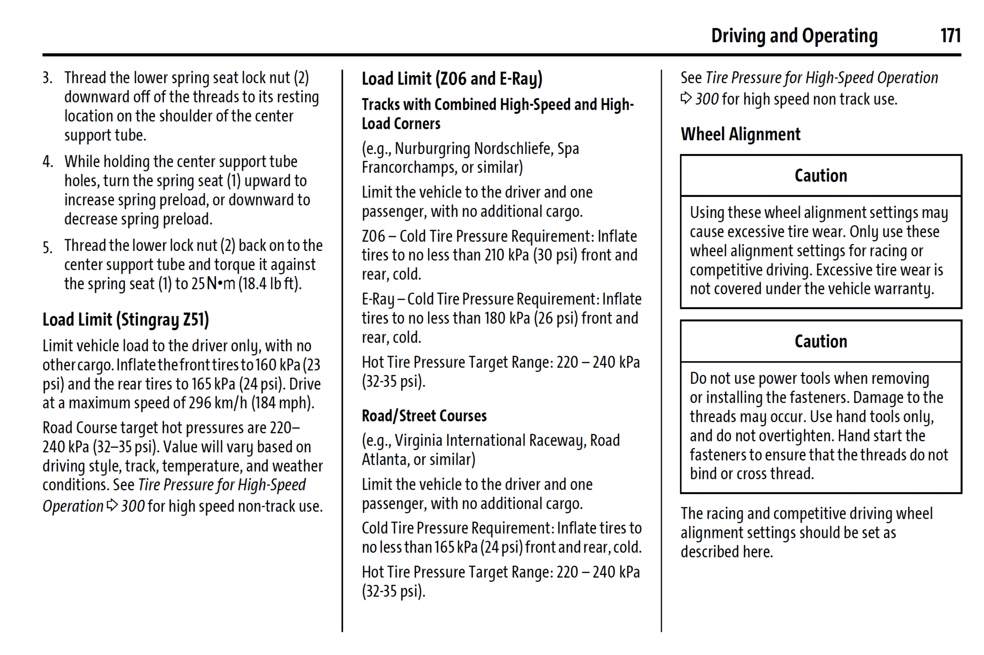

Don't know if you are kidding or not, but there is a separate track preparation guide, but most of that (maybe all of it?) now appears in the Owner's Manuals in a section called Track Events and Competitive Driving. Part of the includes some suggested tire pressures. There is a distinction made for tire pressures between tracking with lots of curves and braking, vs sustained high speed driving (which suggests higher pressures).

Good. Z06s never need the extra 2 liter track fill. And, 2024 Stingrays don't either. But the other track prep stuff in the Owner's Manual is worth a read. Here are links to the Performance Manaul and the Track Prep Guide for 2024.
https://contentdelivery.ext.gm.com/b...84948182_A.pdf
https://contentdelivery.ext.gm.com/b...uide_Final.pdf
