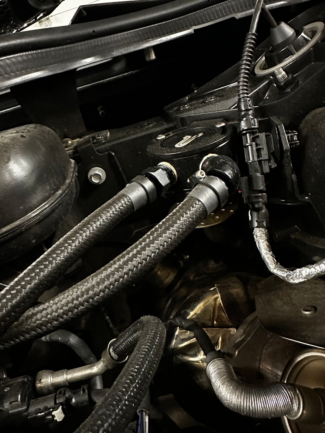

Default Found the vacuum leak!
A shout out to @ParagonPerf-Graham for the excellent customer service in handling something for which they were not responsible.
It also now makes more sense for the day that I saw smoke coming out of the hatch vent. It was the oil from the can that fell and covered the exhaust with pipe with oil.
I sent this message to Paragon and they have overnighted a replacement piece for the catch can.
