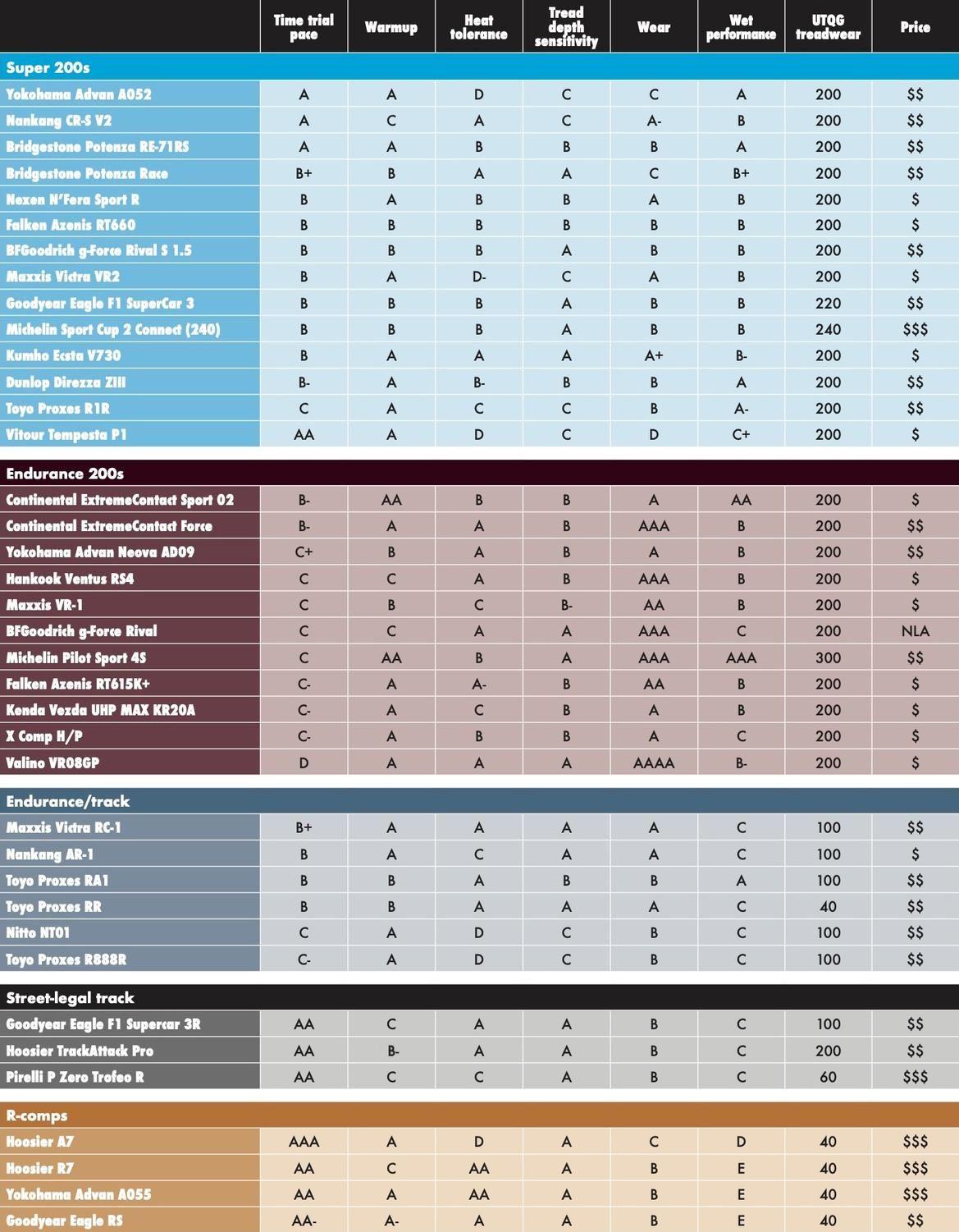

Originally Posted by rlhammon
One of the huge benefits of the Vitour is that it *doesn't* overheat and get greasy. Lap times have shown this over and over. The North American representative (Dallas Reed) runs both a C8 Z06 and Eray on these tirees and has reported time and time again how they perform better than the Yoks' when it comes to heat. Wondering where you got your impression otherwise.
I was referring to the GRM review of the tire: https://grassrootsmotorsports.com/ar...-buyers-guide/
One of the quickest 200tw tires we've ever tested, the Tempesta P1 is quick to turn on–one hard lap, in our case–and drives like a a typical R-comp, offering abundant grip, an eagerness to dive into corners and progressive breakaway and recovery. Heat soak sets in farily quickly though, causing grip loss that only increases as the tire is pushed.
GRMs tire comparison table as of October 24.
GRM's tire comparison table as of October '24.

There are discussions from the Vitour camp that the tire has changed since the early tires that Andy got for testing with GRM. He has another test coming up soon and I'm sure the article will show up on GRM very quickly afterwards. Will be interesting to see if the results change.
