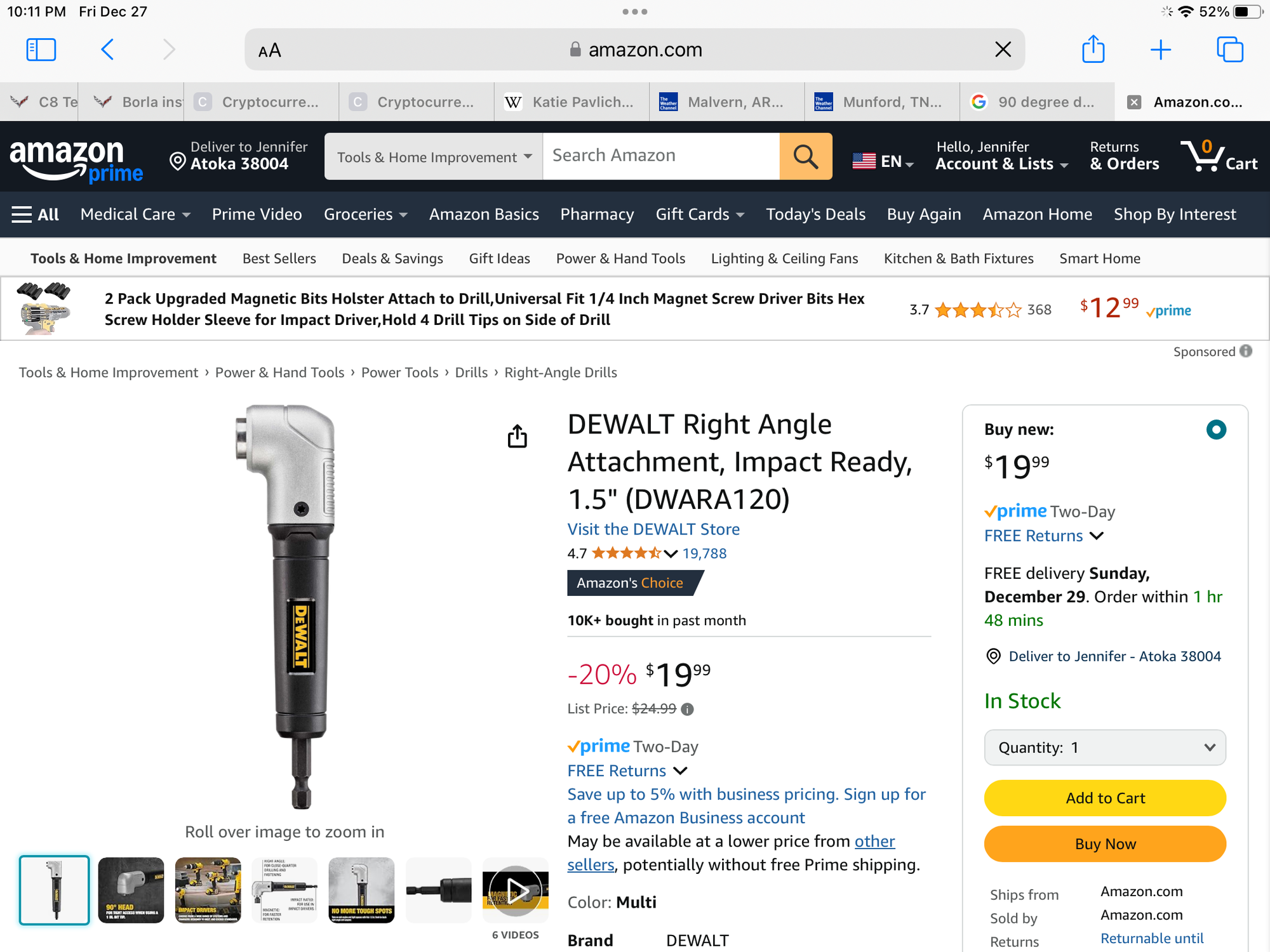

I have found a tool that helps with the 10mm nut. I can do both sides in seconds and I use a 1/4 inch drive ratchet with a 1/4 inch socket and long extension to drive it. Put a driver bit and 10mm on the other end…
Amazon Amazon
Old Dec 27, 2024 | 11:49 PM
