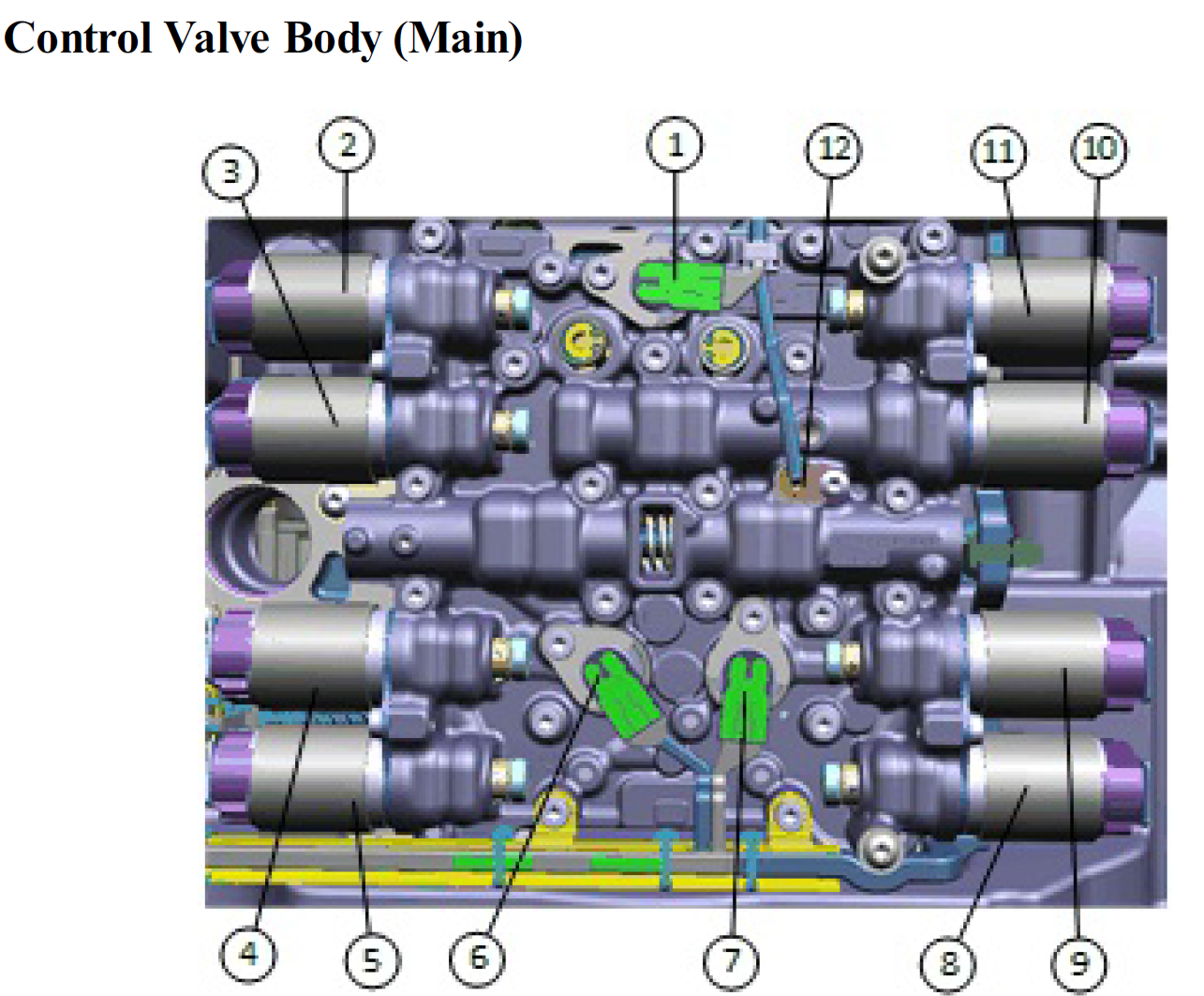

@RKCRLR mentioned the complexity of the valve bodies. Here is bit of info with illustrations of that. There are two valve bodies. Besides the actual castings with all the plumbing, the valve bodies are populated with Transmission Control Solenoid Valves, Transmission Fluid Pressure Sensors, and in one case a Transmission Fluid Temperature Sensors. Illustrations of those are attached. The Main Valve Body in the non Z car has 2 pressure sensors, 6 control solenoids, and 1 temperature sensor. With the Z, which adds the eLSD, there are 3 pressure sensors, 8 control solenoids, and 1 temperature sensor. The Shift Activation Valve Body has 6 control valves and 1 pressure sensor. Thats a total of 14 control valves, 4 pressure sensors, and 1 temperature sensor. That information comes from list of components in each valve body, and not from looking at the pictures. There are other controls and sensors that are not in the valve bodies as well. And the valves themselves are controlling hydraulic actuators that move the clutches, the shift forks, eLSD clutches, park lock pawl, and likely more stuff I don't know about.
Plenty of failure modes.
