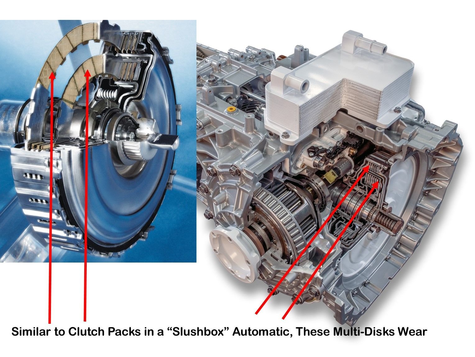

Yep I don’t recall that clutch plate wear statement but adding to my speculation of cause:
  • I felt the somewhat jerky motion when I crawled into my garage at ~2 mph for the 1st ~1000 miles was probably caused by the multi plate 1st gear clutch watering off high spots. That went away after ~1000 miles.
  • Was my thought possibly why folks in 2020/2021 with early DCT CELs and GM Service telling dealer techs just do a flush. No DCT filter change no new fluid, just a Flush. Most reported CEL gone and did not return
  • One reason I took advantage of GMs free offer to have DCT filter change with flush prior at year 1 with ~3000 miles
  • As I recall Porsche DCT (and others) have separate fluid source for the clutches.
Just more speculation BUT FITS!
  • Could they have improved the clutch material in recent years as:
  • i did not have Jerky feeling in my 2024 E-Ray initially
  • Don't see the early CELs where it goes away with Flush!

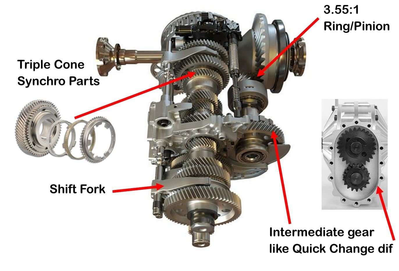

If you look at all DCT replacements on the Forum none show failures of clutches, gears, synchro's etc. Since the gears, synchro's are the same in the Z06 higher hp engine as the standard C8 (and E-Ray LT2) doubt it's a gear/clutch etc, issue. If you watch the video by a GM tech who worked on 50 with CELs (my post #19,) appears to me mostly minor issues with solenoid valves or passages clogging or possibly failure of the very many sensors that assure shift forks are in the proper position before one clutch disengages and the other engages. We don't know as Tremec who is the one investigating replaced DCTs has not said. Why should they! Other than the hydraulic actuators and the many sensors, it's similar to the 7 speed Tremec standard transmissions I had in my two C7s and the 6 speed Tremec in my C6! They were rock solid.
PS: Tremec has been known for building very durable standard transmissions for trucks and cars. In 2010 they acquired the high-tech automotive design and development organization HOERBIGER Drivetrain Mechatronics located in Belgium. HOERBIGER products and software solutions are found in leading European sports cars, including Ferrari Italia 485, AMG SLS and McLaren MP4-12C.
The C8 DCT is basically two 4 speed standard transmissions but instead of a manual lever moving the shift folks there are hydraulic actuators computer controlled.
The issue I raised with the 1st gear clutch had to do with possible break-in wear of high spots on the multiplate clutch plates. As I said, after ~1000 miles it was smooth at slow (<4 mph) speeds when it must slip. Unlike some other DCTs that have a separate clutch reservoir section and probably pump, the Tremec system uses the same fluid for all systems. Expect clutch plate wear is higher than any gear, synchro wear. It could clog solenoids, passages etc. Only Tremec knows! When warranty is up (many are now or close) I suspect trans repair folks will find and fix the issues.

I treated mt c8 like a motorcycle with a wet clutch. Changed filter multiple times. Here is what I seen. Took filter apart each time.
400 miles,easy break in/driving- filter stuffed with particles ,pretty bad
1100 miles, a lot of material in filter- better but not great
2600 miles- cleaner but still dirty
5500 miles, very little debri,pretty clean
6600 miles- very clean
So, My opinion is the clutch material clogs the filter and hurts the valve body. My car was procharged at 2500 miles. It's run pretty hard and shifts very good with no issues.

In order to get past the filter, if that is what is happening, the clogged filter would need to go into bypass mode, allowing the debris to get into the lines and valves, right?
GM and or Tremec likely performed analysis similar to what you did, dissecting the filters at various mileages to see the filter loading. The fact that continued to accumulate all the way to 5500-6600 miles would explain GM's statement about a "7500 mile break-in period" for the transmission (that appears in the later manuals), and would also explain GMs insistence that the filter be changed between 7000-8000 miles, even if done earlier. After which the next change is 22,500 miles, so 15000 more, then every 22,500 miles after. So once the heavy break-in shedding is complete, the intervals can be progressively longer.
The fact that the filter is dirty does not, by itself, prove that it went into by-pass mode. There have been photos that show some debris on the filter housing lid - which could have been from filter bypass, or not. I wonder what the filter would look at the second scheduled change at 22,500 (after 15000 miles) and the third scheduled change at 22,500 miles. If it is going into bypass in the first 7,500 miles, its a mystery as to why GM did not detect that during their analysis and testing. If the theory is correct, maybe its because some cars are outliers and shed more debris than expected in the 7500 mile period.
