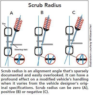

You'll need to worry about scrub radius if the offset of the wheel is changed. I haven't seen any specs on where the stock scrub radius is unfortunately. Maybe there is a way to measure without using special alignment tools.

On these cars, the shocks are pretty upright, almost perpendicular to the ground. I think the scrub radius is less of an issue due to this. I should also mention Z06/wide body cars also share this identical suspension geometry, and they employ wheels with offsets pushed about 25 mm outwards.

Shock position on double wishbone suspension systems has no effect on scrub radius.
