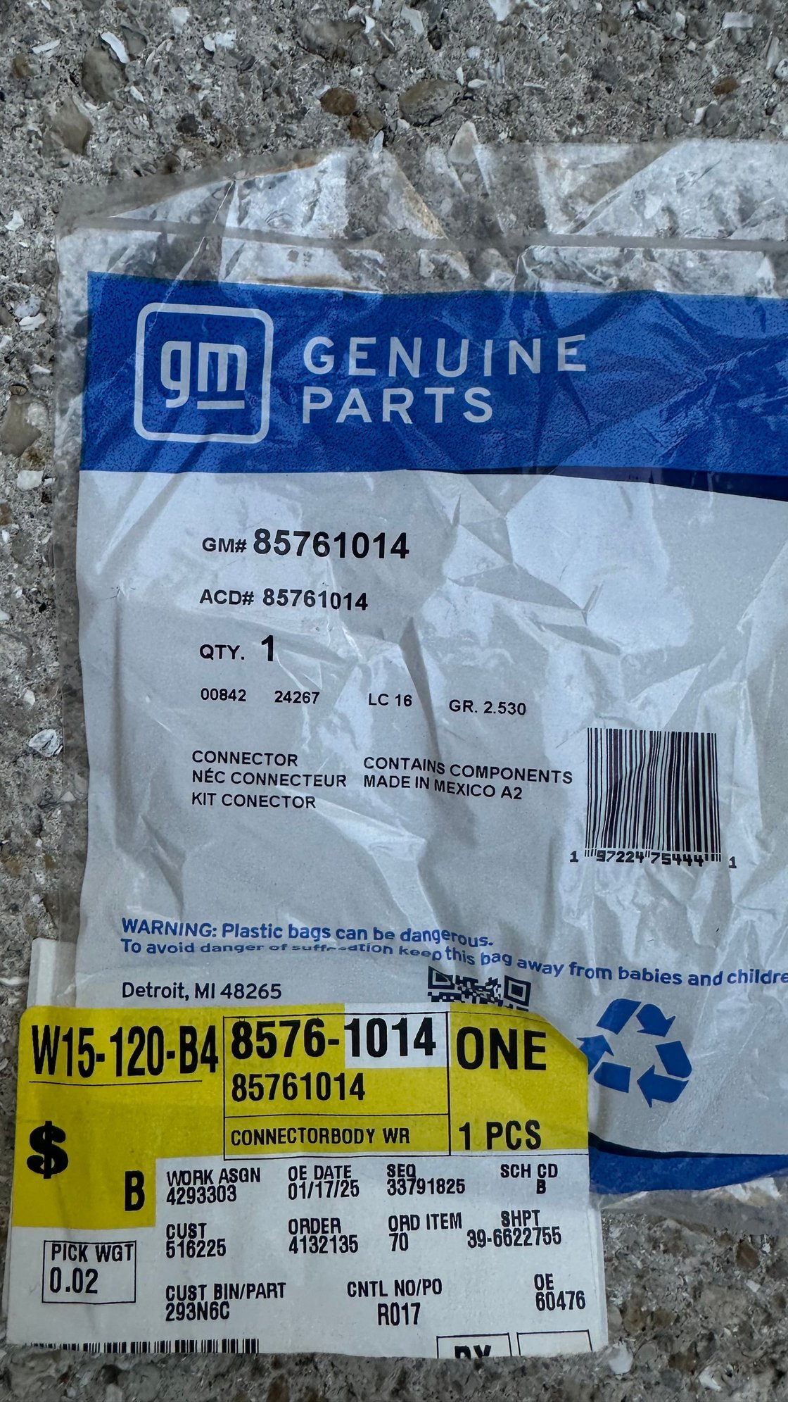

I also ordered a new sensor kit, cable, and battery module. I noticed that the sensor connector was slightly damaged, but I’m not sure if that’s the cause of the issue. I’ll keep you updated. Let me know if you have any other ideas.

This is the thin cable that connects to the negative battery sensor module - the inner part broke

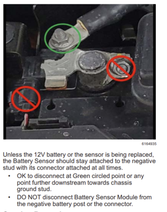

I also found this bulletin: https://static.nhtsa.gov/odi/tsbs/20...25711-0001.pdf

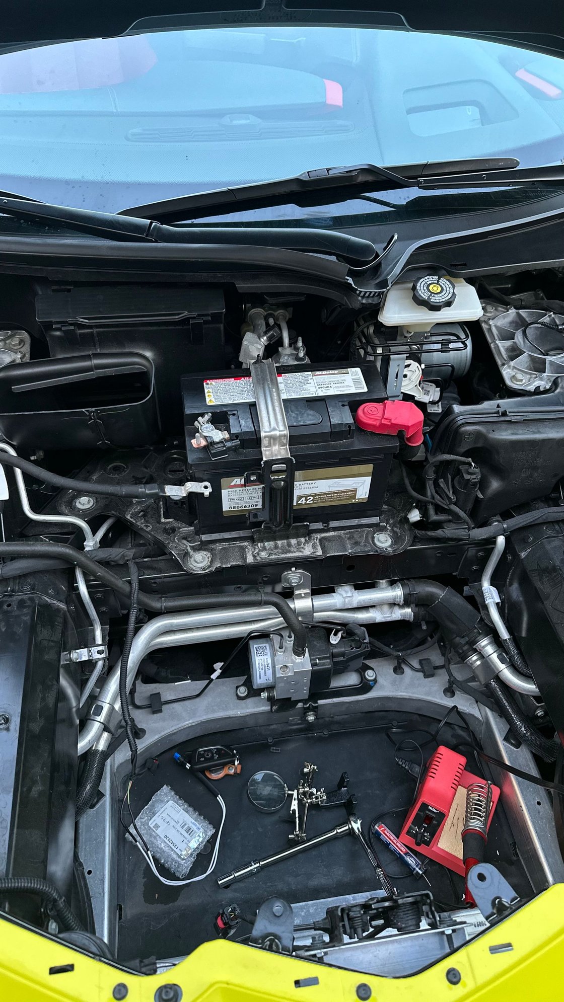

Update: My parts arrived today, and I was able to complete the job successfully. I cleared the error codes and ran another scan, and the check engine light is now off. Here are some pictures for reference in case you encounter a similar issue in the future.
Note: I had to perform some soldering using lead-free electronic solder, flux paste, and silicone paste for effective sealing. I also used heat shrink tubing to protect the connections and wrapped the cables in heat insulation with black electrical tape for added durability.
broken connector
broken connector
new connector part
new connector part
replaced sensor module as well
